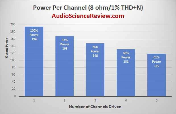

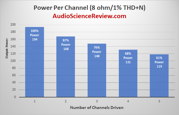

He had measured up to 5 channels on some unit but on the power amp outputs only. For preamp/dac of AVRs he always measured the two front channels but had also measure the center channel in one occasion, I might have missed he it was more than once.

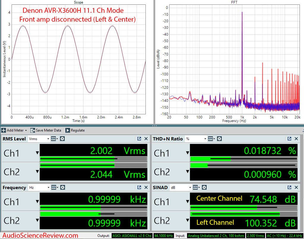

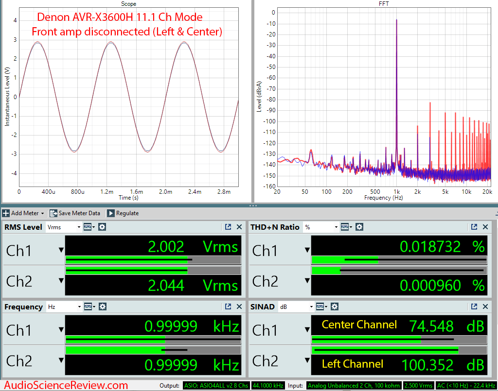

5 channel driven meaurement:
Center channel measurements:
Denon AVR-X3600H AV Receiver Review | Page 14 | Audio Science Review (ASR) Forum
The center channel's SINAD was lower because it was measured with the internal amps connected so at 2 V, the power amp would clip and the higher distortions/noise would polluted the preamp/dac output signal. The front left and right channel in that case were disconnected via the amp assign feature, but that feature can only be used to disconnect the front left and right channel internal power amps.
"As you see, Center channel without amp disconnect suffers a lot.
If you reduce the output to 1.4 volts, SINAD of the center channel improves to 97 dB
whereas the Left goes up to 103 dB. This is at volume position 79.5 dB (above is at 82.5). "
OMG, the Center Channel’s THD+N is about 0.02% at 2V. That’s absolutely atrocious and garbage. ;) :D
So this pretty much sort of proves that most companies (including Yamaha and DM) and most people mainly care about the main front Left and Right channels. And they care a lot less about the Center and Surround channels.

Multichannel measurements make more sense than multitonal measurements. I welcome Gene's 8 channel sweeps and would welcome Amir routinely measuring multichannel output on relevant devices.
