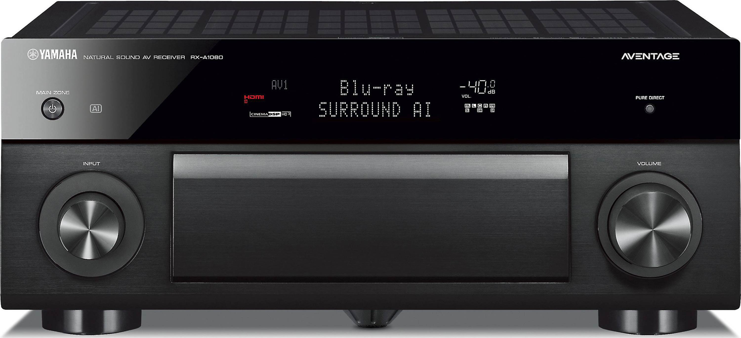

Congrats!
I'm getting 2 friends of mine (both are also pharmacists) the Yamaha RX-A1080 as well.
Make sure you set the Impedance setting in the Yamaha to 8 ohms regardless of your speakers' actual nominal impedance.
Also, hopefully you won't need any service since Yamaha is supposed to be among the most reliable, but Yamaha does offer free shipping BOTH ways for brand new and Refurbished AVRs.

I can't figure out where that setting is....
