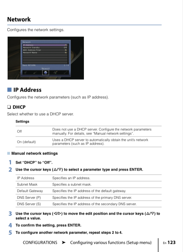

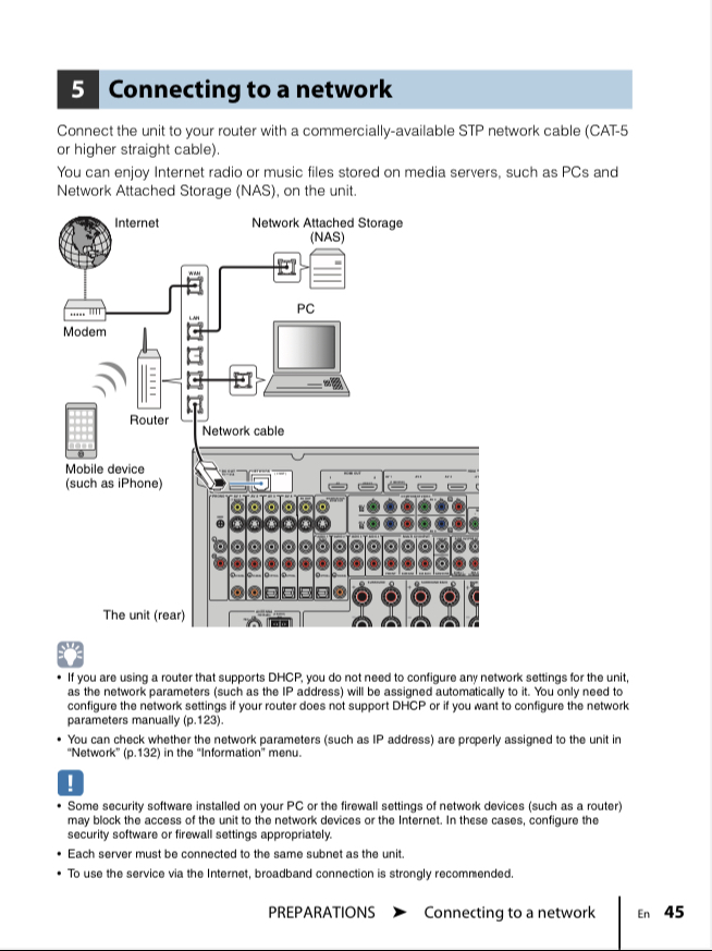

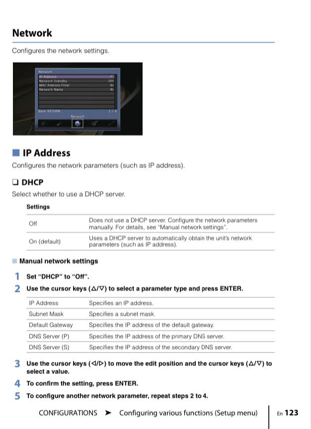

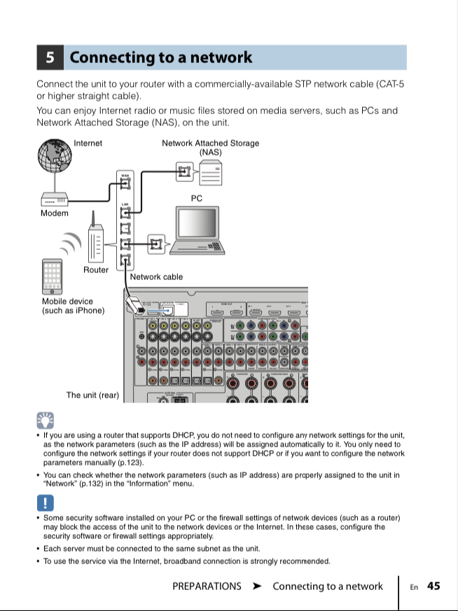

I’m sure you’ve looked over the information in the past, but…
Mark E. Long
Mark E. Long
View attachment 49415View attachment 49416
