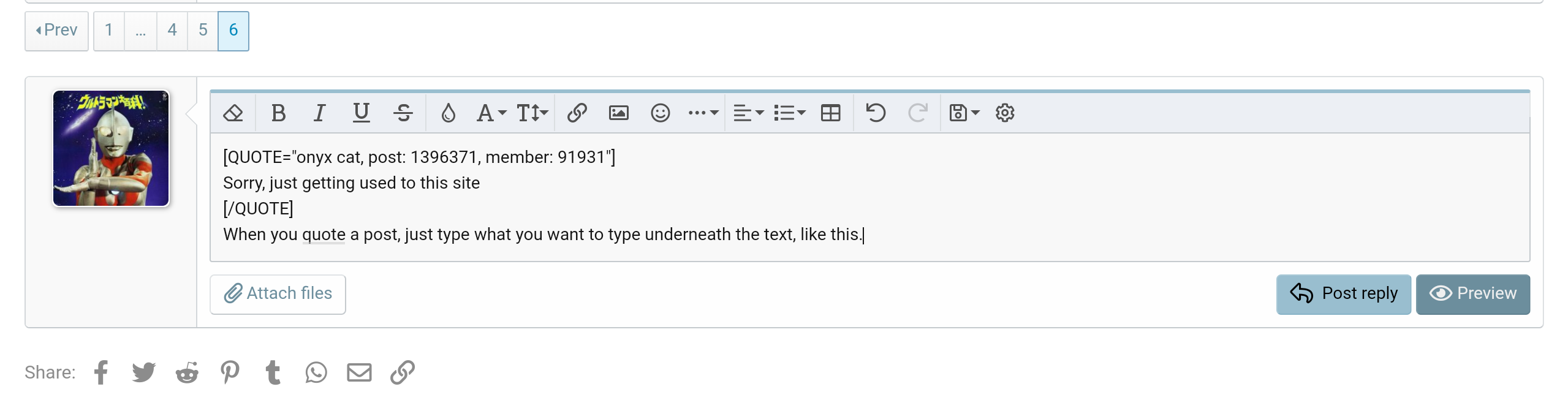

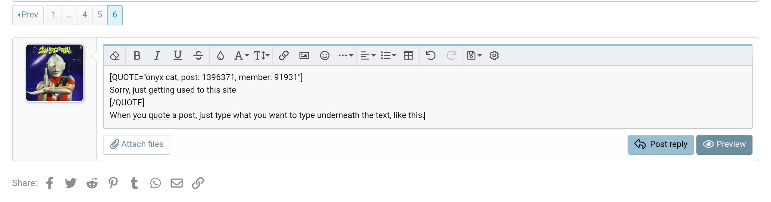

None of your quoted replies are showing up. They're blank except for what you quoted. It looks like you're not typing anything at all. Completely blank. Every post you made with a quote is like that and we're not getting half of your replies. That is making it impossible for us to help you.
You type your reply underneath the text in the box that pops up like the image below. After you're done typing click the little gray box in the lower right labeled "Post Reply".
