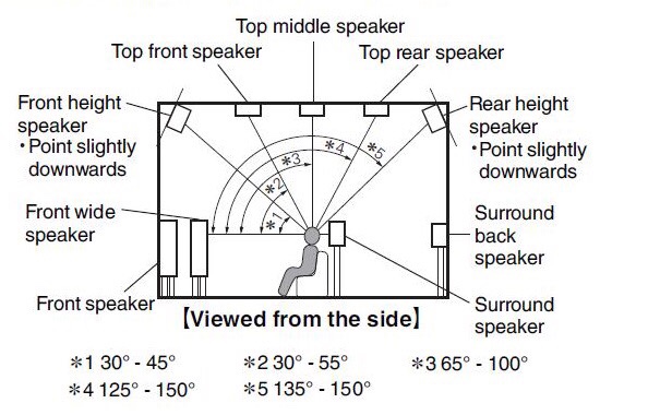

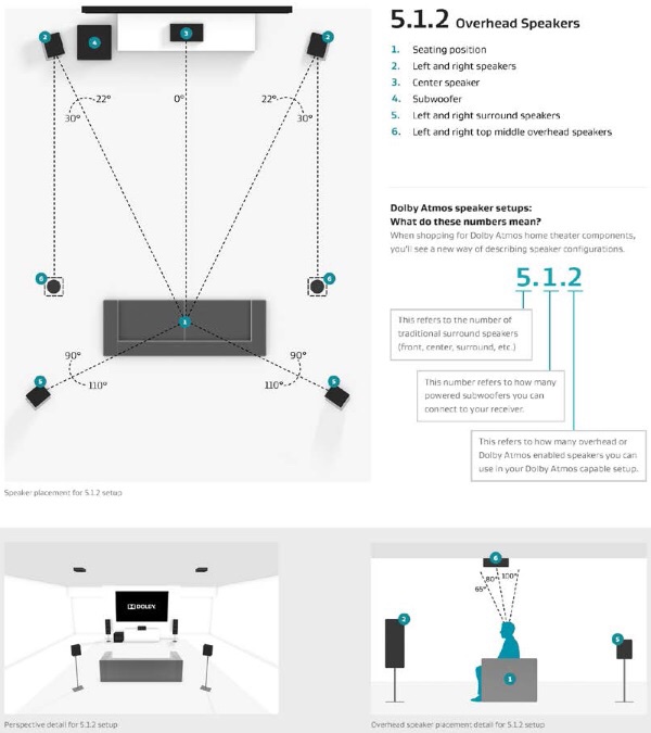

I understand the pics now. The atmos speakers are supposed to be the same distance from the wall as your L, R speakers. I will have these speakers mounted 3 feet in front of me for atmos up at the ceiling pointing down but point down 3 feet in front of my ears. Or should I point them at my ears if I can?
https://www.svsound.com/products/prime-elevation
William Lemmerhirt
William Lemmerhirt
I think it depends. If you’re only worried about one LP then I’d say aim them toward that. If your trying for wider coverage then point them down, or split the difference even.
snakeeyes
Agreed. I'm curious as to what he means by "straight sideways"
That’s how you walk after drinking too much. “Straight sideways”. :)
Actually the svs speakers are like a triangle so he means the triangle doesn’t rotate toward the listening position. Not sure these would be that great for atmos but SVS probably has a recommendation if you call them. I would recommend calling them.

Where do I mount these polks though? Do I mount them like 3 feet in front of my listening position and how wide? my room is 22' x 12' x 7.5'. 5.1 surrounds are on side walls 12' apart and fronts are 12' apart due to a 135" screen. Center and fronts are roughly 16 feet away
William Lemmerhirt
William Lemmerhirt
I think the same width as your mains and maybe 3’-4’ in front.
