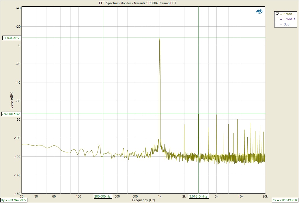

I read that before I posted anything.:D Crown audio is not always (I guess it depends on whether the material was written by their design team or marketing team) right about what they wrote on their website, just checked out what they said, or used to say/brag about their high DF and the way exaggerated benefits and you will know what I mean. As a generic statement, I don't disagree with what they said in what you quoted in BOLD. In this case though, we know what that home audio gear is, i.e. the Marantz AV7005 that I know for a fact would have no trouble driving the XLS 1502 to clipping and beyond.
Take a read of the following review by Gene if you are still in doubt:
http://www.audioholics.com/av-receiver-reviews/marantz-sr6004-1/sr6004-measurements
"Preamp Section
Marantz SR6004 Preamp FFT Distortion Analysis
With 0dBFS in, the SR6004 was able to output a whopping 7Vrms unclipped (<.1%THD +N). The 3rd order harmonic component was over 80dBv below the fundamental which was very good. Adjacent channel to channel crosstalk produced 81dB @ 1kHz, 65dB @ 10kHz which again is excellent.
This is not the AV7005, and AH has not bench tested the more recent Marantz AVR or AVP, but one can reasonably expect the most Marantz SR7000 and AV7000 series would have decent outputs regardless of their specified mere 1.2 V rating."
I would have agreed with you, but in this case I am firmly in HD's camp especially as the OP seems concerned about blowing his speakers so why not start with the safer 1.4 V setting and if that's not good enough he can then flip the switch over.
"Preamp Section
