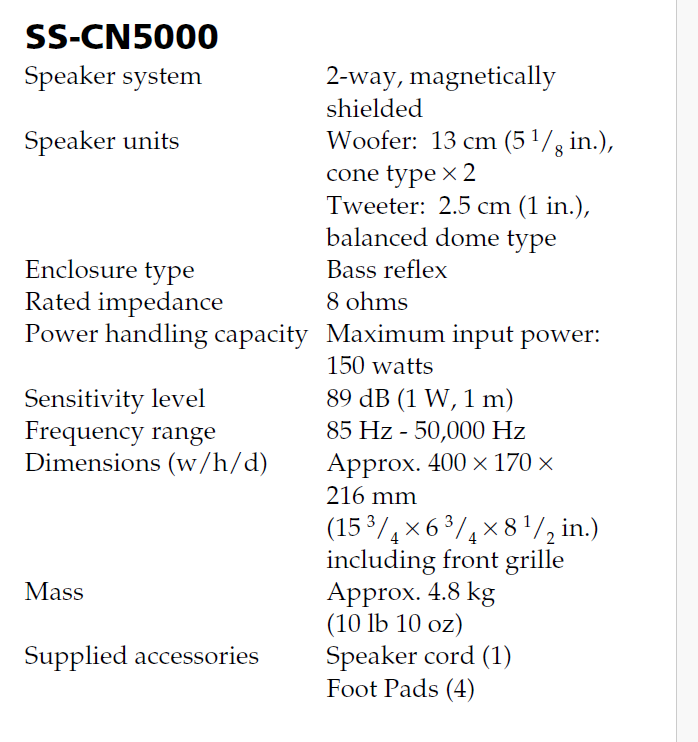

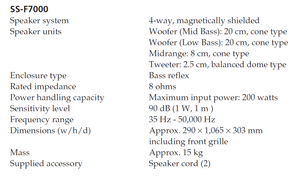

Am I missing something? Pretty much every new tower speaker today is either 2 or 3 way and the drivers are typically smaller with lower wattage and sensitivity isn't much higher (I know Klipsch list high sensitivity ratings but they cheat using in room measurements) I can't find speakers with the same wattage and other specs (at least not in the same price range)
Some might say that 'on paper' specs aren't the full story when it comes to speaker quality. Are the newer speakers more efficient so that they don't need as much driver size and wattage? Is it like how old cars used to have big 6 liter or bigger engines (well Cadillac in 1970s went up to 8.2 liter) but today's engines are smaller yet have more power and are more fuel efficient? Is it like that?
eg. Sony Front speakers from mid to late 2000's:
Center speaker:
Center speaker:

Thanks, but what was so awful about them? The sensitivity, wattage and freq range still compare favorably to today's ones.
Asian speakers? Aren't they all made in China anyway?

I'd eliminate "wattage" as a spec to go by, it doesn't mean a whole lot. Sony speakers in general have never been all that desirable IME. Those Sony drivers aren't all that large, but that's not always a good metric either. If you want a tower with 8" drivers that perform well at a good price, watch for the JBL 590 when they're on sale.
When those speakers were made, China wasn't a factor. Now, they make almost everything. The SS-CN5000 listing I found shows 'Made In Malasia' on the label.
