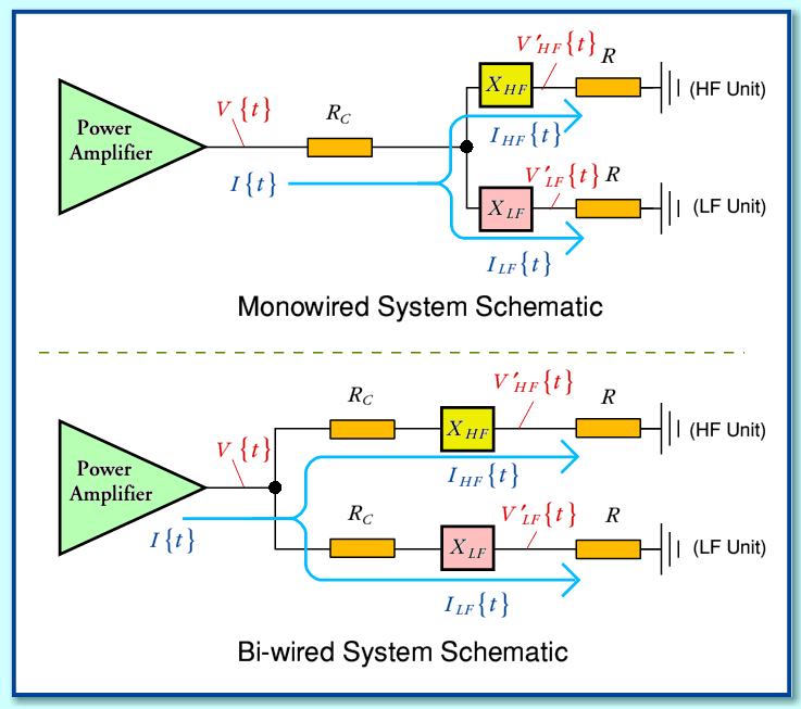

I took a look at the website you mentioned, I assume it is this one:
http://www.st-andrews.ac.uk/~www_pa/Scots_Guide/audio/biwire2/page1.html
Note that the system schematic that he starts from is exactly that which I proposed we should discuss. I guess the young ones aren't as stupid after all then.
However my obviously inferior mind can't seem to find any errors in his equations. Care to tell us younglings and straw-men which equation is wrong in your opinion and where exactly he violates the conservation of energy principle?
Actually, no. Sorry, it's page 2..
He show exactly the difference in energy loss within the wires both bi and mono, then ends with this:
""That although the monowired and bi-wired cases show patterns of cable energy dissipation levels which vary with time in different ways, this difference is equal and opposite to the difference in their patterns of energy storage and release in the reactances of the filter networks.""
So, the crossover network knows exactly what to store and what to release, and to do so in a time coherent fashion..?
There is a fundamental flaw in that reasoning...but first you need to understand very clearly the mechanisms..
Get over it..I said that to draw you out..it worked.
Honestly, why blather on like that? The problem is you aren't looking at it from a time coherent POV..not because of an "inferior mind". Please refrain from such silly statements.
From the perspective of the energy going into the rear of the cabinet and that coming out the front. The assumption that the front can retain time coherent output even though the energy going in is different between the two cases violates the law of conservation of energy. Remember, reactances are orthogonal to resistors...

I find it rather difficult to believe you are actually being serious about this.
That's not an argument at all. If you can point to the exact equation that is wrong then please do.
I do not need all that math to see there is no distortion. Call me simple if you want. Indulge me and let us take a look at the system schematic shown at the page you mention:
Notice how in both cases the currents through the speakers (the Rs at the right) are the same? This is no coincidence because your entire argument is built on the fact that they are: after all the only currents we are talking about are the A and the B (or Ihf and Ilf) which individually are the same in both cases. The only difference being the path they flow along before they reach the speakers.
Now John, please PLEASE explain to us this: if the currents through the speakers are exactly the same in both cases then WHERE is this distortion you are talking about? Do the speakers magically sense that the dissipation in the wires is funky and decide not to obey ohm's law any longer? That would be quite the find!
If you cannot answer this very simple question then all the rest is simply irrelevant! But I'm sure you'll again skirt around this issue in your next post and tell me "I don't understand the issue". Well...so be it!

We agree that the power losses in the wires look different if you plot them. No argument there.
We do NOT agree that the speakers receive a different power input. THAT is the crux of the matter. The power losses in the wire do NOT reflect on the power received by the speakers. It is trivially easy to see that because the currents through the speakers did not change!
Sigh, you need to get off the horse, stop diversionary tactics..and answer the Q...how two speakers given different power vs time, act the same? You agreed with Jim that the power was diff..remember?
You clearly don't understand what Jim and I are saying. The speakers do not receive different power versus time! Jim is very explicit in this and so am I.
Good. I was afraid you'd argue that..
When both speaker sets are connected to the same voltage source, and one sees less power at an instant in time than the other (you agree with Jim on that), then the speakers do not see the same power at that instant....
He says they do. He also says the reactances balance that loss equally and opposite, net effect zero.
I've known what your talking about since '74.
You need to re-think the system dynamics..
When you are ready, we can discuss non steady state, which is where all this is going...you missed the hint...

This is how I see it:
- The power in the speakers is a GIVEN in your experiment and determined solely by the CURRENT going through them. The current is the same in all the cases you presented hence the power is the same AT ANY INSTANT IN TIME.
- The power output by the amplifier is the same.
- The power dissipated in the wires is different (instantaneously speaking). True. Ergo someplace else in the circuit is compensating for this. We both got this part wrong (I blamed the amp, which is wrong) but Jim got it right in his analysis:
- The only things left in the circuit that can compensate are the filters. Weird you say? Not really as the filters are required to set up the conditions you specify. They are constrained on one side by the speakers (who's power dissipation is a given and fixed) and the wire dissipation on the other hand. They do not miraculously do the right thing, their behavior is imposed on them and simply a consequence of the circuit topology.
- There is no violation of energy anywhere in this. At any instant:
Pamp = Pwire + Pfilters + Pspeaker
Note however that Pfilters can be negative and must average out to 0 since they are reactive elements. This quite elegantly also provides us with an explanation as to why the 2AB component has to average out to 0 as well (as you have pointed out it does).
J
jneutron
Actually, no.
Examine the case of both speakers being driven by the SAME amplifier. That is the initial condition I had set, in order to eliminate the variable of the amp.
Both speaker sets (at the amp terminals) START with the same voltage. But yet, the monowire set receives power that is modulated by the addition of the 2AB component (recall this is what I first stated, Jim agreed, and you agree with Jim)
Umm, again, no. This is your assumption. The fact that one wireset is dissipating more power (or less) at any instant, means that one speaker set is not receiving identical power (in time) as the other one (my assertion).
He did? Where? How does an orthogonal (reactive) component compensate instant to instant, that of a dissipative element?? Remember, since the amp can only look at the speaker through the wires, and both wires are dissipating DIFFERENTLY, how can the speaker terminals be exactly the same??
Who said the speakers do the same thing???? Not I...that would be an assumption. Since the wires dissipate energy differently, and the reactive components do not dissipate at all, the balance is up to the speakers. Time shifted energy is THE CRUX OF THE ISSUE. Not average power. All heck breaks loose once we leave steady state..(hint)..
Since the amp voltage is equal in both cases, there is a difference because the wires dissipate differently.. The assumption that the speakers act exactly the same in time violates conservation of energy..
Umm...there is no such thing as negative power..I assume you meant storage vs release..and they both act 90 degrees out..
The 2AB power envelope, which does indeed has a negative component, is an anomoly, a construct that cannot exist standalone..it can only exist as a modulation of the A squared plus B squared entities...they always are equal to or greater than the 2AB component. Otherwise the system would cool down...
The 2AB component has a net zero integral. Hence my concern that it cannot be seen by a math package that looks for integrated power (that would be an FFT).
Nice try though....very well thought..
It's been a pleasure reading and responding to you..do not quit..
Cheers, John
ps..I'm glad I gave you the link to Jims webpage..it allows a commonality of discussion..
O
Omicron
Actually, no.
You cannot think about power in this way. The speakers do not "receive" power. They receive voltage (or current) which makes them dissipate power. The power they dissipate is dictated by the simple relation Pspeaker = Sq(Ispeaker)*Rspeaker. Simple as that.
If you argue that they would dissipate different power then by consequence the current trough them would have to be different as well. And that contradicts the basic assumption of your experiment, i.e. only currents A and B are flowing in the system.
The filters are a necessary item to set up the conditions of your experiment (i.e. split A and B apart perfectly). Note also that in real life no filter can behave the way you assumed (being infinitely steep). So the filters you use aren't exactly your regular basic reactances. Why are they able to exactly compensate? Simply because the circuit you created doesn't leave them any other choice courtesy of the law of conservation of energy. The math of Jim is spot on.
The more I think of it the more I am convinced the issue would become much clearer to you if you would abandon the idea of the "perfect" filters and actually redo the maths with a real capacitor and a real inductor in the circuit. The split between A and B will not be perfect in that case and 2AB type components will also start to pop up in the bi-wire case. The perfectly steep filters you assume now unwittingly introduce infinities into the circuit that muddle the issue.
Off course there is if you're talking about instantaneous power in the time domain (which you insist on doing). All reactive elements will show positive (storing energy) and negative (releasing energy) instantaneous power. Because they cannot dissipate energy the power has to average out to zero over time for any purely reactive element.
A term 2AB doesn't sound like a subtle distortion but quite a big one. Don't you think we should easily be able to see it in the time domain using a simple analogue oscilloscope?
O
Omicron
A little practical experiment that just popped into my mind:
If you make the wire resistance much much larger than the resistance of the speakers, then you can make the 2AB power loss component so large that it has the same order of magnitude as the power dissipated in the speakers. Right?
In that case the proposed distortion would have to be huge because, in your reasoning, the speakers have to compensate and the compensation is in the same order of magnitude as the undistorted power they where putting out in the first place. Distortion so huge would be easily heard or seen on an analogue oscilloscope. If it existed...
