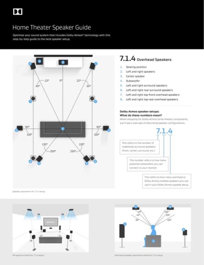

How far apart are your top speakers, and what are the room dimensions? There has been a lot of discussion on height/top speaker placement in reference to Dolby’s guides. This one is the worst offender.As you found out, following this guides recommendation to place tops as far apart as the mains doesn’t always work. Especially with a low ceiling height.
This is included in a more granular guide.
The recommendation is to place the tops .5 to .7 the width of your widest speakers. The main thing is being centered over the listener. That will give much better phantom imaging and image placement overhead, and into the room.

Yup, I used the first guide. Angle between front & back row is 90 degrees. Problem is they are already installed. Frankly I’m not sure it’s worth the expensive effort to relocate. And in my set up, 7.1.2 is far more convincing, not even close. My advice to people is set up 6 (not 4) just in case, then see what works best in practice.
Since I have 6 ceiling speakers I might as well give it a try at this point. BUT BE WARNED: most atmos tracks are locked at 7.1.4. Even if your processor can handle 13-15ch, the middle atmos row will get zero sound. Monolith’s HTP-1 is the only reasonably priced processor (that I am aware of) that some reports say can “add” the middle row to a locked atmos track, but in another forum, users reported this is not correct.
