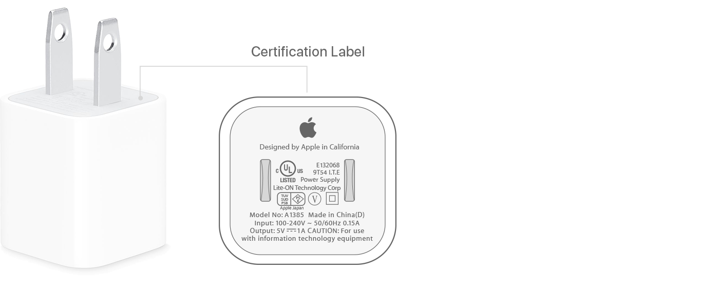

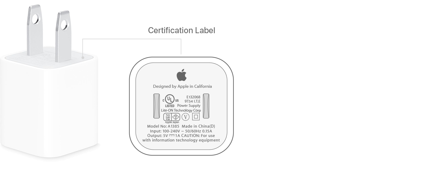

The Ruipro with Voltage Inserter is in place and works great. :) The Mac doesn't want to transmit more than 6 channels, so that is less great and I'm working on that.
Regarding the Ruipro USB Voltage Inserter:
I always wondered what use I may have for all those old school Apple Charging Blocks
that used to come with every iPhone and iPod... And now I know! :D They are meant to deliver 5v out via USB-A. :D
Yep. When I was testing the voltage inserters I had a bunch of those and the adapters for Kindle Paperwhites as well. They all work. I even purchased a couple of 1' USB extension cables to reach around to the front of my receiver so that I could connect the voltage inserter for power. That worked as well. 5V/1A is all you need.
