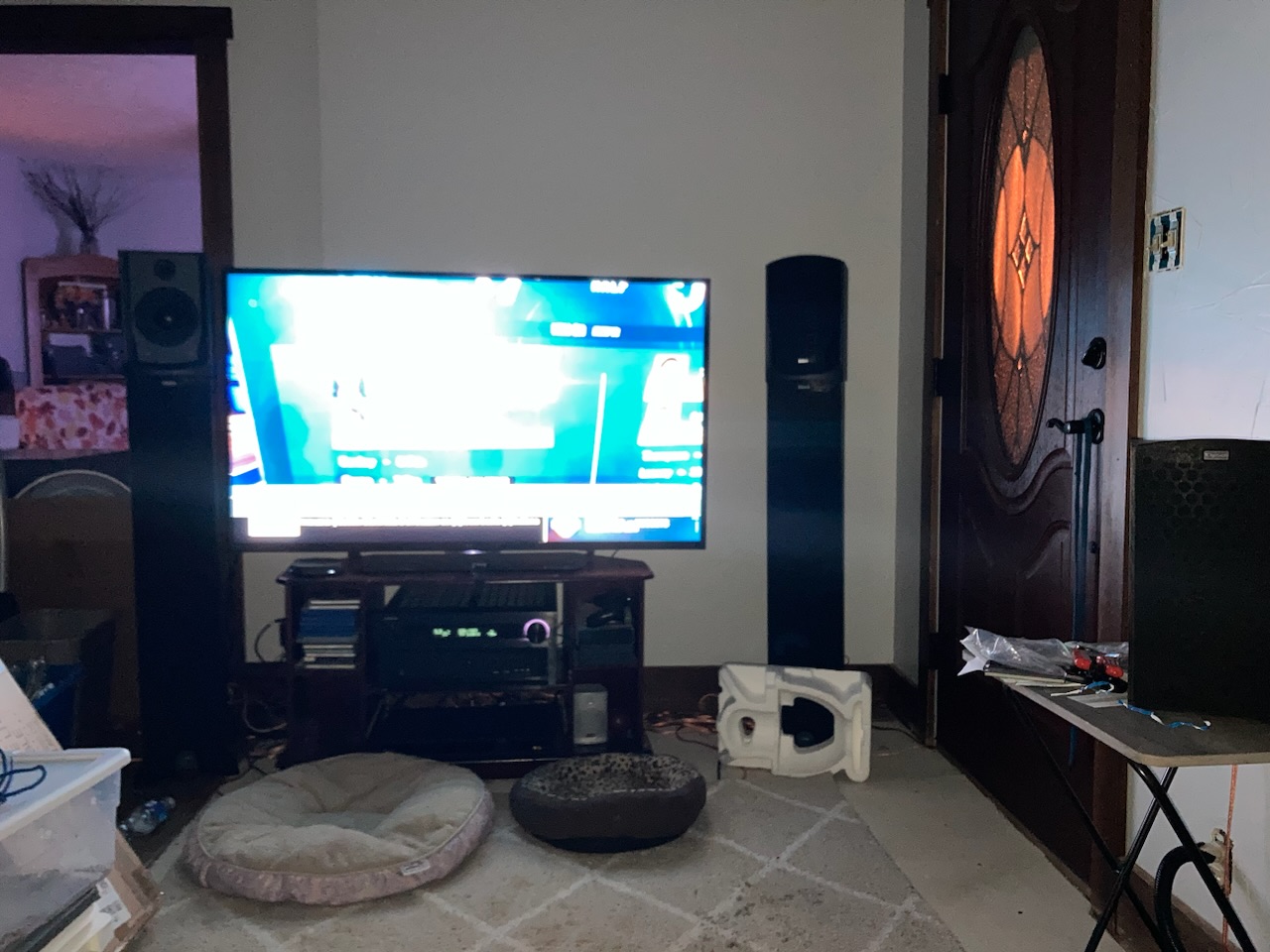

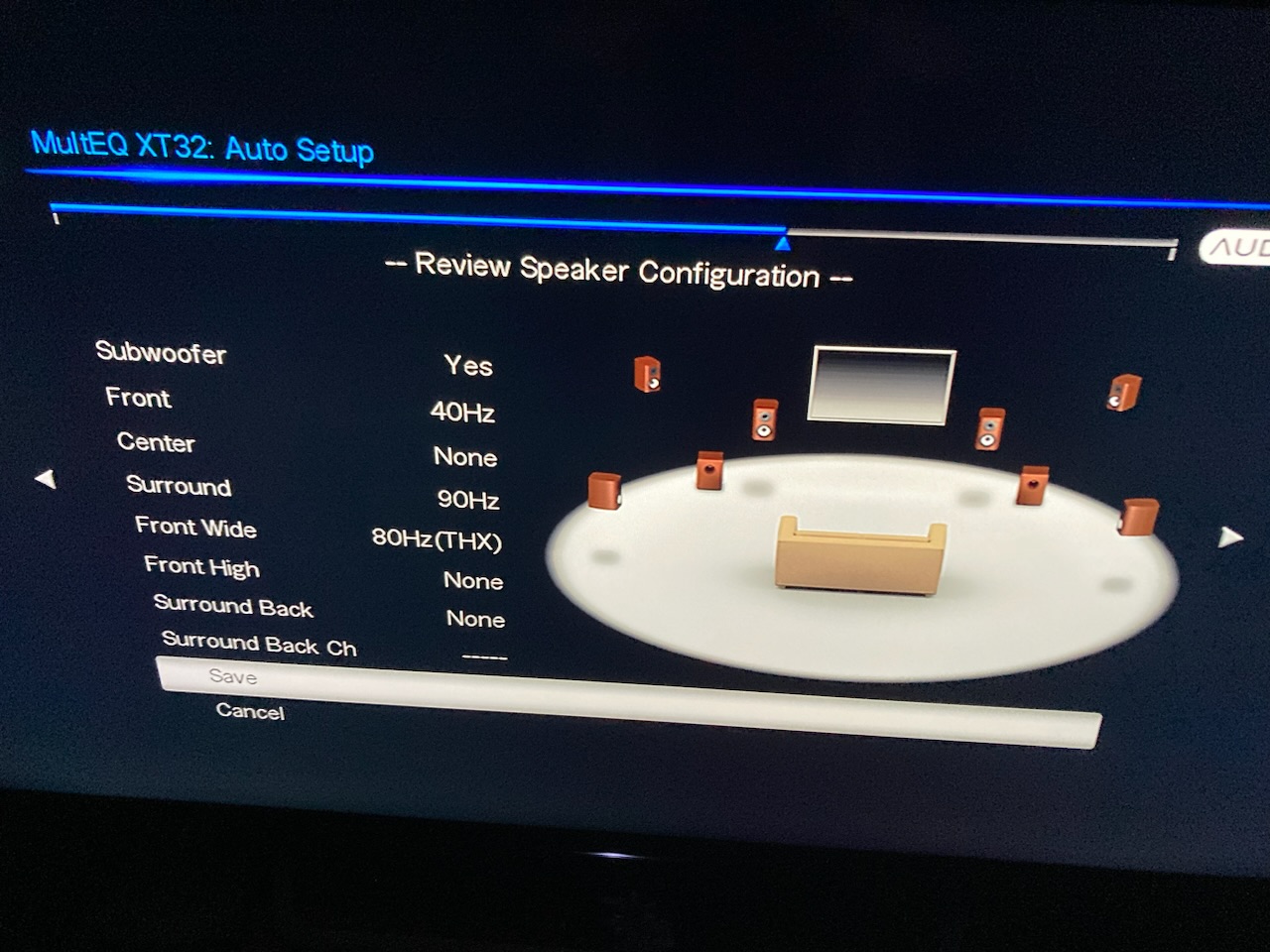

l will probably keep using the surrounds we’re the pic above I posts is shown with 4 speakers and a center , just because it sounds so good but I can switch to 2.1 or 3.1 for music and non surround if downmix is distorted content. It’s not true surround just a stereo mix technically just stereo with added center channel.
Tv logic mode sounds the best so far.
I’ve had surrounds behind and beside me when this set up was in my bedroom. That is optimal, I do know what it sounded like the movie theater.
xt32 level matched the speakers-way better using the speaker stand for the mic. However that strange trash can method worked ok but no plan on trying that again .

Use the speaker stand but put something smaller on it to get the top of the Audyssey Mic to ear height and position. The smaller object won't interfere with the sound as much as the speaker stand. Try to get it where your ear would be and not forward on the couch as in the photo.
As I remember the mic positions were closer together than a meter. What receiver are you using here?

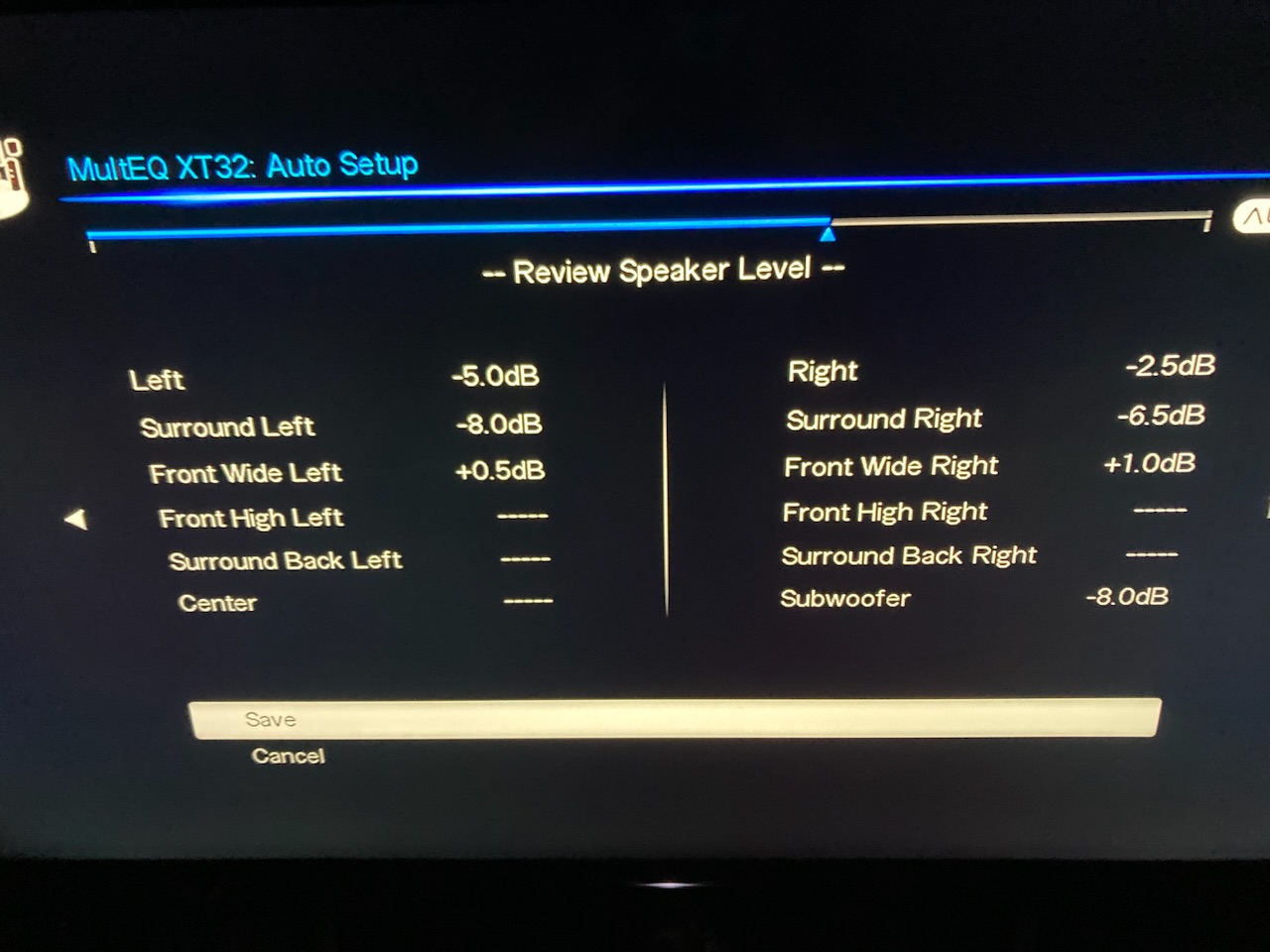

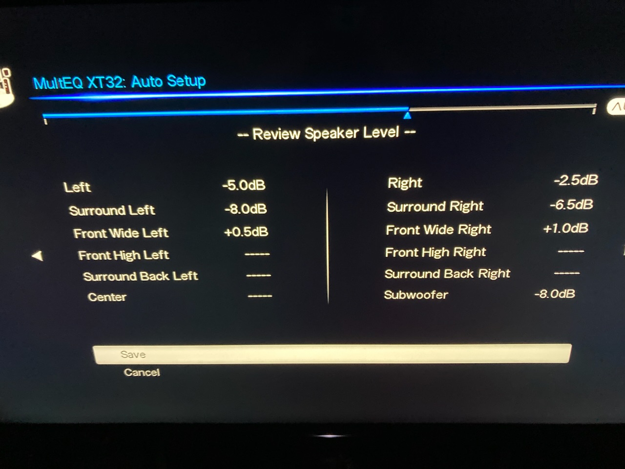

I re ran audysee ,
I placed all 8 spots on a small square cardboard thing so they were equal distance apart and only one was for each measurement.
Got this as results .. first one sub was -14.5 so I ran it twice and lowered gain .
Kingnoob
Kingnoob
Subs seem to be eq flat not getting much bass at all , but I’m trying to decide if I want to turn the channel up or leave them the way xt32 set them up?? The source itself lacks bass so I may just ruin sound quality by adding +3 db.

On page 61 of the Manual it says "you can adjust the level of each speaker with the built-in test tone so that the volume of each speaker is the same at the listening position." You only need to bother with this as a check to see if Audyssey got it right. So I'd Focus on setting up via Audyssey (after tweaking speaker / sub positions as needed.)
Follow it through on page 37. You need quiet to do this correctly, so pick your time accordingly. (I even shut down the HVAC system when I do it.) I always stay away from the mic (usually at the back or side of the room away from speakers, as to not interfere with the calibration.

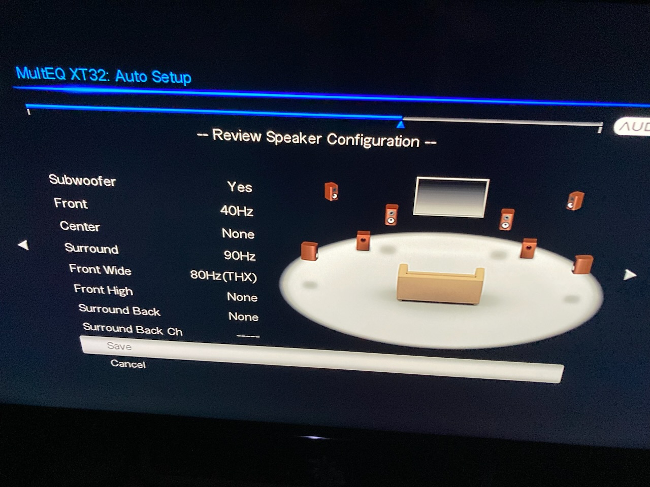

Is this format of surround legit its my only option for 7ch. But I can’t mount the speakers

As you seem unable to configure the speaker locations to anything near Dolby requirements, or in any logical configuration that has the listener surrounded by the speakers; I suggest you forget about surround sound period! Just go for 2.1 or 3.1 and enjoy it.

Ahh I see yeah my main audio source is stereo , prologic 2z just adds an extra level of height to the front speakers not sure if it does more than a surround speaker. Even if I ran 4.1 channels it would be matrixed decoded stereo.. I’m currently running no center speaker.

Just go for 2.1 and call it good.
I have it set up in 4.1 ch mode for stereo . Because I dropped the center to fit a bigger tv .
But the lesser the speakers the better it seems in smaller room. Sonic overkill is a thing . o_O

I’ll try Improved 6.2 if it fails I’m Going back to 4.2channel. Essentially got nothing to lose.
Note I lack a center speaker . Oddly enough I can’t get audysee dsx from a stereo audio source . Or no center no Dsx?

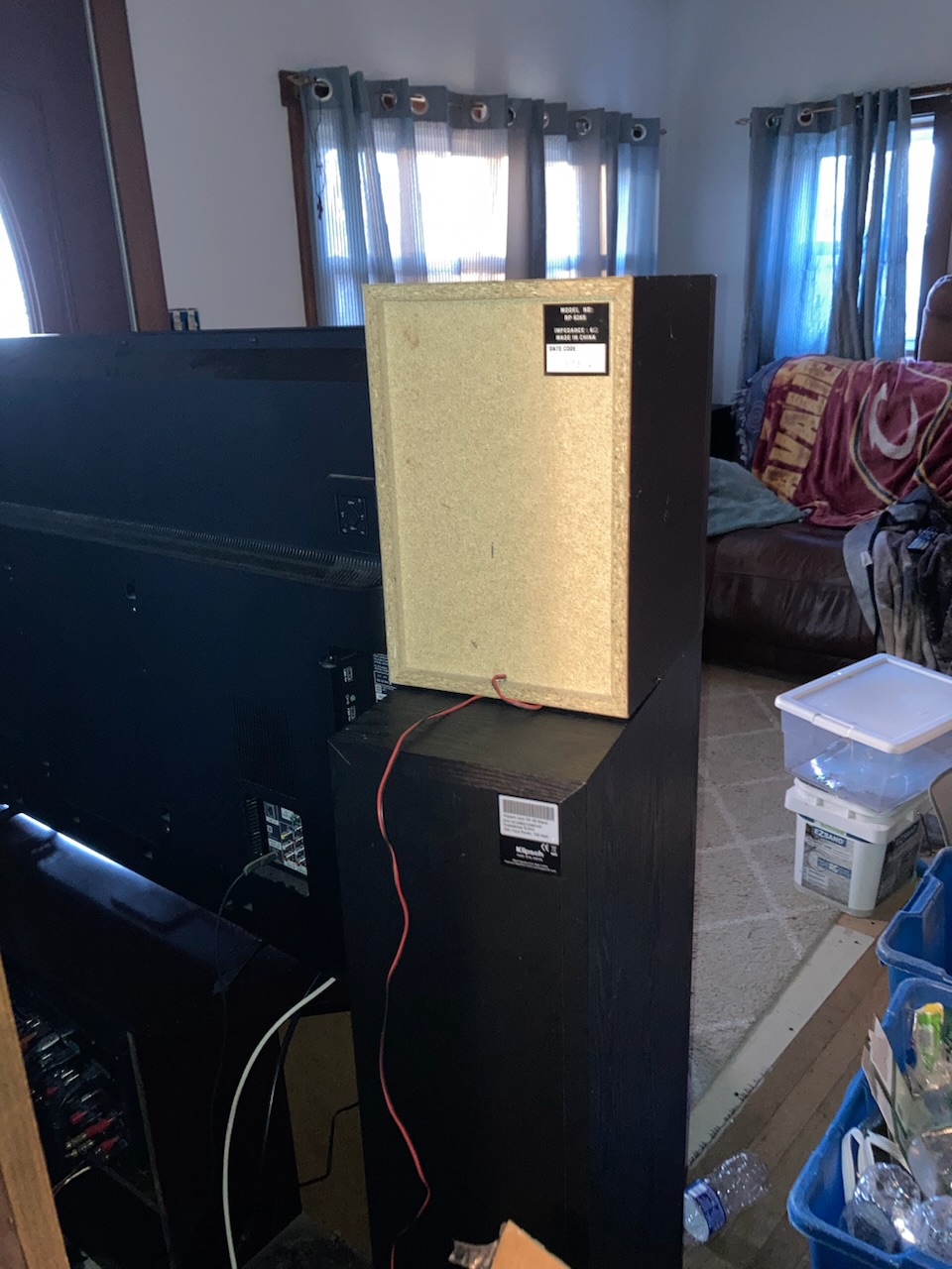

That’s not high enough for the “height” speaker. Should be 2-3’ above the mains.
yes you’re correct !
I’ve tried them raised before and it works either way . They don’t have the same higher spl as Atmos does , sitting on a tower speaker they barely have enough spl to be noticed the fronts just overpower them if raised.
they work better for
movies then regular tv .

Are you able to rearrange the room? (Flip it end for end and move the couch away from the wall (where the TV is now)? You can leave the bipolar speakers on those TV stands on each side of the couch - just a little (1 foot?) behind it, against the side walls. Put something small under each of them to get them up to ear level. They look too low. You may want to try your Height Speakers as your Surrounds instead. There's no point to them sitting on top of your Fronts. In such a small room I expect they could sound better than the bipolars, but without an equipment list (with model numbers) I'm just guessing.
Like I said above: "Let's first get you a decent 5.1 configuration that works in your room with a Dolby TrueHD source, then you can worry about adding other things into the mix.
Please post the sketch previously requested, and all equipment details. Then I can advise next steps.
I hope this is helpful."
old thread but Im trying to fix this room. Without flipping it .
yeah the room is a disaster, I don’t know if surrounds can even work in it .
getting subs the same level is hard I can’t seem to figure it out.
