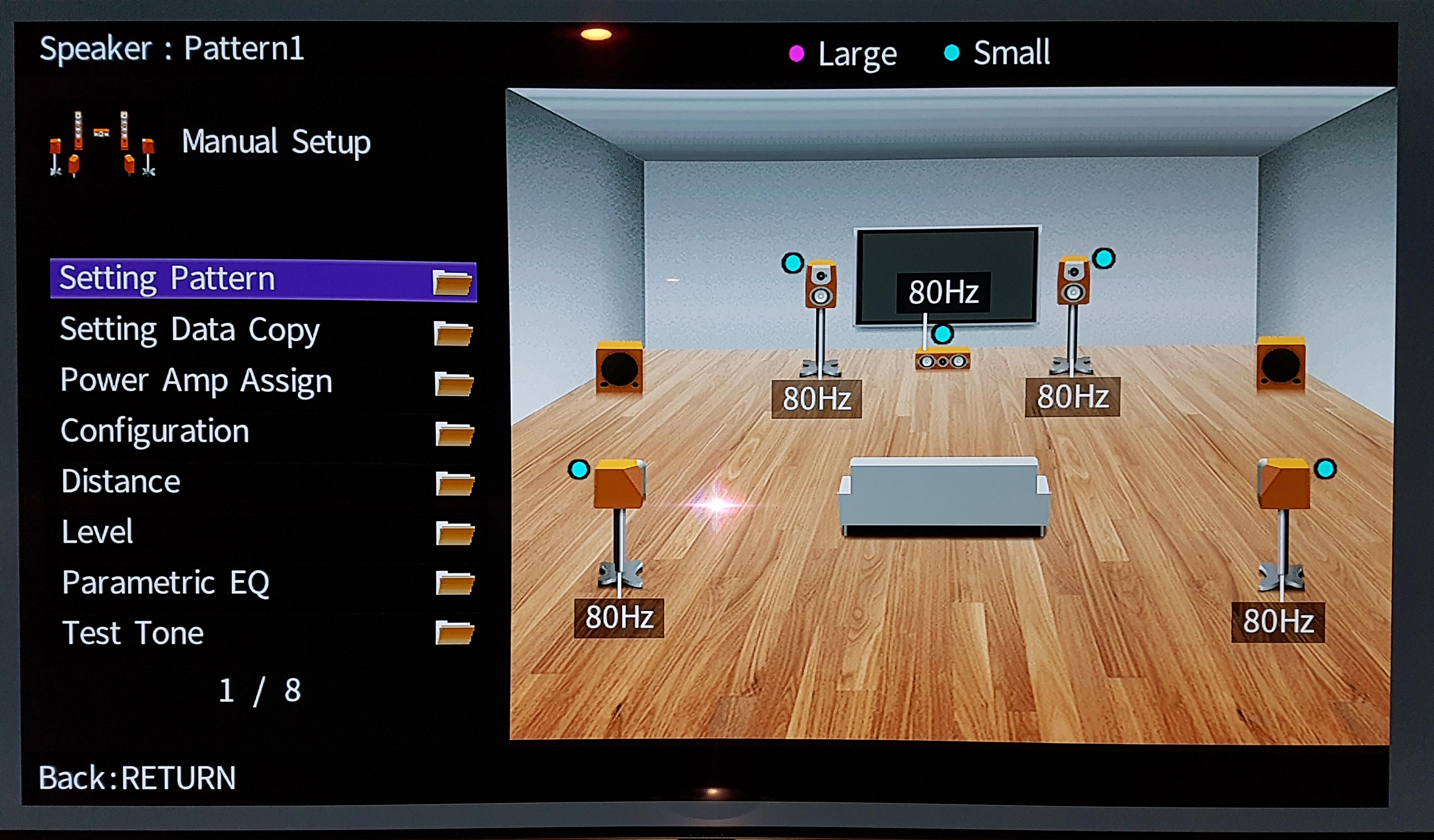

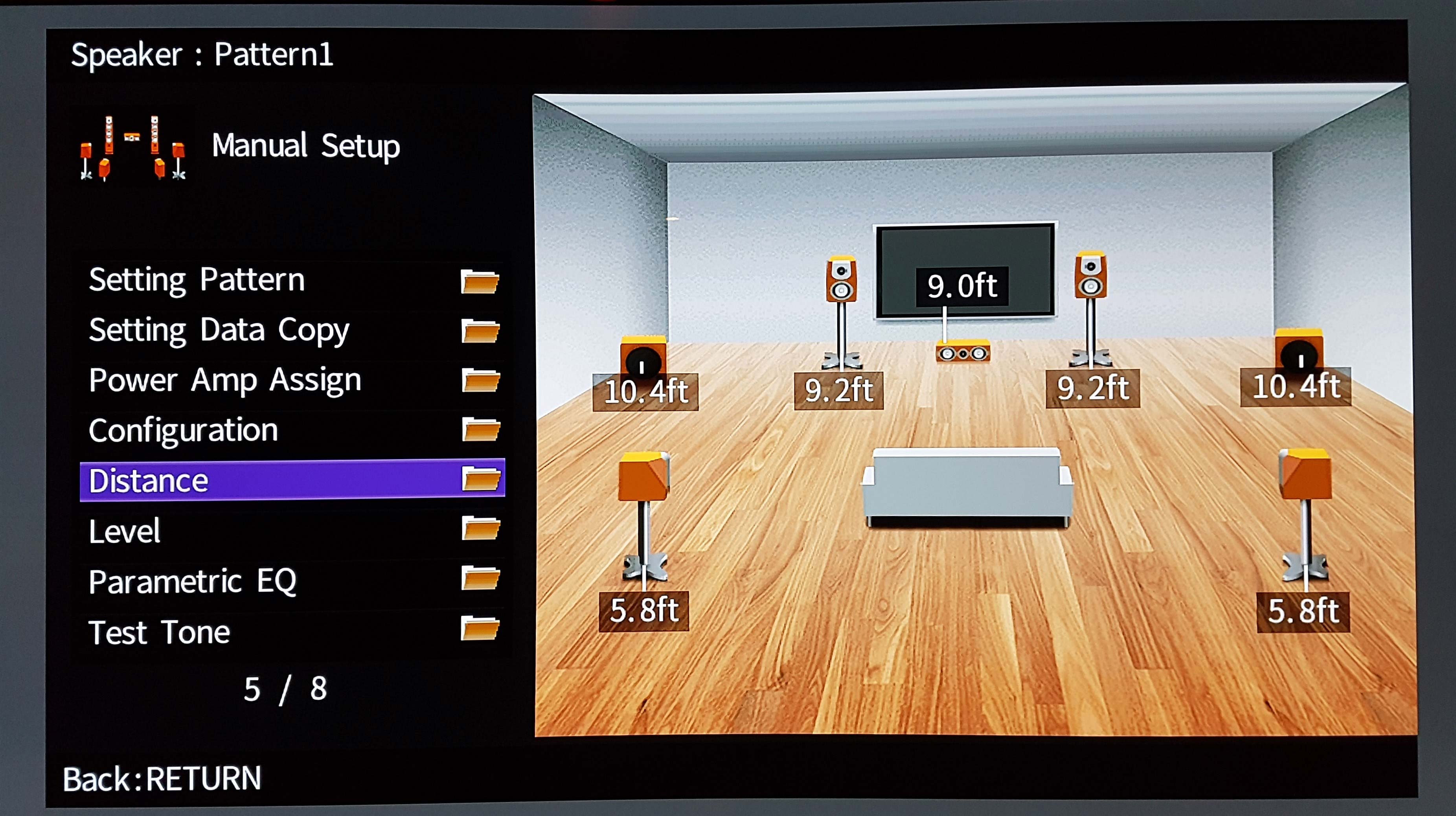

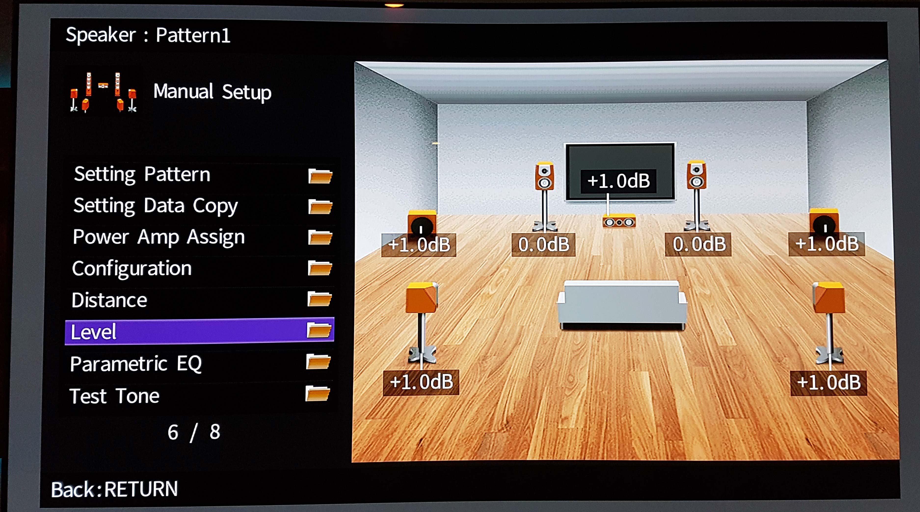

Alright so far this is what i got after auto setup. i did some manual setup for the subs, because auto setup put them on - 2db
