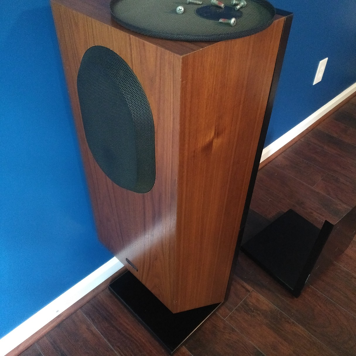

Allison CD-9s!
The good: Cabinets are in good shape, other than some scratching on the tops. Unlike the DCM's, they aren't shrouded in dry-rotted foam so I don't have to work on them outdoors.
The bad: Woofers need re-foaming. Not really a big deal. The refoam kit is less than $30 and I already have it on the way.
The ugly: While driving them home (flat on their backs in my car), the magnet fell off one of the midrange domes. :oops: I didn't see any voice coil damage, so I'm hoping it fell off straight and didn't rub/scrape the VC and everything works once I epoxy it back together. Fingers crossed!

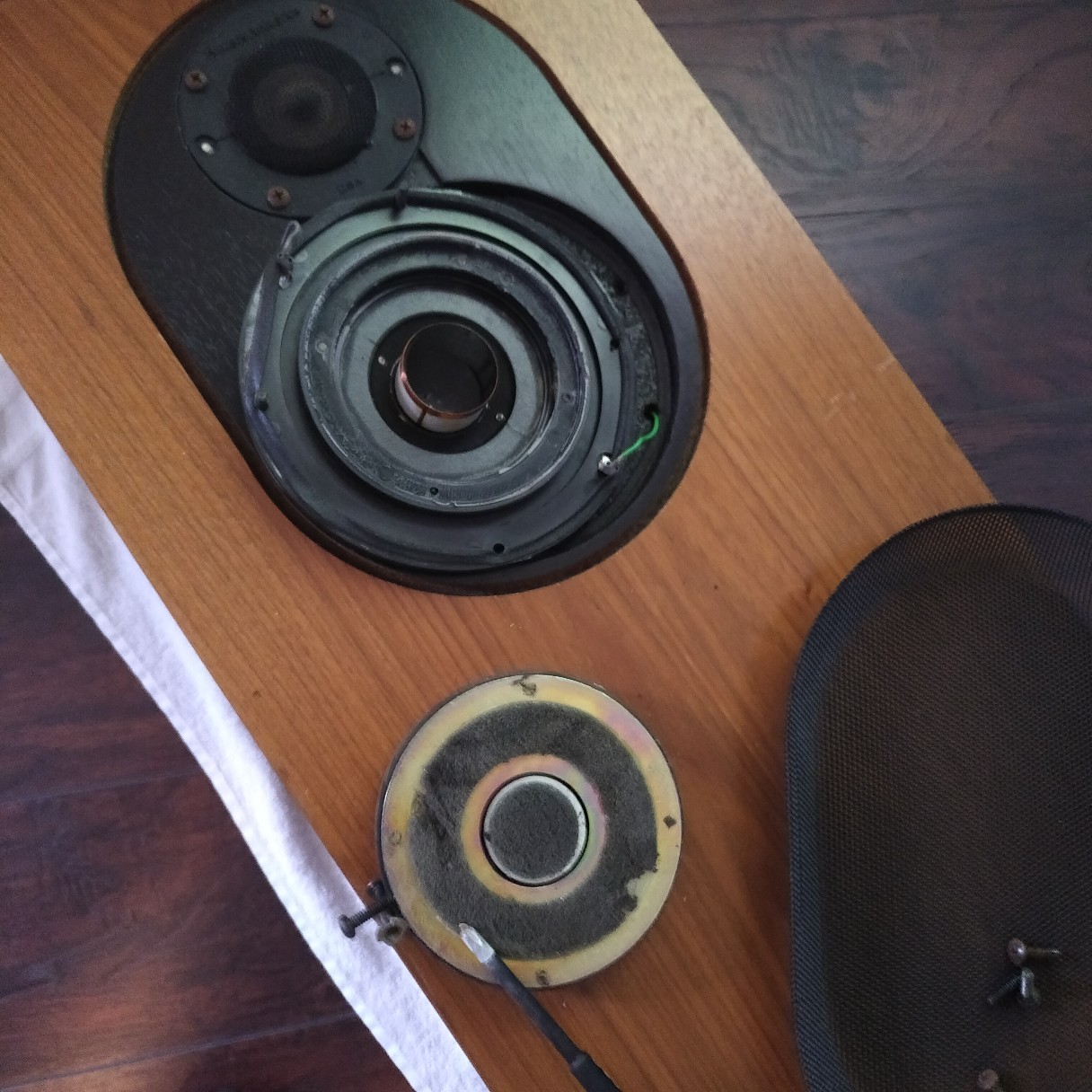

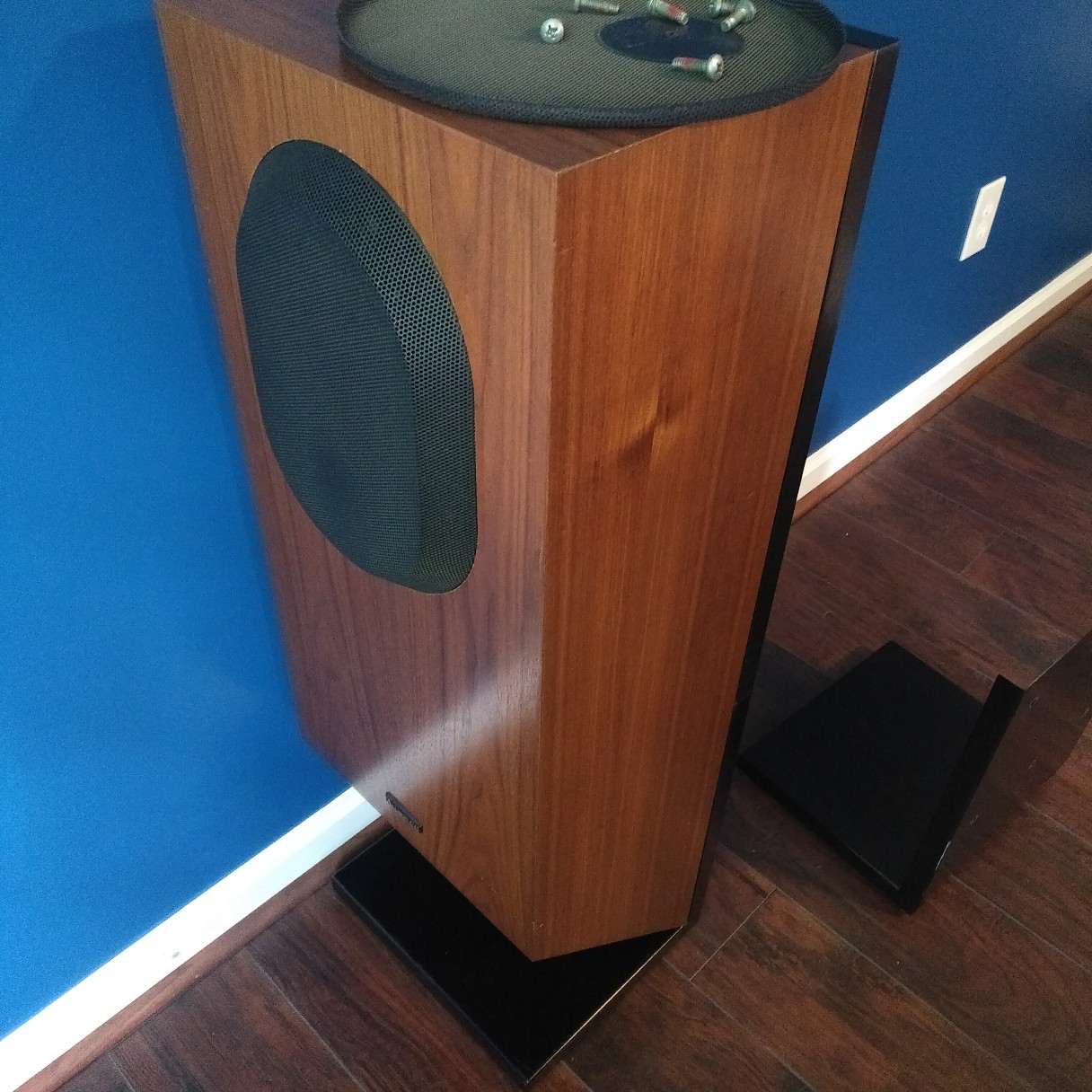

One of these ought to work for refreshing those. Worth doing, and not difficult.
https://www.simplyspeakers.com/allison-speaker-repair-foam-edge-kits.html

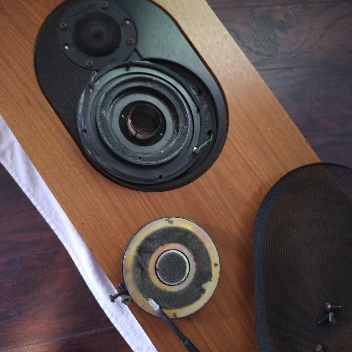

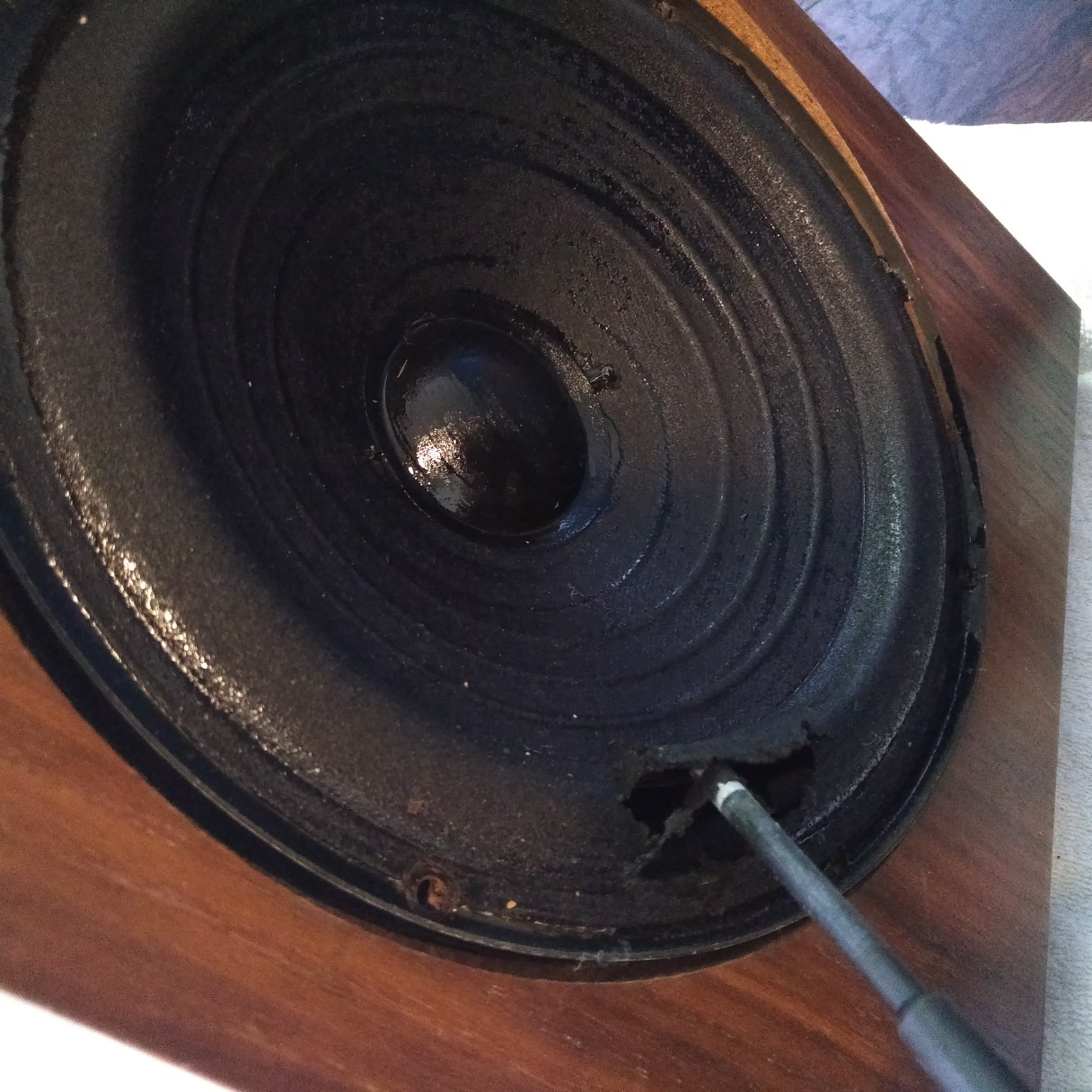

That's the one I bought. I worked on the refoam yesterday.
Got the old foam off with some struggle. The old adhesive put up a fight but I did the best I could.
Pretty sure the CD9's spent some time in a dank spot. A little rust on the frame, and some of the frontal screws had rust on their heads too.
Few hours later I had them redone and glue all dried:
Unnnnnnnfortunately, one is rubbing a little bit. It must have drifted off center while the frame glue was drying. the other seems perfectly centered.
Looks like I should have tried these, since they come with voice coil shims and dust caps:
I've read a few tricks to nudge the VC, which I will try tonight hopefully. If I can't get the one to align I'll have to buy the Midwest kit and try again.
