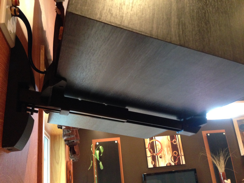

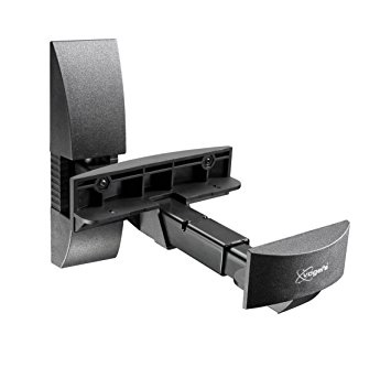

I used vogel vlb200’s for my old surrounds. can’t remedy what they were rated for but my surrounds were like 30lbs each. They are a clamp style and adjustable up/down/side to side. Maybe I can find a link.

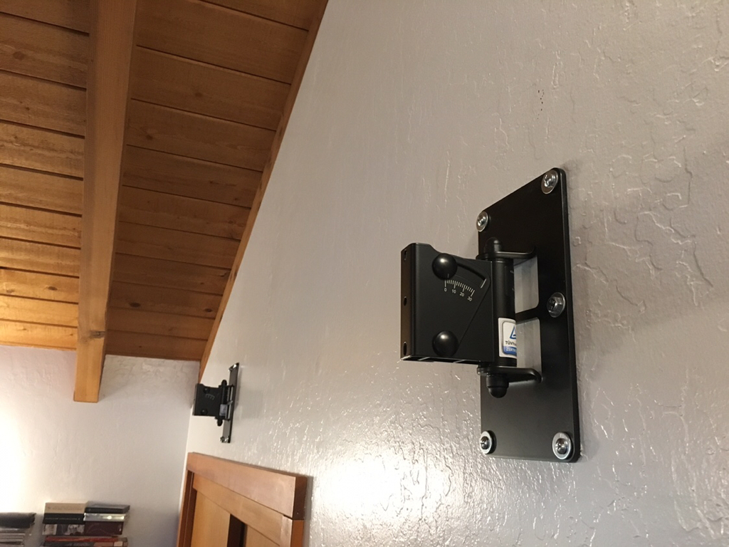

Depending on all the variables... K&M has good gear, rated for some heavy speakers, too, with good adjustment options. Also, Consider using VESA mounts like you would for a TV... some of those can be adapted very easy for ceiling and wall mounting, and some of the armatures are even more flexible in terms of angles.

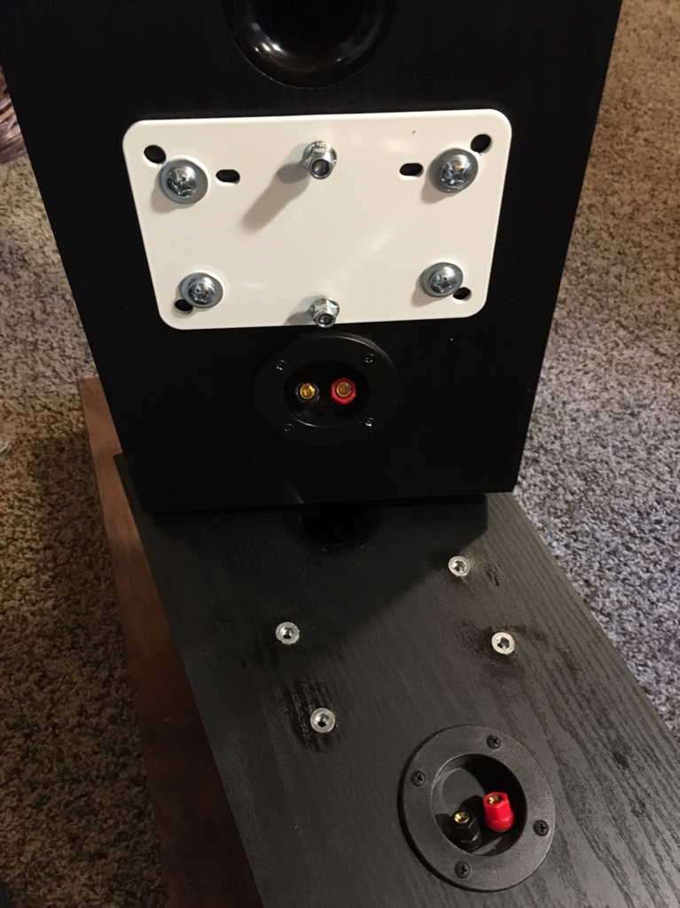

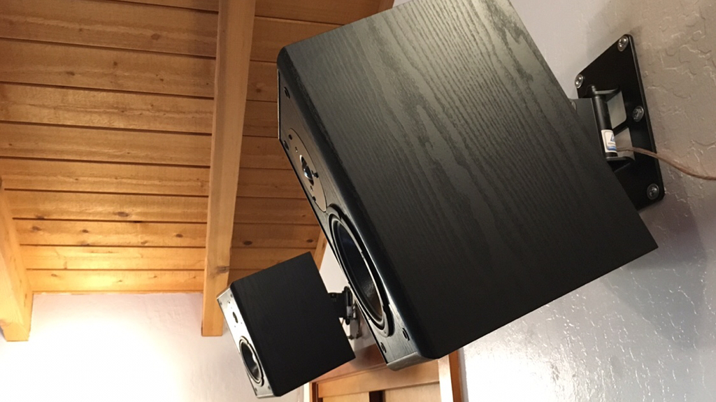

I used K&M for my rears... drilled into my speakers and installed 1/4x20 threaded inserts to attach their Adapter Plate, then mounted... I'll post a pic in just a moment. :)

I’m not gonna do chin ups on the speakers, but those brackets are lag screwed into studs! The threaded inserts are probably the weakest link, but thus far, no problems.

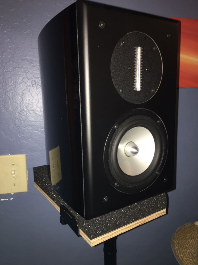

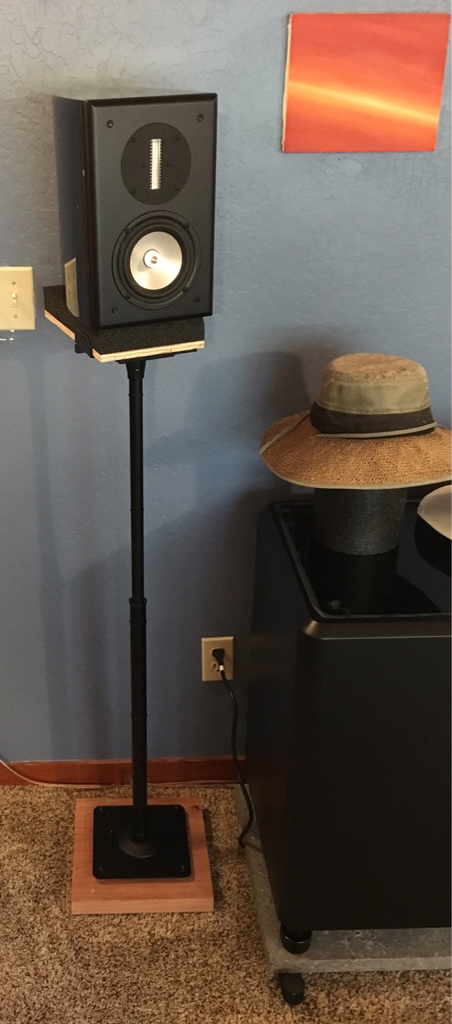

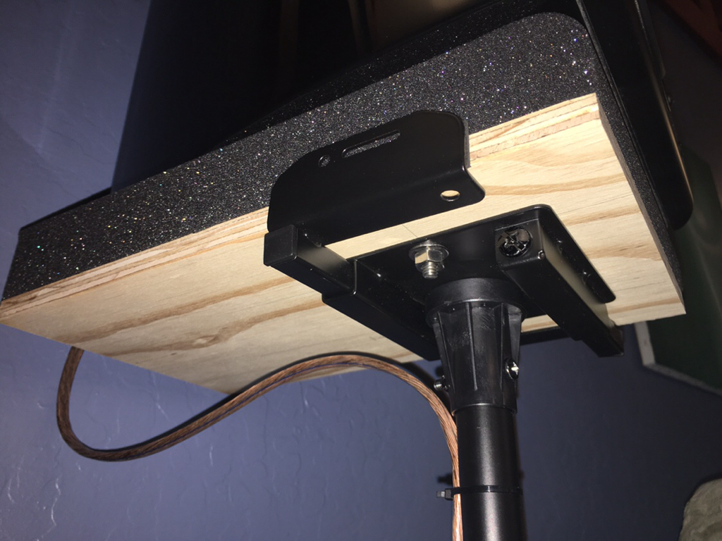

Basically took a 2x12 scrap redwood board, cut it to roughly 11x11, screwed it to the base of the stand using m6 screws where the supplied spikes would go on original base. Installed my own spikes, Dayton from parts express on the bottom of the wood base. Much more stable. I took a piece of plywood and cut it to fit a monitor pad, bolted that to the top platform of the stand, so the speaker is better balanced. Still kinda wobbly overall, but much better than before.
Here’s a photo of the underside so you can see what I did:

Hmm I was going to use a larger board should I need to, would you if you had to do it over? Or is the wobbly more in the sliding assy?

Since I'm only using them for a few months, I figured how bad can they be! *facepalm The top of that platform is only 4x4"... and I'm supposed to trust those "clamps?" Ha!
