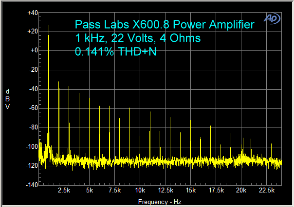

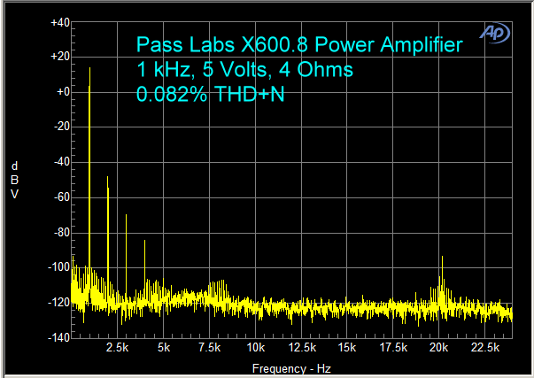

The Pass Labs X600.8 600 Watt Monoblock is rated 600 Watts RMS into 8 Ohms, 1,200 Watts RMS into 4 Ohms.
I am not arguing the point, but those measurements were at 22 volts or 60.5 watts. Not exactly high power. The Passlabs amp measures superbly at 5 volts, but nothing to write home about at 1/10'th its power rating.
Eyeballing these charts to try to use consistent scaling:
At 5 volts, the 2'nd harmonic is 64 DB down and the 3'rd is 80 DB down.
At 22 volts, the 2'nd harmonic is at 58 DB down and the 3'rd is 60 DB down, at it keeps going with the 5'th harmonic at -90 relative to the referenced tone.

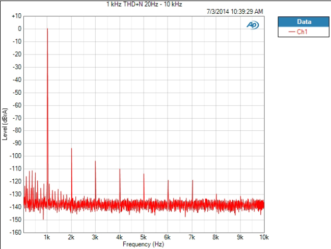

The Emotiva XPA-1 Gen 2 mono-block is 600 watts into 8 ohms, 1,000 watts into 4 ohms.
At 12.5 watts, the 2'nd harmonic is 95 DB down and the 3'rd is 104 DB down, 4'th is 110 DB down, etc. into the noise
At 600 Watts (69.2VRMS) , the 2'nd harmonic is at 100 DB down and the 3'rd is 88 DB down, 4'th 103 DB down, 5'th 100 with odd harmonics remaining at -110.
I don't know which one sounds better, but it is clear which one measures better ;)

i know you use P=V^2 x R formula to get that 60.5 watts number. but we don't know how much the current (I), right ? afaik, even passlab class AB amps are biased high so when idling are drawing about half their rated power.
https://passlabs.com/articles/leaving-class-a
so i believe these amps produce more current compared to other class AB amps even at the same power output (same watt) and same load.
you should also notice that those graphs have different y axis scale :dBV versus dBrA. and what's more important is the passlab amp measurements are ABOVE 0 db scale. with 3 db equals twice power, i think it's a mismatch comparing those graphs.
The output current for the same load would have to be the same. The input current could be higher but the reason why they biased higher is to achieve better linearity at low volume and at rated output the difference between the two should not be that significant. The Passlab would be quite inefficient at lower output level.
Yep, I was working with what was available, but I tried the eyeball the positive scale to describe the level of distortion below test tone(s).
The higher the resistance the more current is required to maintain class-A.
