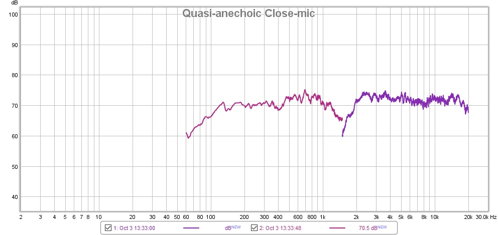

The above graph is a Klipsch RP 150m with a 90x90 (+-45 degrees) dispersion pattern. While the spl of the high frequencies is about 6dB below the lower frequencies, the shape of the response curve is nearly identical to the on axis curve, all the way out to 14khz.
No horn resonance here, the close miked unsmoothed response of each driver is +-2dB

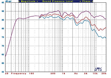

The second graph is a B&W 703 up to 45 degrees off axis. There is nothing terribly wrong with the off axis response (no unruly peaks or dips), but as you can see, above 5khz the response drops off rapidly.
Which dispersion pattern would you rather have if the goal was “wide dispersion” and uniform off axis dispersion (and therefore flat response from first reflections). Not only will the first speaker offer uniform coverage at the highest frequencies across all seats in a room, but the direct sound and reflected sound will be of the same timbre, giving us the benefit of first reflections “spaciousness” without negative effects on the frequency response, regardless of the room placement. You don’t get the wide dispersion toole suggests without waveguides or horns designed for uniform dispersion. It’s why every JBL studio monitor is horn/waveguide loaded.
