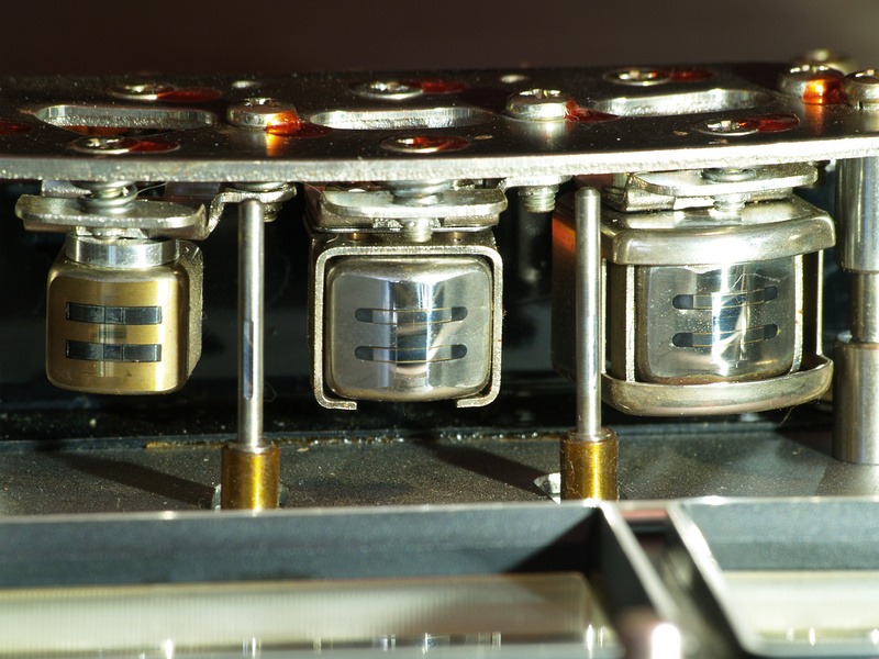

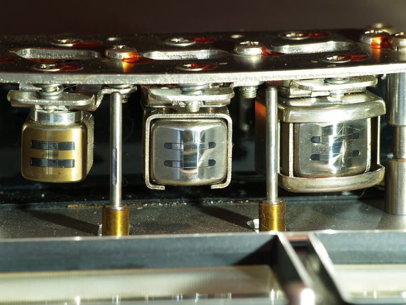

Or, you could look for one of these- Elcasette, which had 1/4" tape, the cassette had most of the bulk of a Beta tape and aside from being playable in machines made by other companies that were involvled in this format, it wasn't compatible with ANYTHING else.
They became conversation pieces.
