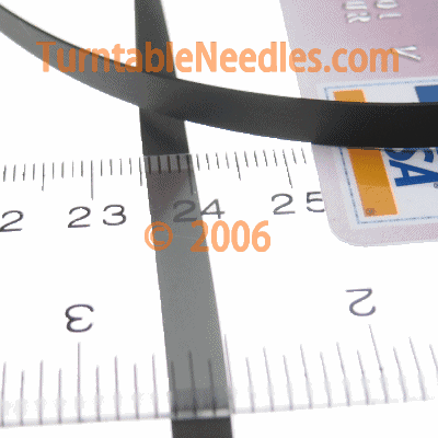

I found a site that has belts, phono styli and other parts- the belt prices are decent, the price for an AudioTechnica AT-30E stylus is $239, so I WON'T be buying one.
