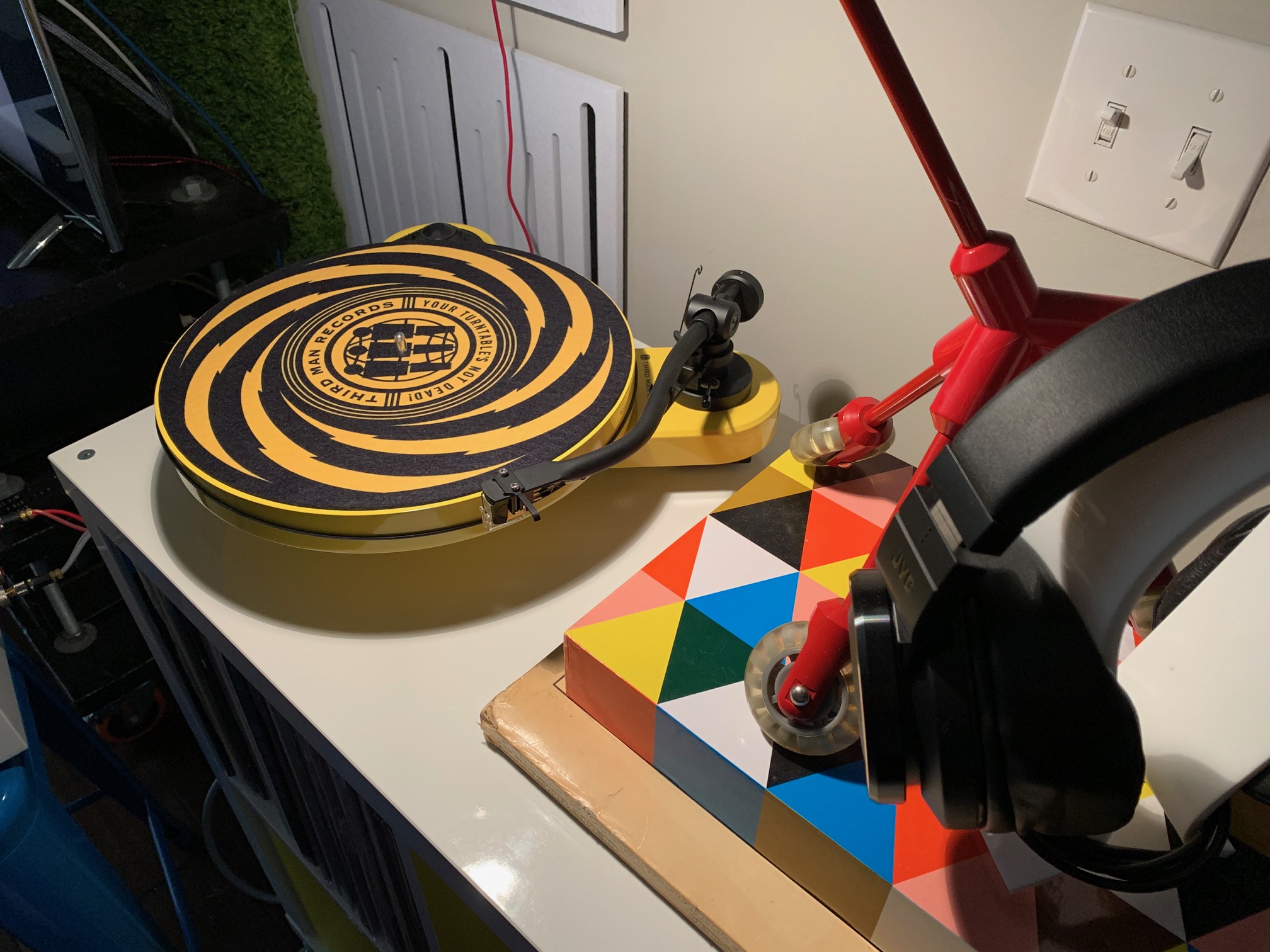

Speaking of hooking up, I finally set up my turntable that has been in semi-storage since my d-i-v-o-r-c-e- last year:

Got it going. Carole King is on. I guess when I get the MC I will hear a difference. Sounds good though but no difference. In case you can’t see the Phono Box it’s on top of the Yamaha. Zoom in. Don’t worry I’ll move the Phono Box on the side after pics. :p
DCM books providing the analog amazing sounds.
All carts ready if I wanna change them.
