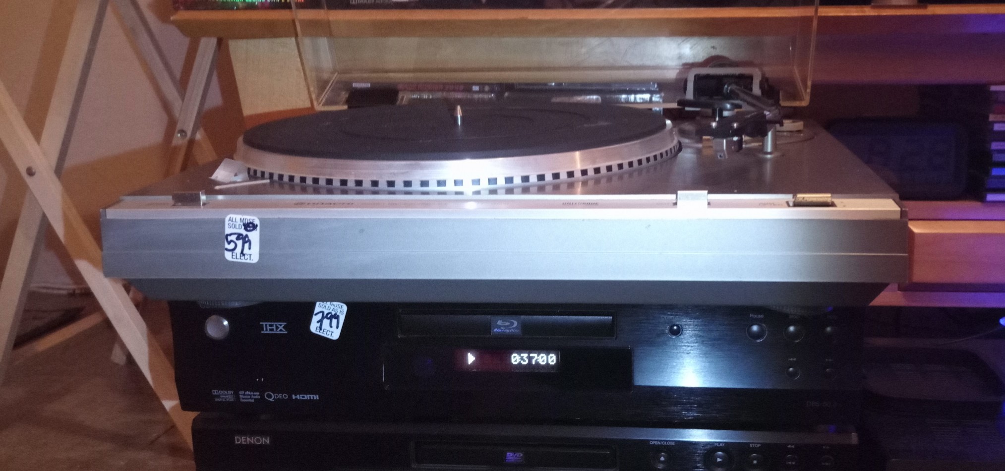

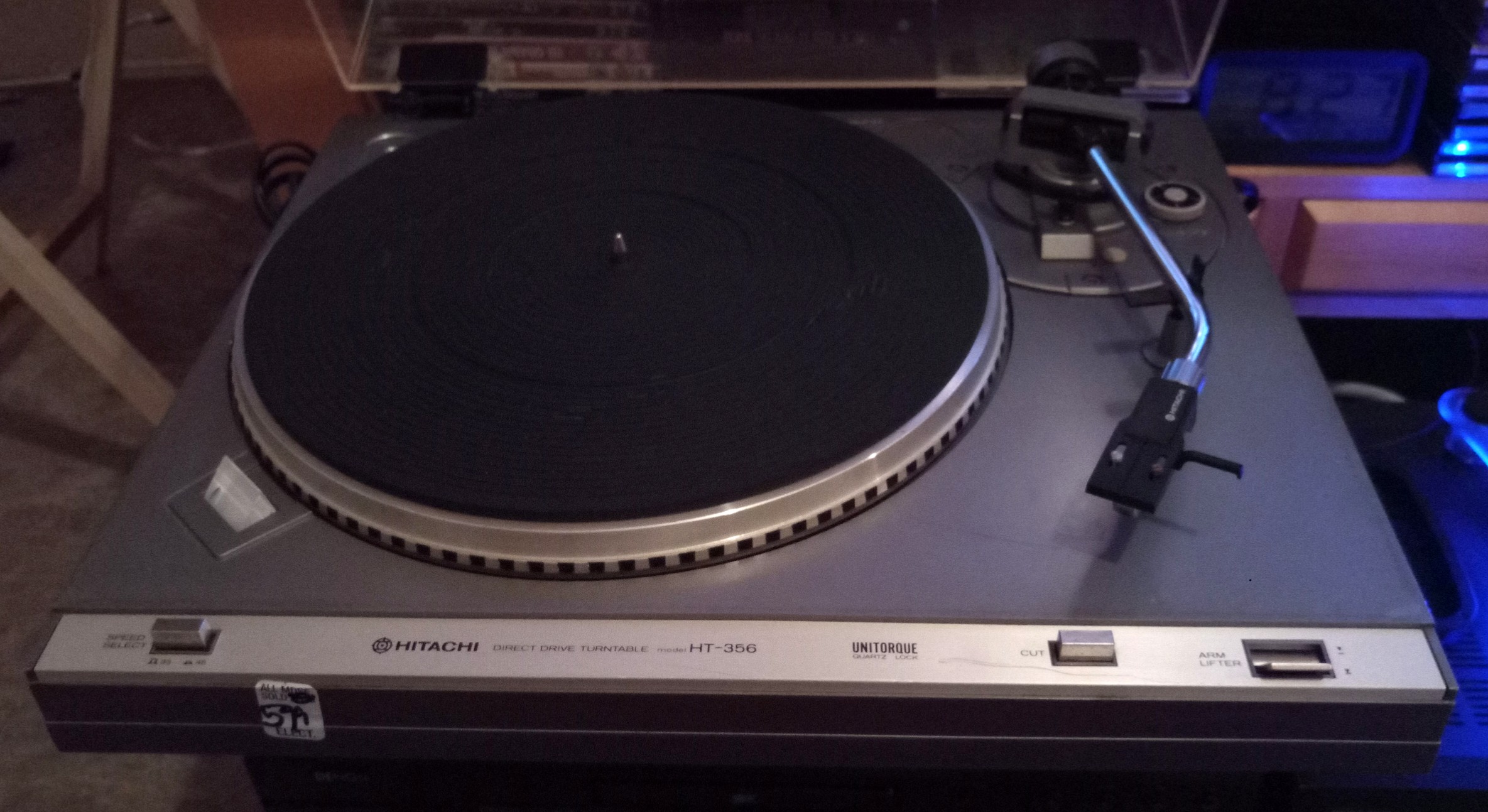

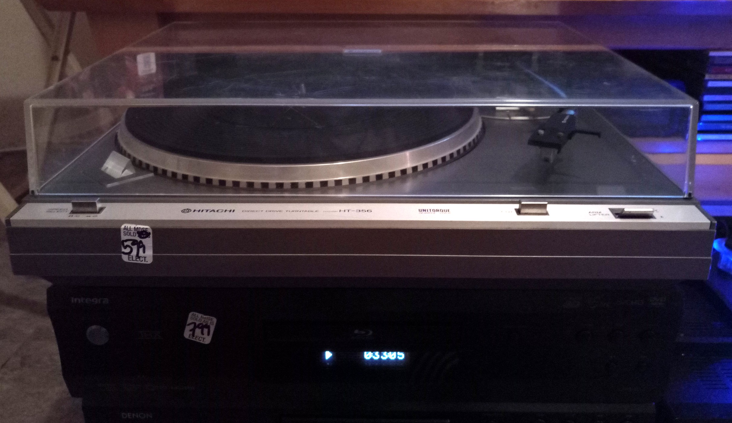

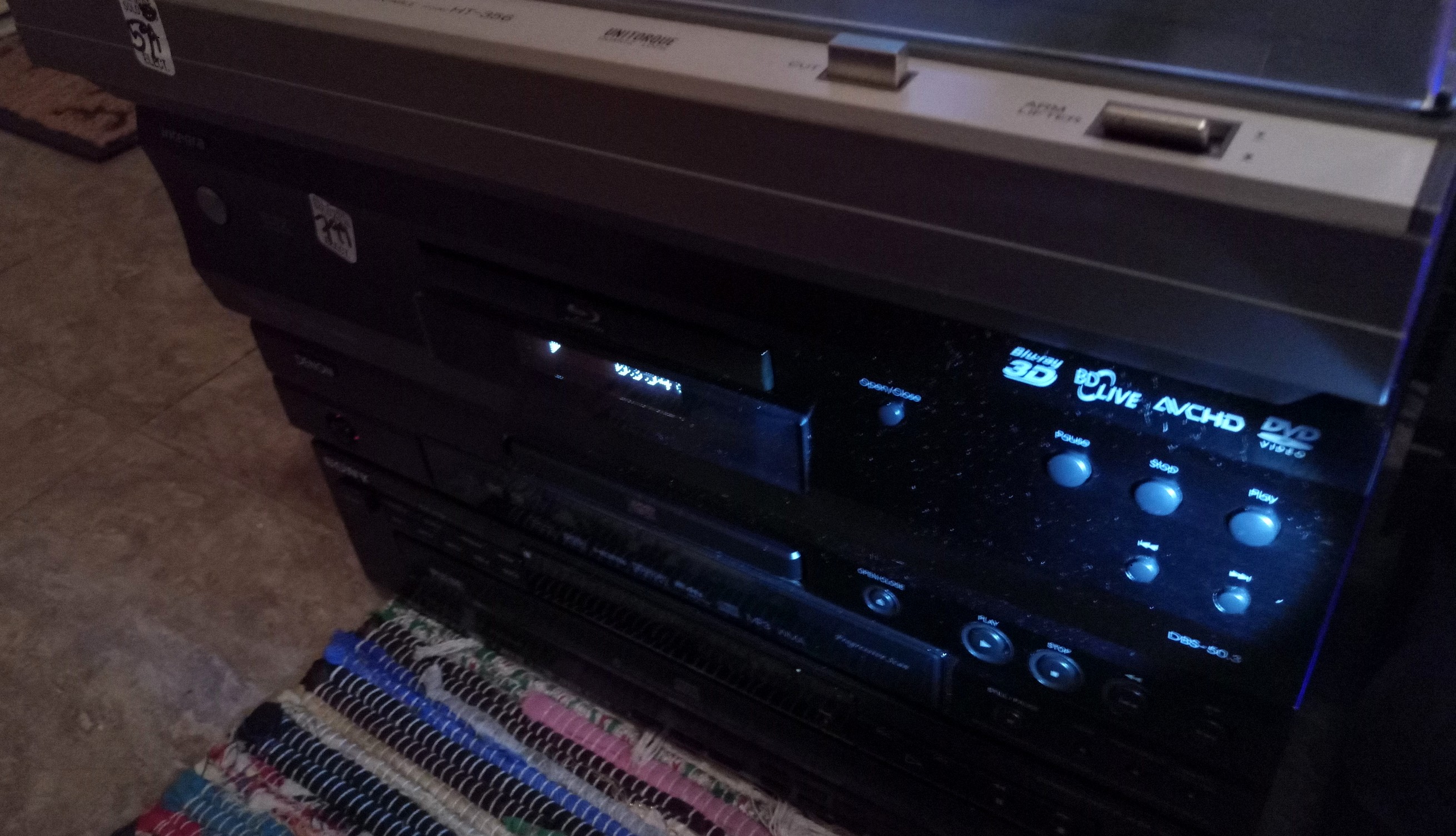

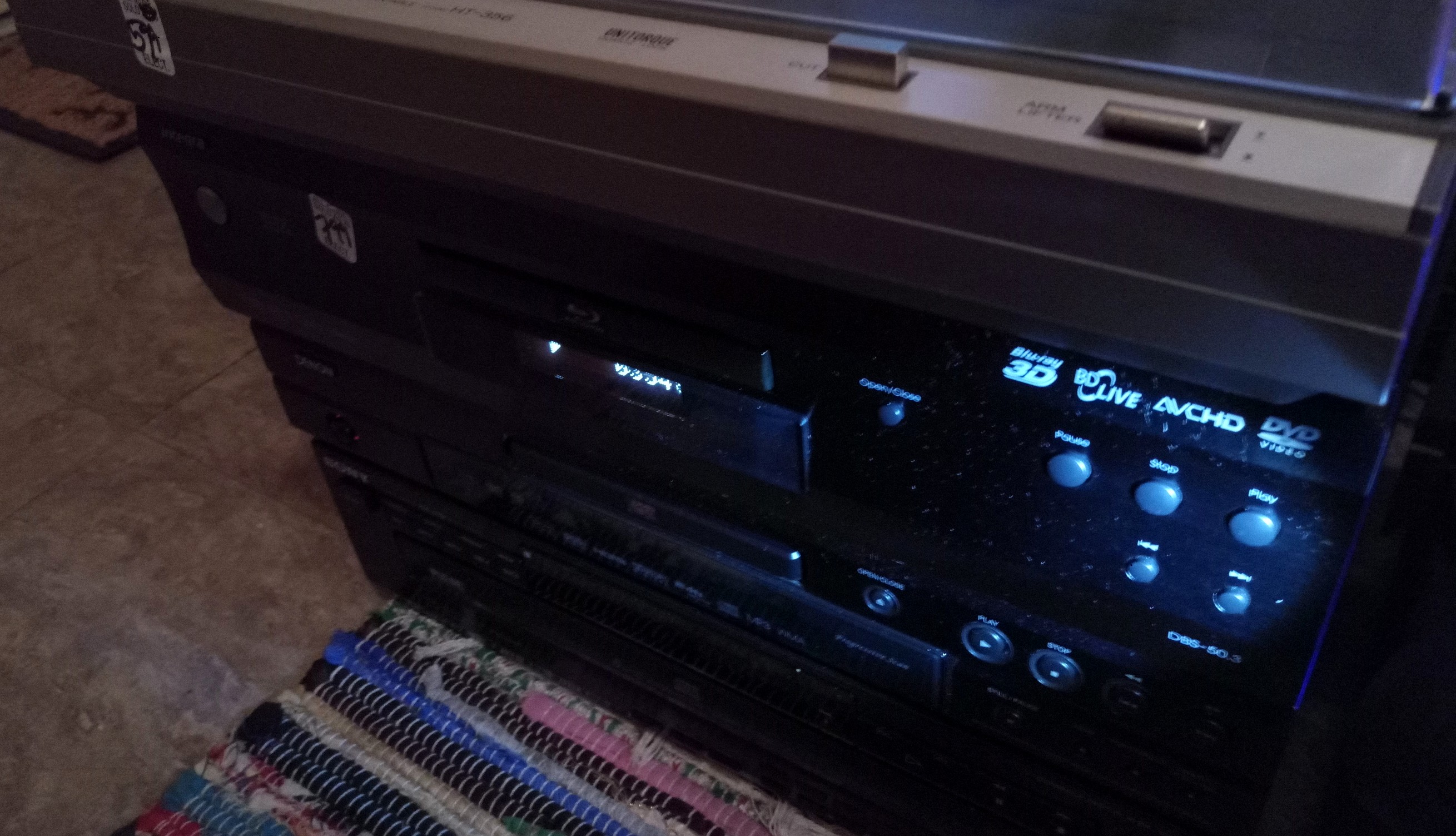

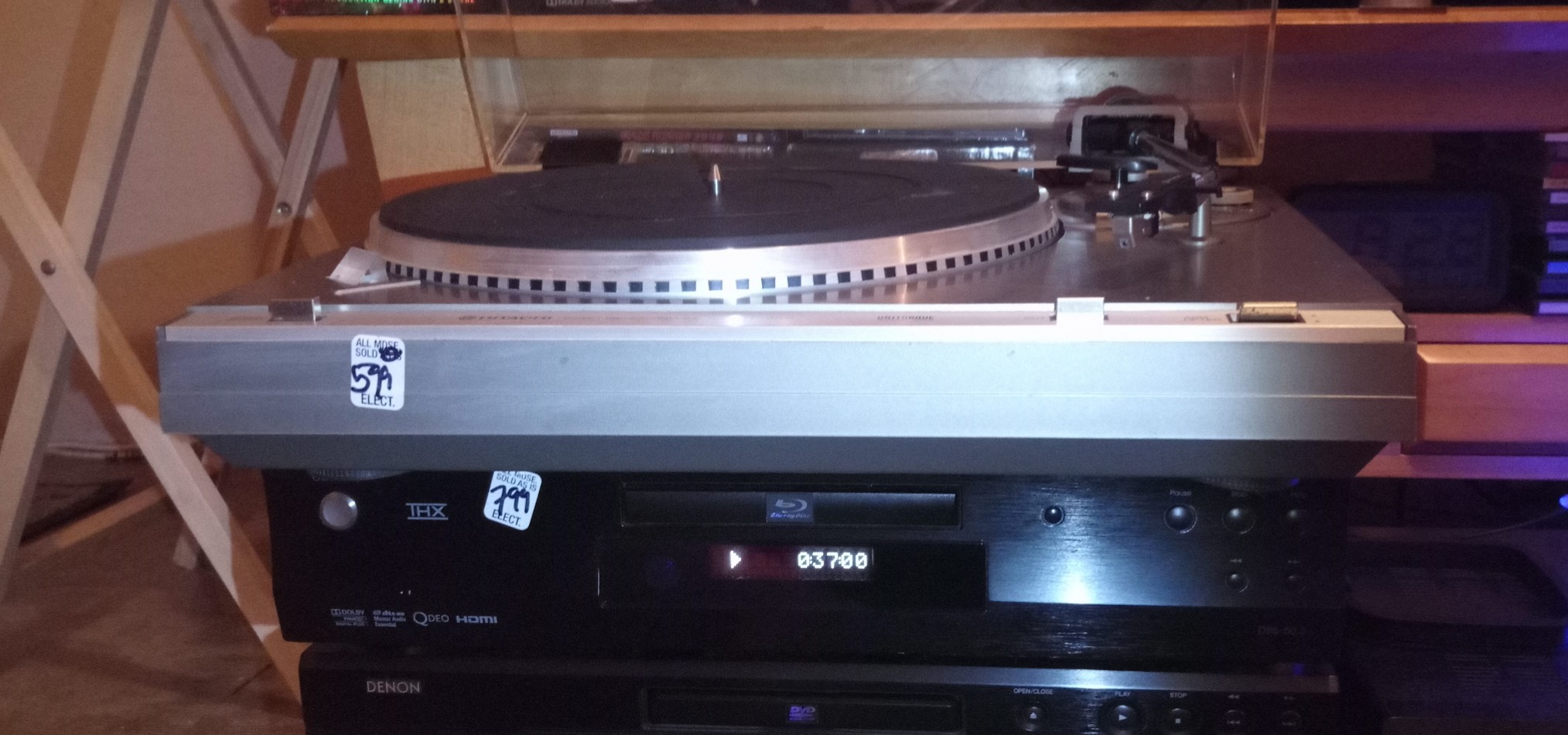

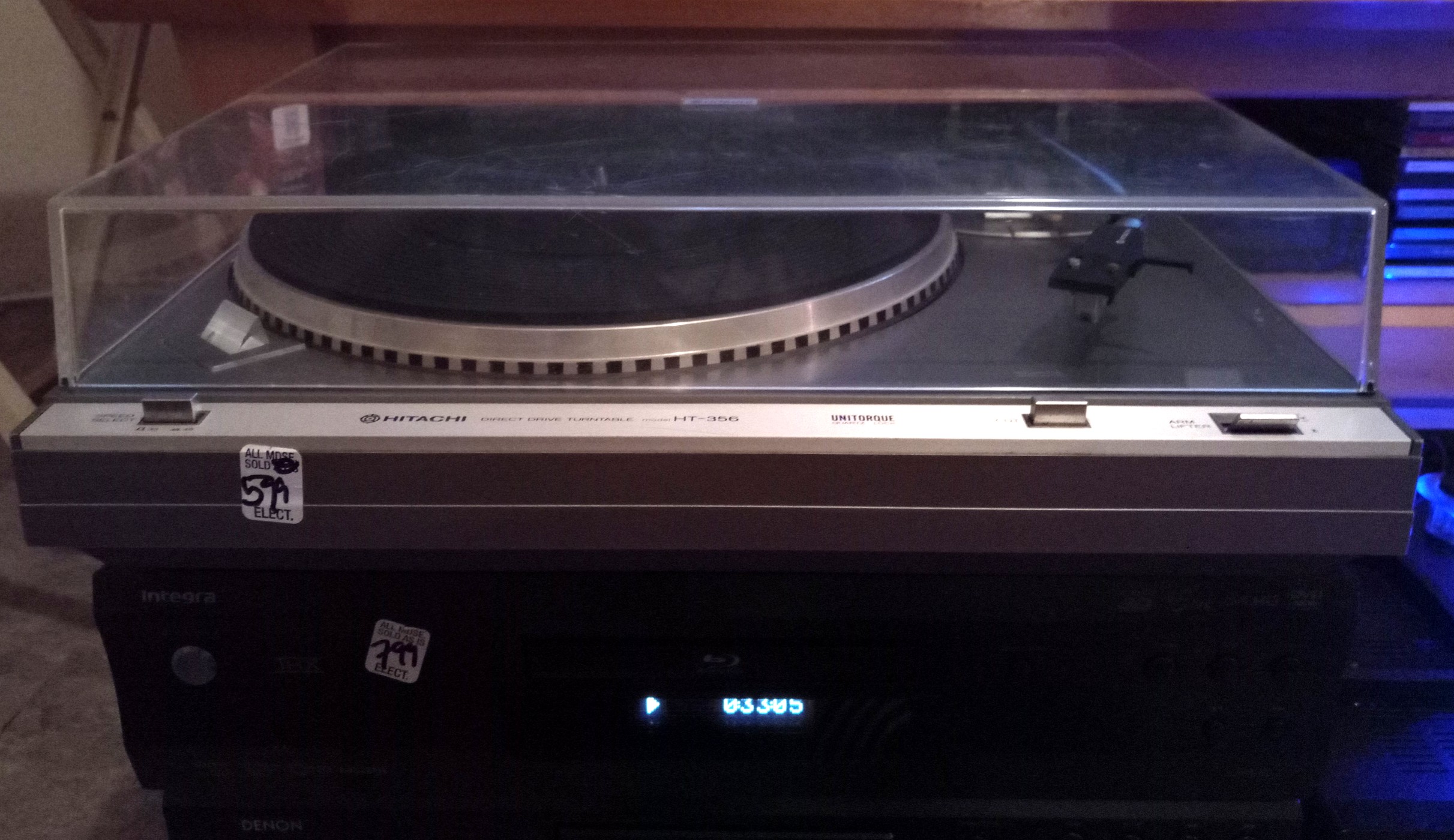

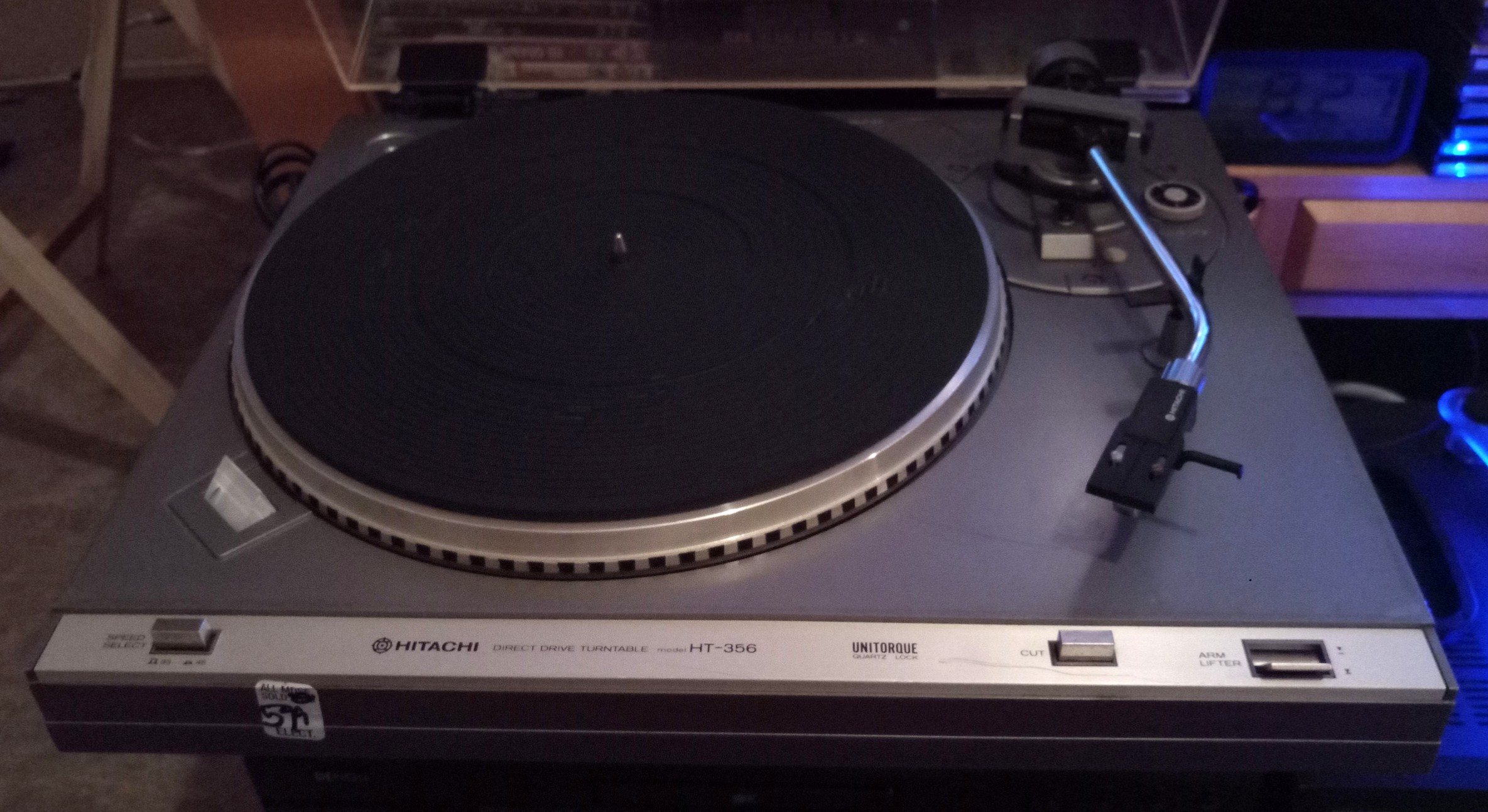

Went to the thrift store and found this Hitachi HT-356($5.99 a couple of hairline scratches) turntable direct drive. What a beauty in person and Integra Bluray player DBS-50.3(minty $7.99 which is a system of its own) matches with my Integra reciever. Waiting on my cartridge will be here tomorrow. Rah :)
My vinyl setup is done! :p
sterling shoote
