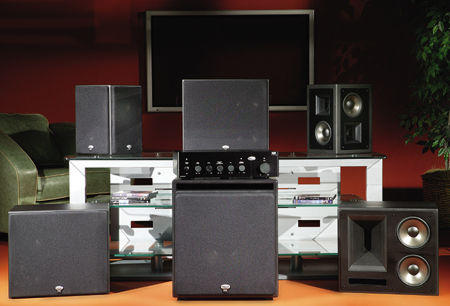

Well, the JVC NX5 and Marantz SR8012 look impressive. But might as well get SR8015, instead of the SR8012.
Those Klipsch speakers look kind of underwhelming in comparison.
If you like Klipsch speakers, might look into their THX Ultra2 speakers and subwoofers. The frequency response of these speakers is incredible - like +/- 0.9dB. :D
Street prices are usually significantly lower than MSRP.
One other thing I would say - for a room that size, I would go with 5.2.4 and free up some funds.

That's a review from 2004, those still available?
They are still listed as available for me as a dealer.
If I were a Klipsch dealer a few years ago, I probably would have gotten those THX speakers along with Salon2, 802D, and all those speakers. But those wild and crazy days are behind me. :D
Interesting, thought they'd be long gone as I've not seen mention of those models in a long while as new gear. Does look like an interesting system altho I'd get a different sub...
I wouldn't buy those Klipsch speakers without listening to them first. I listened to a number of speakers that were recommended and reviewed well here(KEF, Paradigm, Klipsch, Monitor Audio, etc.), and the Klipsch were my least favorite. Out of store available speakers that I listened to, the Paradigm Premiers were my favorite. If you do listen to the Klipsch and like them, the good news is that you'd be fine driving them from just the receiver, they're pretty sensitive. That would free up the money to get you a second sub right off the bat. I also think you'd be just fine with a receiver and the Paradigms and that would still leave you room for a second PB3000.
  • Agree
Reactions: snakeeyes
By the way, I just check the availability of those 650-THX speakers. They are in fact available. Man, if I were in that crazy mode I was in back then, I would be ordering them right now. SUBMIT! :D
As for the THX-1200-SW 12" sub, I like it for several reasons.
1. It's THX Ultra2 certified, so we know it can output to THX Reference level. That's what most people want - for their speakers and subs to play at THX Reference level. 130dB @ 30Hz, 122dB @ 20Hz, 112dB @ 15Hz.
2. They are PASSIVE! Yes! Probably 99% of people have only known powered subs with little plate amps. But I believe passive subs are more reliable. And if the amp ever fails, you can easily replace it with any amp. I know a few guys with multiple $2,000+ subs that have failed amps and drivers. They are just a pain in the a$$ to replace for most people - if those plate amps are still available. So hells yeah, I have converted these guys to 100% Passive subs with external amps! ;)
3. When possible, I prefer to match all my speakers and subs. So if I wanted a Klipsch THX Ultra2 system, I would want all my speakers and subs to be Klipsch THX Ultra2. :D
