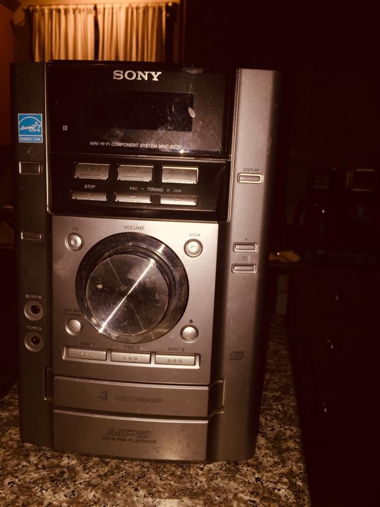

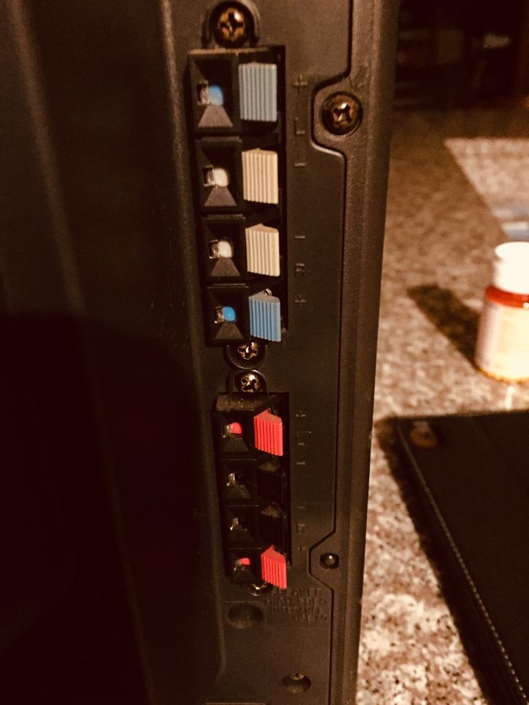

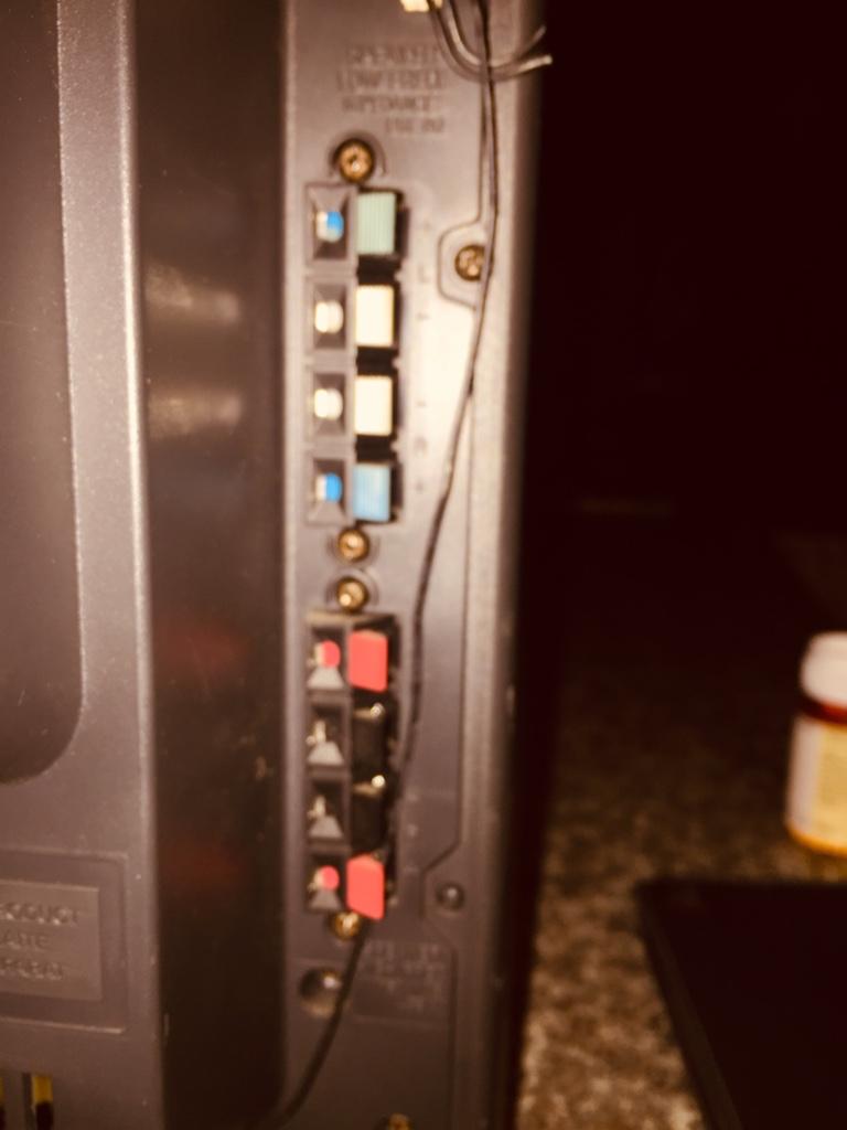

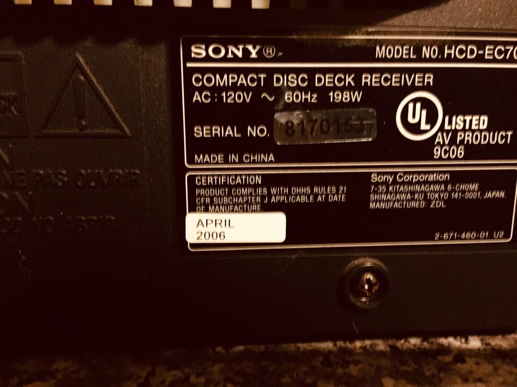

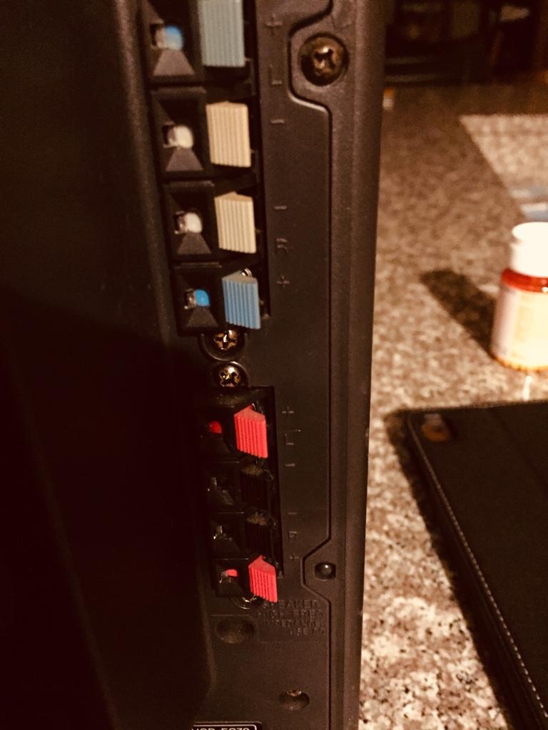

Works well but I need a new cable for radio ... no idea how to ...wire speakers
Do I need to rip my speakers apart for low or high freq or just use 4 speakers ??
How on earth do you do this
You have to find the speakers they were designed for. That was an odd system in a box, that used active crossovers. Unless you have the speakers that came with that unit it is totally useless to you.
Again you have bumbled about, as is your usual modus operandi, and accumulated more junk you have no clue about. You seem to be on a one man mission to degrade this forum into the world's number one red neck forum.
Got me, what did the manual say?
I think the original speakers had bass and treble on separate channels.
Guess I can just mess around with it it’s a lot better then our garage radio ....
I got plenty of speakers to mess with ... just not many good ones .. R.I.P.
As I told you, this device is no use to you. That unit has four power amplifiers, and an active electronic crossover. So the preamp stage goes to an active electronic crossover. The speakers that went with that unit were three way. The electronic crossover has low and high pass filters. The high pass signal was amplified by the HF amps connected to the mid range and tweeter in each speaker via a passive crossover in the speakers. This high pass signal was split into the band pass signal sent to the midrange and the high pass sent to the tweeter by the passive crossover in each speaker.
The low pass signal from the electronic crossover was sent to the bass amps and connected directly to the woofers
The electronic crossover also sent the correct power and frequency slopes to match the woofer and band pass drivers for an even power and frequency response in the crossover region.
That is why that unit is only any good with the matching speakers. If you want to use it you have to look for a set of those speakers. The impedance of the two speaker sections were both six ohms.

This is more effort than I deserve to put into it, but...
The speakers are SS-EC70.

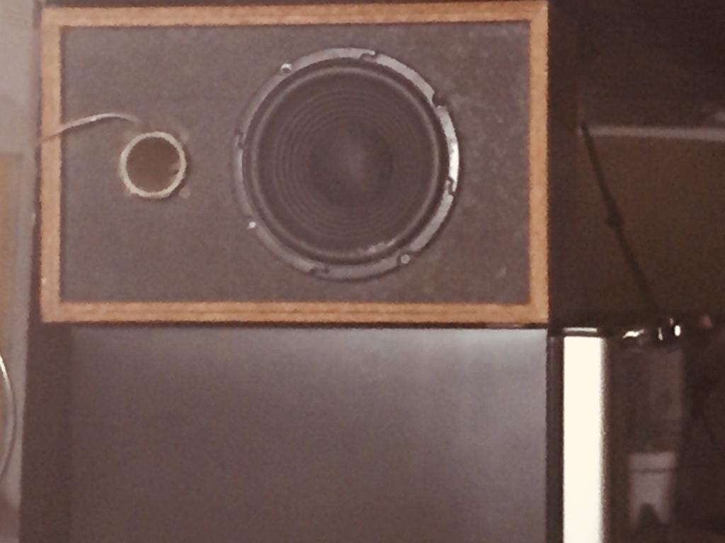

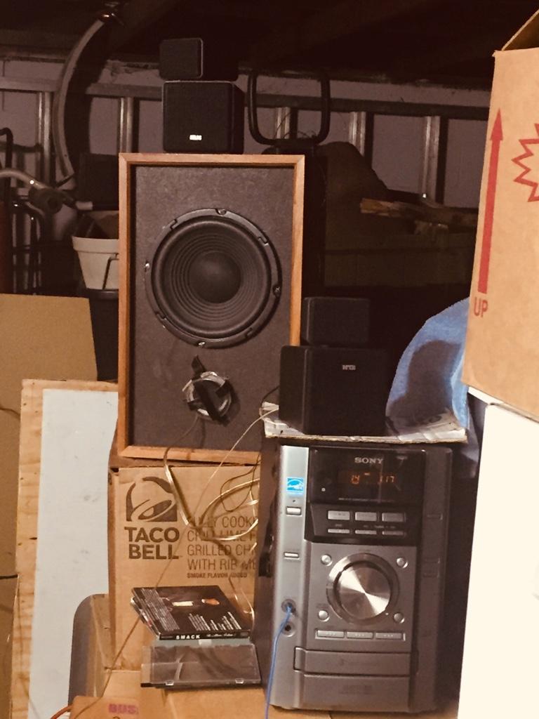

very clear sound but bass is lacking I may try different bass modules or woofers .
Think the woofers aren’t the issue ?
There in mint condition.. barely used . Should I try different ones
Look, unless the top and bottom speakers have exactly the same sensitivities as the speakers that system was designed for it will either lack bass or treble. The chance of you finding junk speakers with the same parameters as the original are one in a million or less.

The taco bell bag really adds to the overall ambience and aesthetic of your system. Lets a person know exactly what to expect in a noob setup. Does it sound as good as it looks tho..?
