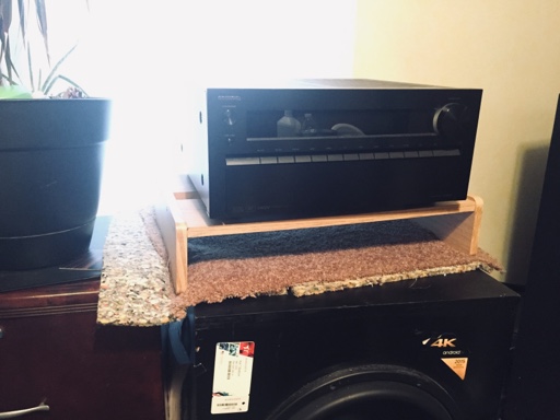

WOUDO WOULD you need carpeting between the pc riser ,? And the sub
You might want to. To test if it makes a difference you can play the sub at listening volume and feel how much the box vibrates. Then you can put the PC riser on the sub and feel how much it vibrates. Then you can put the PC riser on carpet and feel how much it vibrates.

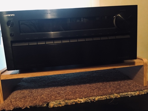

I didn’t plan on putting the receiver on carpet , but are there fans you can add on to keep room dust from building up inside amplifier??
I wanted to put carpet in between the bottom of riser and little pc rack stand tray . The receiver is currently on this rack in my picture.

The way u have it set up now is good. But you can always go the extra mile to put 2 pieces of carpet under the riser

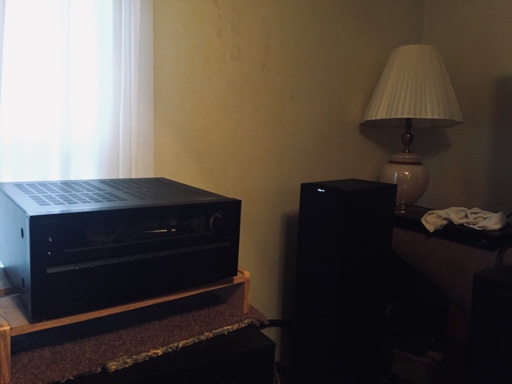

Can you place amp on top of a large subwoofer or will it be damaged by the rattling ? Could you put a metal or wooden board in between them ??
I need to move the amp from its current spot to somewhere else .
I
Wanted to place it were this floorstander speaker is at .
sub shakes the whole room regardless.

Put some equipment on my subs, big flat cabinets, sturdy. I put a movie in with heavy heavy sub tracks, U-571. I watched my equipment move. Had I not paid attention, eeek

Receiver has rubber feet is it bad to plate it ontop of sub instead of a. Iot of stuff in between?

For $17, get these to put under the feet!
Sorbothane is great stuff!
These are sold as washers, but at 1.5" diameter, just put them under the feet of your Onkyo. They also have them being sold as foot pads (without the hole in the middle) but they cost more and don't work any better (as long as your AVR feet are large enough to span the 0.5" hole).
If you do decide on another version, make sure you get the load right! These are rated at 8-14 pounds each (or 32 to 56 pounds using 4 feet). Your 818 weighs 40lb, so you should be good to go.
It won't get rid of every bit of vibration, but it is impressive. After you have set it up, put a glass half full of water on the sub and on top of the AVR to see how much vibration is being reduced by the pads!
