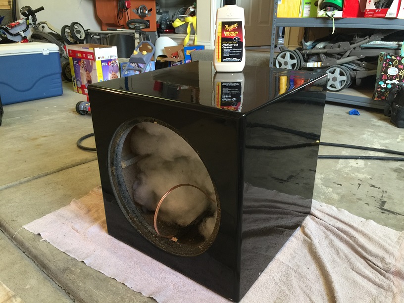

I built a Kawasaki H2 triple, two stroke motorcycle from hell in my bedroom, from a basket case to a show stopper in under a year. Painted it Porsche black metal flake from Imron. The color through the clear coat looked bottomless. It's all in the sanding/prep. The details with the latter is what escapes most people with regard to how their paint comes out. There are some more user friendly techniques out there, albeit with a learning curve.
I painted this boat with a brush and a roller via the "roll and tip" method. You could not tell it had not been sprayed by a pro. The photo does not do it justice. In the event that you're interested in this method, the materials used, I can at least give you direction to some other options.
