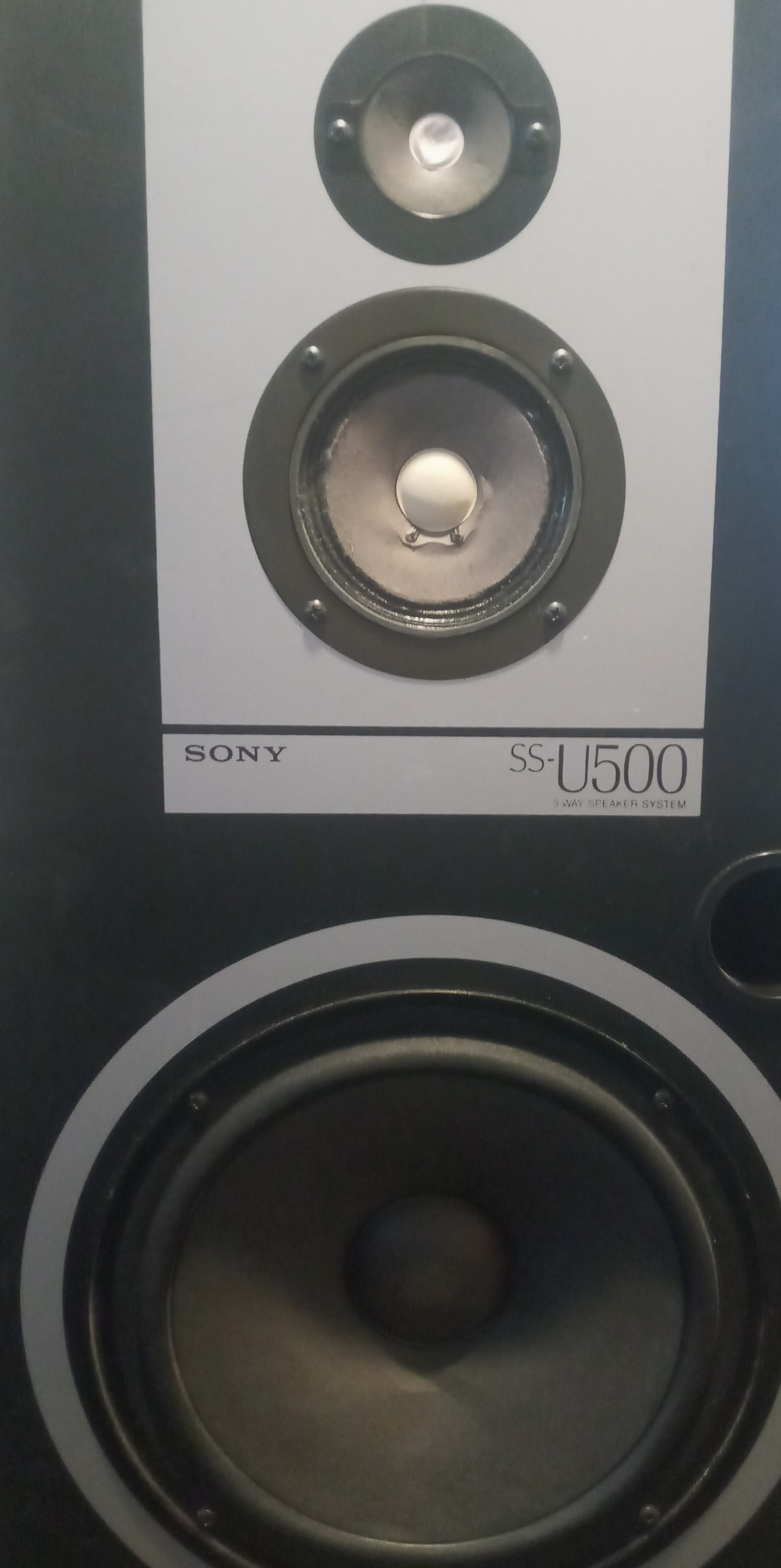

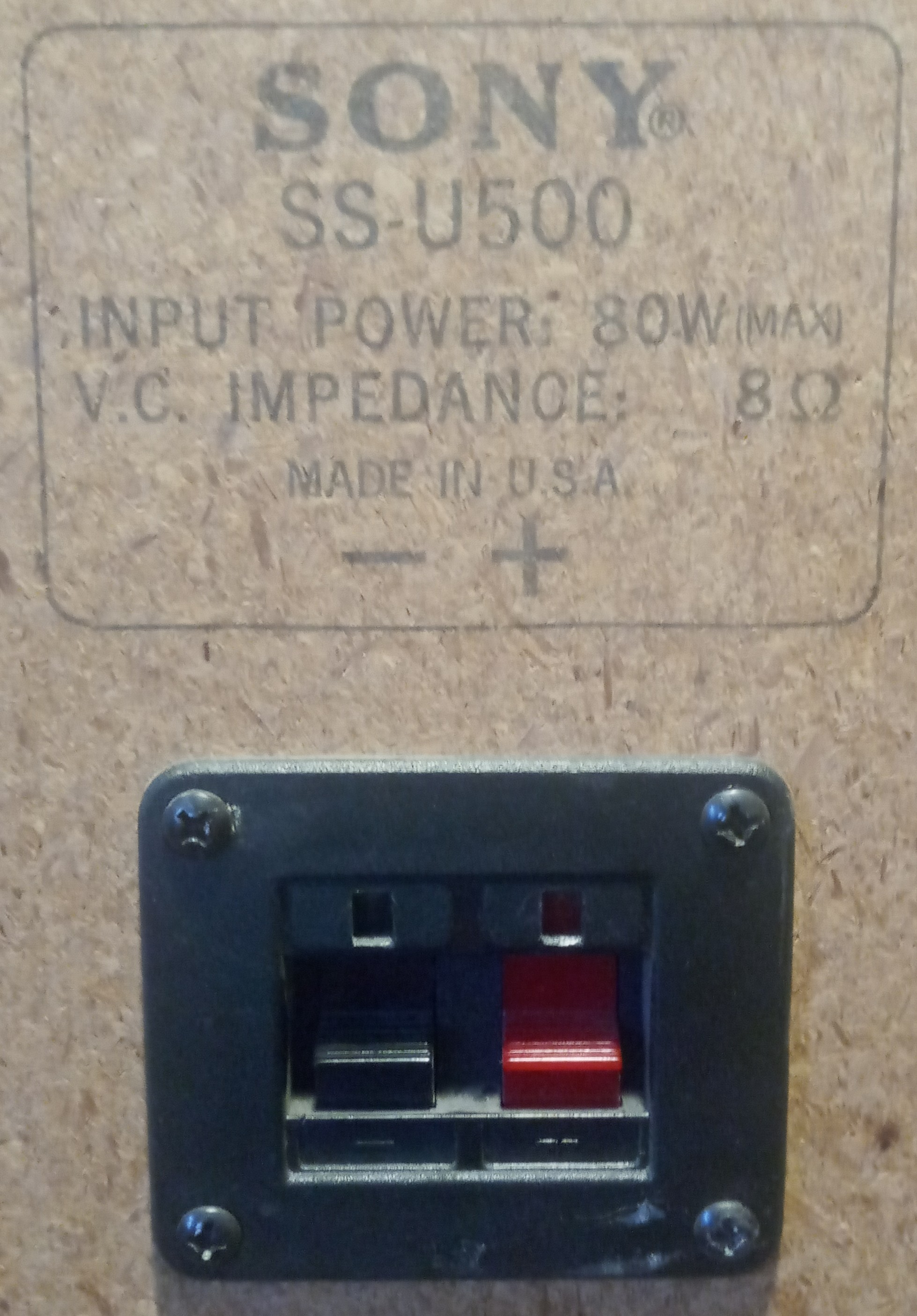

Ok so i have this Sony SS-U500 3 way and was to make it Bluetooth. I dont know how good the audio on it is, not looking for anything crazy. But basically i want to put a Bluetooth apm in it and have its own power plug. Does anyone have any experience with this type of project, i just want to do it for fun and i think it would be cool to bring places sometimes. The back says the max power rating is 80 Watts which does that mean i cant go any higher and if i should worry about that and its 8 olms. You plug the red black wires in the back like a normal speaker i guess. But im very new. Anyway if you have any ideas i would appreciate it20210423_185211~2.jpg20210423_185230~3.jpg

Have you connected and listened to the speaker yet?
In the picture the tweeter appears damaged.

Little more complex than you would think. You can purchase plate amplifiers on Parts Express or Digikey. These are like the amplifiers that come with powered subwoofers. Problem is, music is stereo and you only have one speaker which is mono. You could bridge the inputs to send both signals to one amp and just connect the speakers to one channel for a lark. The other issue is that you will have a hard time finding a plate amp with bluetooth built in, so now you have to find a bluetooth receiver that will output a line level signal to the amp and be able to control the volume. That's going to take some more research and more homework, but the two suppliers I mentioned have a huge parts inventory.

Using a plate amp would complicate things unnecessarily I'd think (lots of cabinet modification alone let alone fitting issues). A small board amp like this is probably more suited in such projects
Mono amp and bluetooth built in. Nice find. I would keep it as cheap as possible. ;)
Don't forget the power supply. A 19V laptop power supply usually works well with these.
