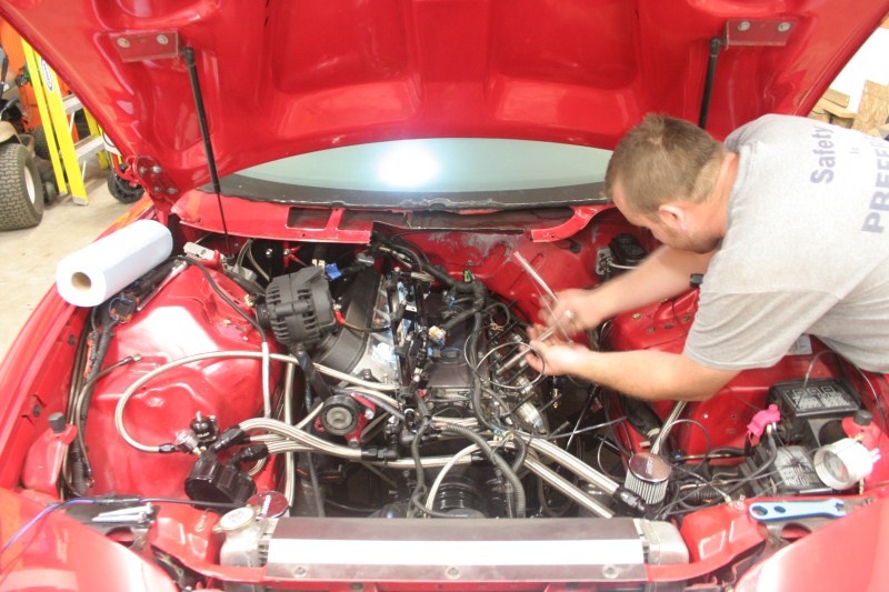

This was a busy/eventful weekend to say the least! As you can see we did indeed get the car running, but that is getting ahead of ourselves. One of the first things this week was my car finally being deemed totaled! So that meant getting a new car, which I was going to put off till Monday since I wanted to work on the TA. For some reason I decided to check out one more car on Friday before going by Chris, and then that led to me buying the car I had looked at earlier in the week. That meant that I was MIA for Friday, and want able to get there till Saturday afternoon. So here is the car I picked up, a 2003 Acura CL Type-S with 71,000 miles.

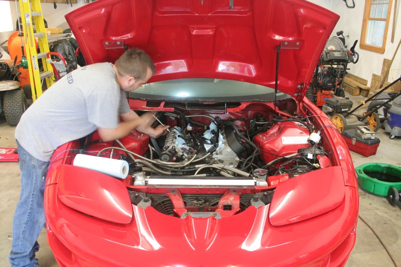

But enough about non TA related things, and on to the good stuff! The work this weekend actually started during the week, when Chris installed the main distribution blocks and wired a few things in. Friday he worked on more wiring, but mainly just crashed (hard to stay motivated on Fridays). Saturday he hit the ground running, determined to get the car running this weekend. Since I wasn't there I didn't get any pics of his handy work, but he finished wiring all of the main power and grounds. While he was wrapping that all up I arrived and started working on the fuel pumps. I had already made the mount for the pumps a few weeks back, but I still needed to mod the upper part of the mount. More or less we removed all of the metal lines that come out of top of the pump mount/tank only leaving one that acts as a vent. Of course that left a bunch of holes that needed to be filled, so I started by welding them all up, and those fumes were no fun. After I had sealed it all up I then drilled for the -8 and -6 bulkhead fittings and installed them. After that was done I wired the pumps together, and then plumbed in the Y block. Here is the finished result!

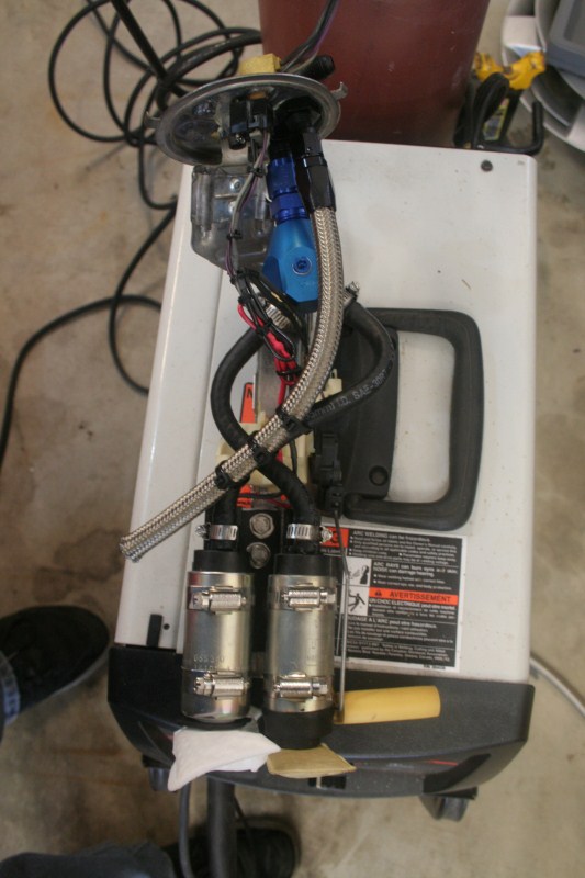

The AN line is just a piece of -6 we threw in there so that the fuel would not dump over the pumps, probably not needed, but what the hell. That is actually the ONLY pic I have of any work Chris and I did all weekend. As you saw in the video above, the car did start and run just fine. There was really no drama in it, which is good. We started by disconnecting the injectors and cranking it to get the oil moving. Once we knew it was then we tried to fire it up, but had no spark. A quick "temp in" of the main harness grounds and that problem was solved. Round two of trying to start told us the coil packs were not right, so we swapped them front to back on both sides and wallah it lit right up!! We are still a long way away from driving, but we needed to hear it come to life.

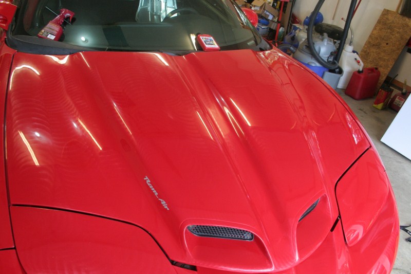

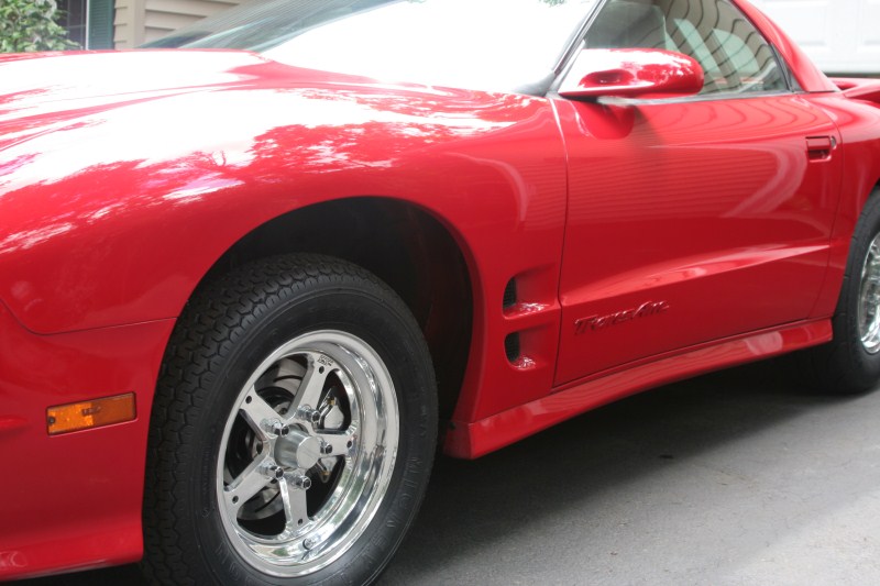

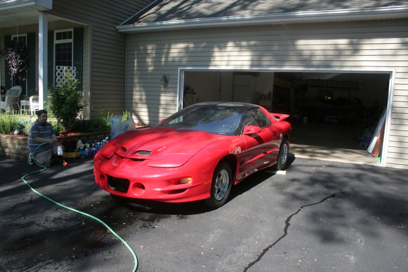

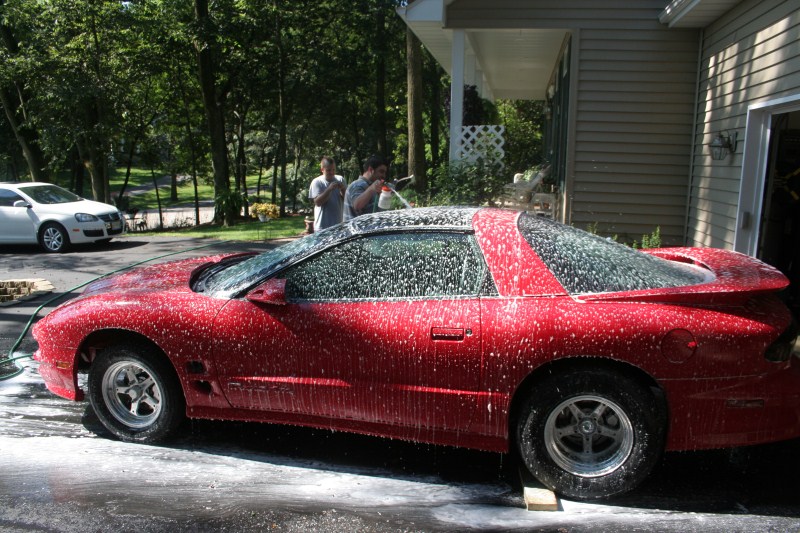

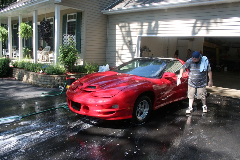

Now on to Sunday, when I actually took some pics...because I wasn't working :) Chris has been wanting to get the car detailed for a while now, and since we are nearing completion he set it up for Sunday morning. David (blue-sun) showed up about 9:30 in the morning, and busted his *** till just about 3:00, and it looked awesome! On with the pics,
Before
Starting the wash
After the wash, and the clay, and the wash, drying it off
Already looks 100 times better

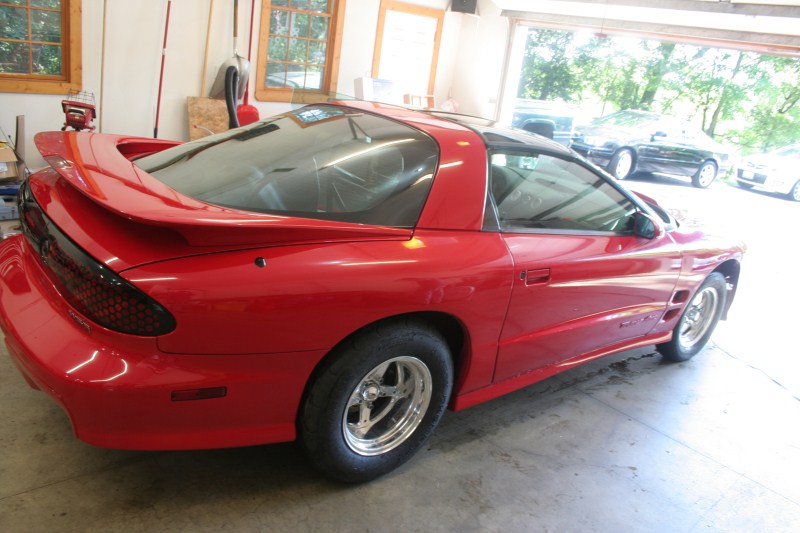

Back in the garage to start the real work
Rowdy S13
Rowdy S13
Polishing
Wax on

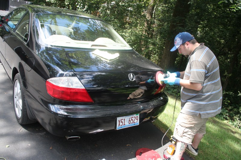

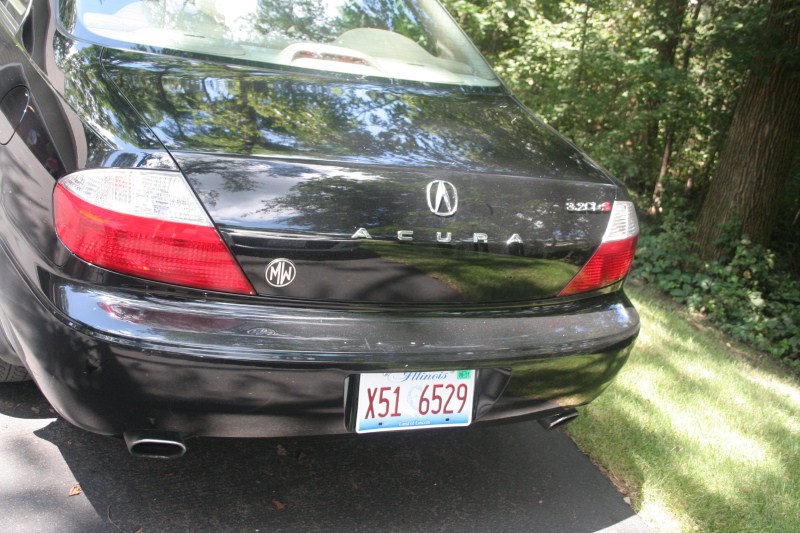

While the wax was setting up on the TA, I stole David away and put him to work on my car :) I generally don't like emblems so they needed to go!
Before
During
After (much better)
Now I just need him to do my whole car, so it can look this nice!!

Well I think you get the idea, it looks GREAT! Anybody in the Chicago land area, looking for a detailer that can come to you I would highly recommend David. Well that is all for this weekend, we should be wrapping up all the odds and ends for the next two weekends or so, then off for an alignment and maybe a tune, then to the track!! We are getting close now!! Thanks for looking!

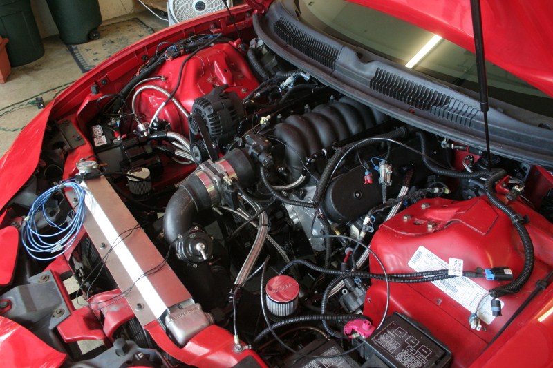

Its not an LS1, and the turbo was on but the intercooler pipe wasnt hooked up for two reasons. First there is no reason when we just wanted to start it and heat cycle it. Second I need to extend the pipe since we no longer have a MAF. Trust me, the car was kinda "temped in" just to start it, there is much more to come. We are going to pull the harness off and remove all the junk we dont need. Actually mount the coil packs, install all of the intercooler piping, wire the water pump and so on and so on. We are a couple weeks away from being "finished" with the car, and then another week or two to get it on the track!

Intercooler piping shouldn't be too bad for you, you jammed that engine way back in there so you should have tons of room to work with unless the bumper is a bear to get off. Are you jamming the intercooler up front and center or putting it on top with a hood cowl?

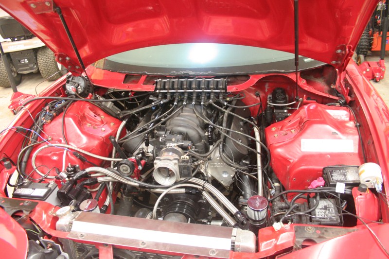

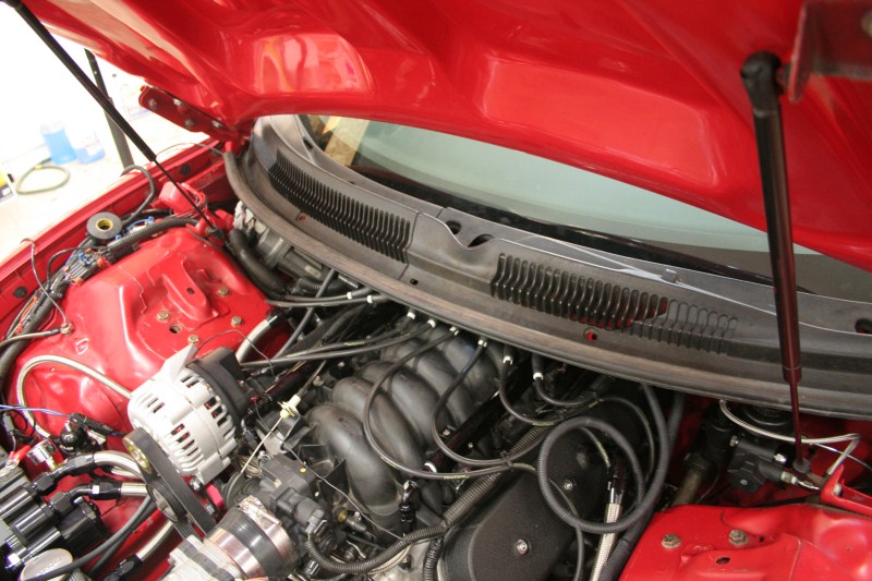

What a crazy weekend! The plan for this weekend was to clean up the wiring, make some coil mounts, and just start wrapping up the loose ends. Well sometimes things don't go as planned. This is basically what it looked like under the hood Friday when we showed up
And this is what it looked like Friday night

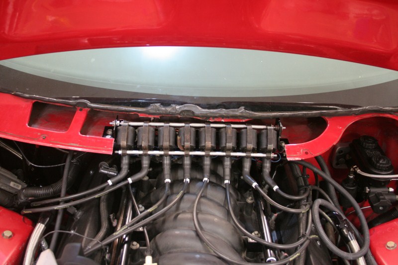

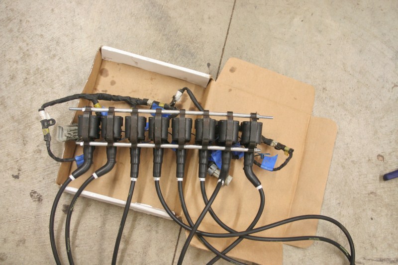

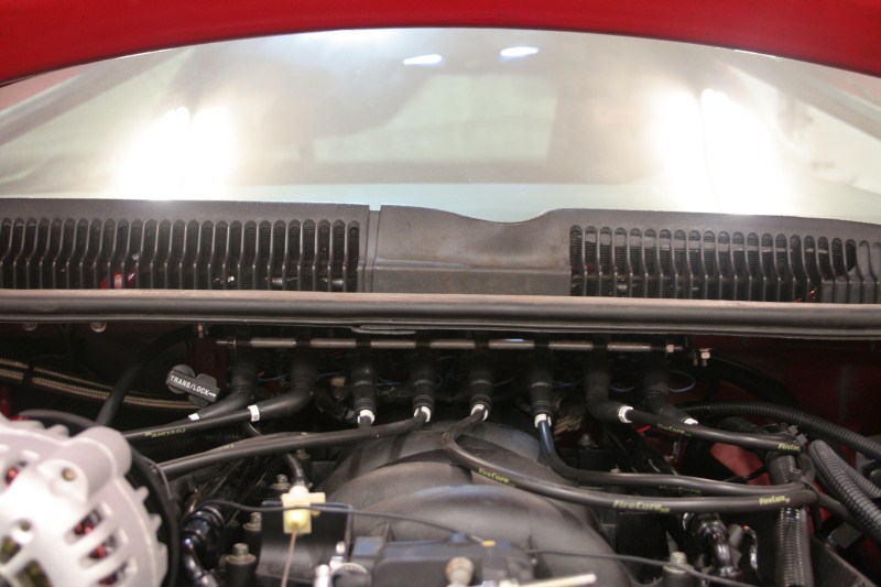

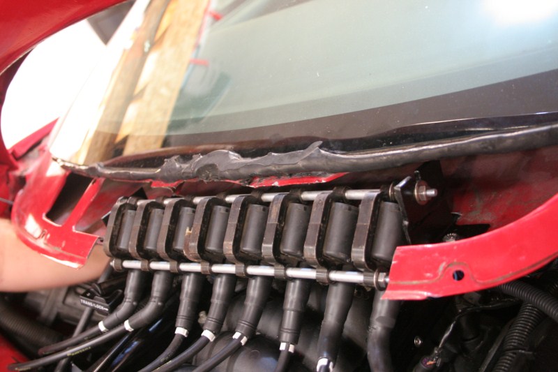

Let me explain how we got to this point real quick. During the week Chris was working on the idle and heard a noise which he thought was a coil rubbing. So Friday, since we had gotten the new plug wires, we made up the coil mounts. The mount is simple, just some 1/4-20 rod with 5/16 aluminum tubing as spacers. The over hang of the top rod sits in some cradles that I whipped up real quick so that the whole assembly is easy to install/remove. That little part came in quite handy more times than we would have like this weekend. Here is the coils mounted to the rods. I did not get a picture of the cradles, but you will be able to see them installed later.

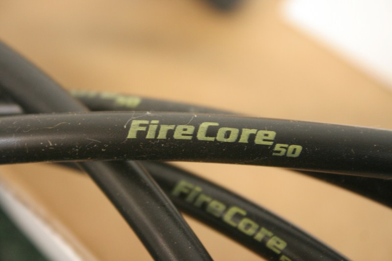

BTW, we are using Fire Core 50 wires that were custom made for us by www.customwiresets.com They have been great to deal with, and are highly recommended.

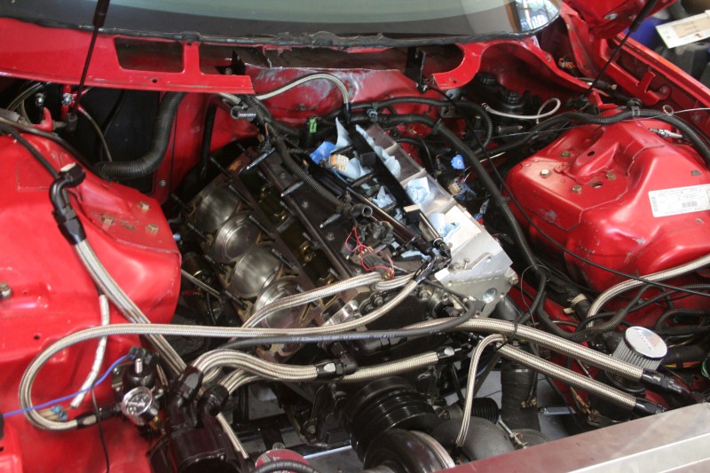

So once we had the coil mount made, we installed them with the new wires and started it up. I heard the noise that Chris was referring to almost immediately. It was not a noise I was happy to hear, a squeak which means that something isn't getting oil. I was hoping it was simple, so we pulled off the valve cover on the driver side and saw some metal flakes by the front most rocker. We then pulled the rockers, and the push rods and cleaned then throughly thinking that oil just wasn't making it up the push rod. Put it all back together and started it up, same noise! So then we knew the head had to come off. Chris suddenly found some energy and was able to get the head off Friday night. Got everything cleaned up, and put the lifters in some oil to soak over night. We did find one piece of metal down by the rear lifters which may have been some of the problem.
Saturday morning Chris get the head back on, and everything re-assembled. While he was working on that I was doing smaller things like running the line for the radiator overflow to the back of the car, extending the upper inter cooler pipe, and final installing the lower inter cooler pipe. So we get it all back together, fire it up.... SAME NOISE but now on the other side. This time we both traded off taking everything apart and pulling the head. We also checked everything out on the driver side to make sure it was doing OK. We got the passenger side head pulled and all of the parts cleaned and soaking early in the afternoon.
In this picture you can see the cradles for the coil packs in the cowl notch.
We took a break while the parts were soaking and tried to make sure we didn't miss anything else before we put it all together. There were a couple of things we checked, but they were all OK, so we put it all back together. While Chris was working on finishing everything up, I was able to get the seat bolted in, and most of the harness installed (I need some parts to install the crotch strap).
This time we got it all back together, started it up, and it was perfect!!! Car sounded great, and was holding an idle at about 800 RPM just fine. We ran it for about 5 min and let it get to full operating temperature. It was a lot of work, but we are more confident about how the valve train is installed, and we caught something that could have been a huge issue, that piece of metal down by the lifter. Here is a quick shot of how it looked when when we were done for the weekend.
We were able to do a few other things this weekend as well. Chris cleaned up the engine harness by removing unneeded connectors, re wrapping parts and so on. Cleaned up the grounds on the main harness as well. We also discovered that the alternator is no good, which is why its juts laying there in the last pic, a new one is on order. We temporarily hooked up the oil pressure gage (seen on the right side) to make sure we had good oil pressure, which we do (around 40 at idle). You will also notice that the MAF is still there in the last pic, even though I extended the upper inter cooler pipe (not installed), that is because we are having a hard time getting it to idle on a speed density tune up. Chris is already working on getting the speed density tune up good to go, so that we can finally get rid of that ugly *** MAF.

That's a pretty interesting coil setup. Man you are stuffing a lot of stuff in that tiny engine bay. Do those strut towers make it had to get to the plugs and get the heads off?
Rowdy S13
Rowdy S13
Thanks I guess on the coil set up :) It will be under the factory plastic piece, so they wont be seen. The shock towers are not in the way persay but they could be further out :) Plug changes are easy, and I dont think they effected much for pulling the heads.

Here is another shot of the coil pack mount that we made last week. Since we didn't have to tear the motor down again we finally mounted it up!
We actually made the hole in the cowl so that we could install the motor, but it was exactly the size needed for the coils! Here is a quick shot of the mount on the car side.
And with the plastic back on
I have to say that it worked out perfect! :)

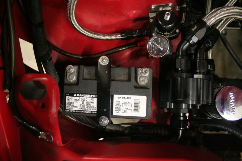

Next up was finishing the battery mount/tie down. This was just a simple set up, as we plan on moving the battery to the back of the car soonish. The bottom of the tray is some 1-1/2" aluminum angle that I notched and bent into a box. Then its just two pieces of flat stock with some 1/4-20 threaded rod to hold the battery down.

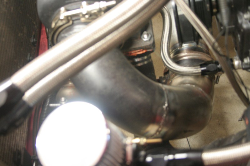

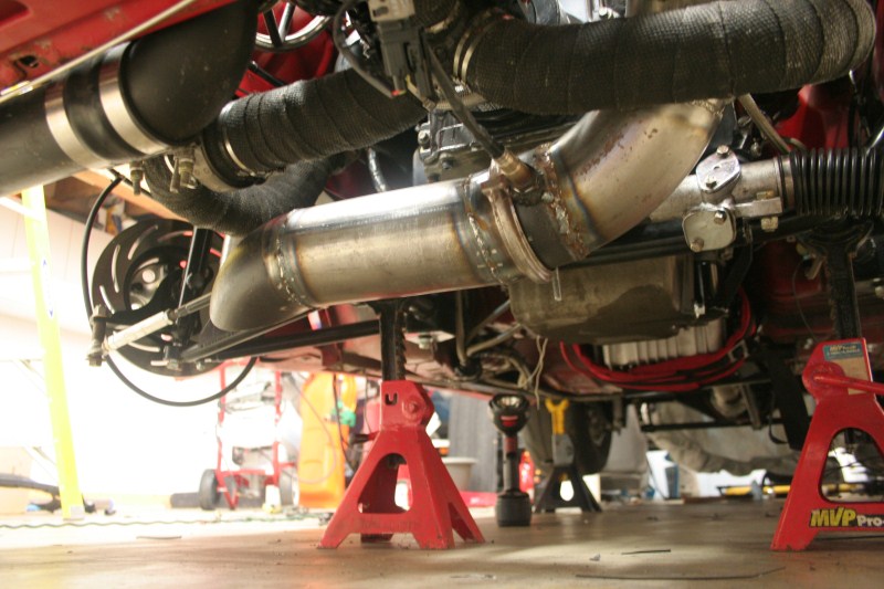

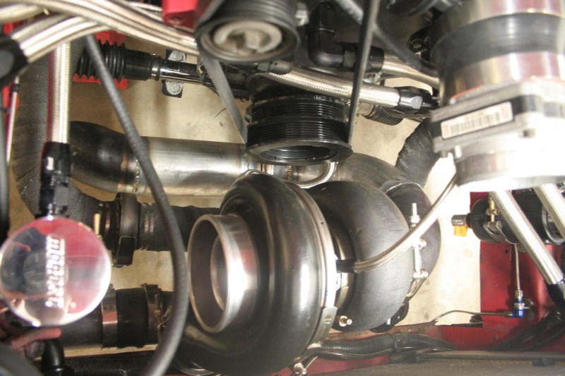

The last thing that that we needed to fab was an "exhaust". This was something that gave us problems last time the car was out. Before we basically had a down pipe which was a very shortened 4" 90 right off of the turbo with a v-band at the end. Right at the edge of the down pipe, about 1/4" from the v-band was our wide band O2, which was fine when the rest of the exhaust was on. Problem was that we had to go under the factory K-member since we had the turbo facing the way we did. Well despite my best effort it was just way to low and we ended up not using it ever. So then the O2 was at the very end of the "exhaust" and did not read very well because one side was more or less open to outside air. So since the turbo is still facing the same way, we still had the same problem, we also didn't have much 4" stuff to work with. The best solution we came up with was to bend the exhaust around to face the passenger side. Now that we had a plan I started cutting and welding, and here is the end result.
Its not the prettiest thing out there, but it does the job. We still need to paint it with some high temp paint, and then wrap it to hide the ugly :). While I was doing that stuff Chris was laboring away on all of the wiring inside the car. He was bent up like a pretzel cutting out un needed wiring, soldering in new stuff and making it all look nice. I would say the hardest stuff is now finished as far as the wiring goes, but there is still more to be done. Once its all done, Ill get some pictures but wiring in process is nothing to look at.
