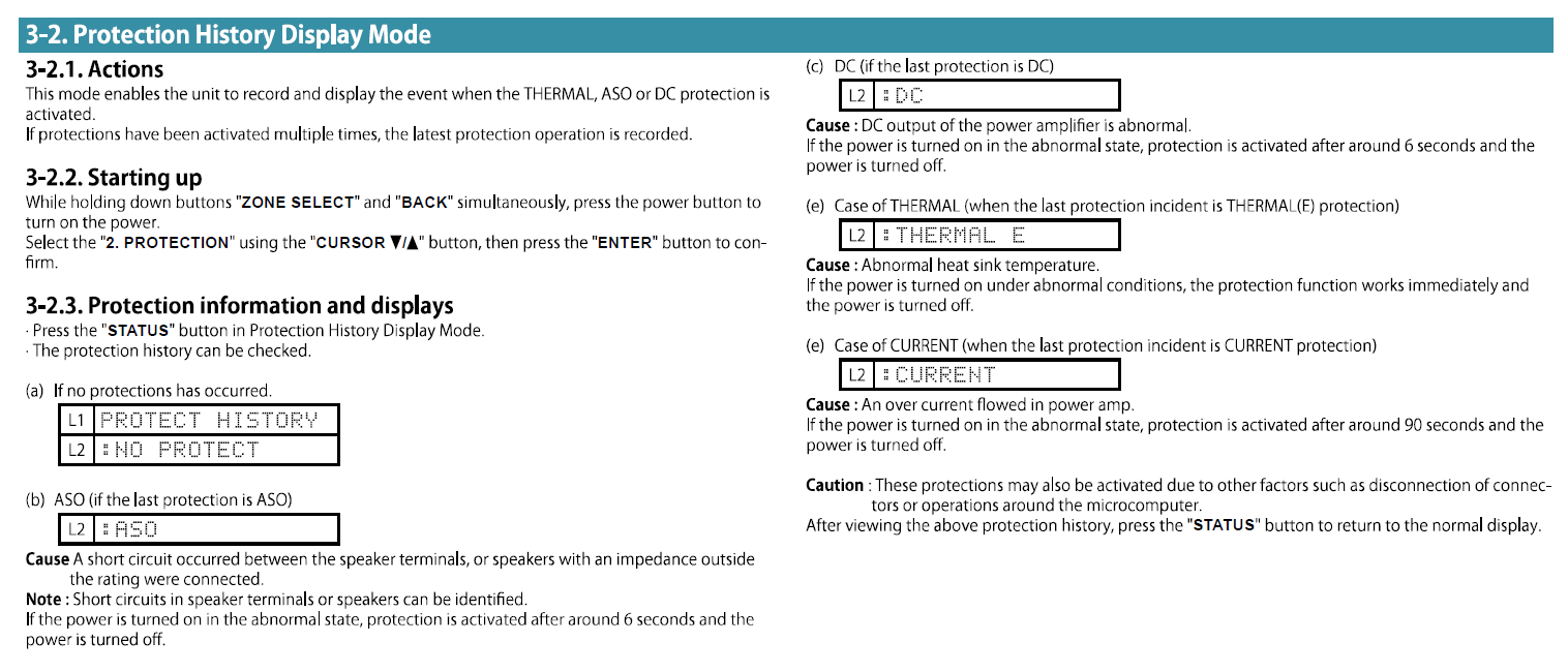

For D+M avrs, the first step is to check the fault code(s) to see what might have happened before it went deal! Should do it before a factory reset, though I believe the fault codes would still be there even after a reset but I am not 100% sure about that.

Here it is, someone found this spreadsheet before:
special mode
See column L
The AVR-4520 is not included in the spreadsheet so you will have to download the service manual and read page 67-68. Depending on the issues you are having, you may have to reference the other pages so it is best to download the service manual (hifiengine.com) when you still can.
For the OP's SR7012:

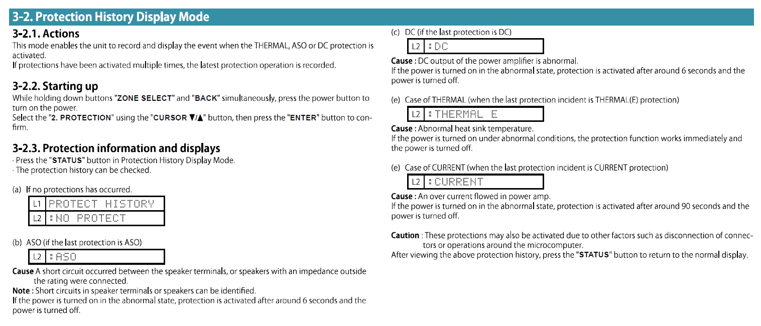

https://www.bing.com/ck/a?!&&p=505d039db94f668aJmltdHM9MTY3MjI3MjAwMCZpZ3VpZD0yMzUxMzdkYS03NTQ4LTY5NzEtMDc0OC0yNTUzNzRlMjY4ZDEmaW5zaWQ9NTMxNw&ptn=3&hsh=3&fclid=235137da-7548-6971-0748-255374e268d1&psq=denon+special+mode+spreadsheet&u=a1aHR0cHM6Ly93d3cubWFyYW50ei5jb20vLS9tZWRpYS9maWxlcy9kb2N1bWVudG1hc3Rlci9tYXJhbnR6bmEvdXMvZGVub25fbWFyYW50el9zZXB0XzIwMjBfcmVzZXRzX3NwZWNpYWxfbW9kZXMueGxzeA&ntb=1
