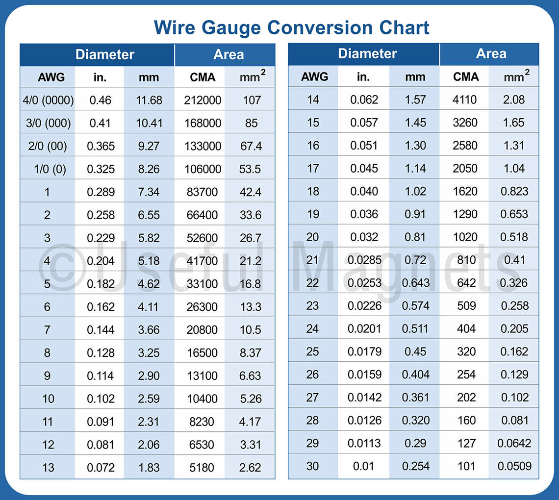

Pictures of your power strip/plugs don't tell me much other than they are different than we use. What country are you in? FWIW this chart covers it both by diameter and area for conversion to AWG.
