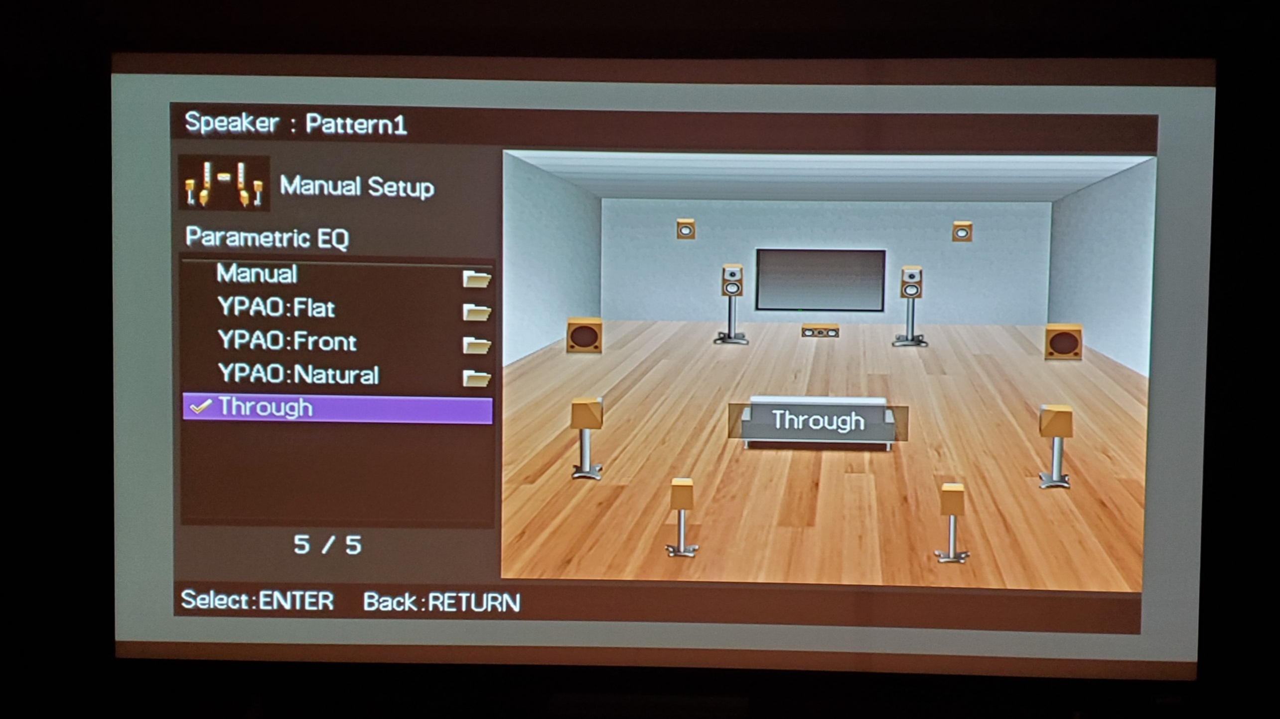

From what I’ve read and have read into the op’s remarks this unit is not calabrated at least with his new equipment installed and may be running on older settings or mabey no calibration as he misplaced his mic . From the looks of his room and gear should sound really good when setup properly .
And yes, for sure setup should be run properly for the best results. That's a biggie too.

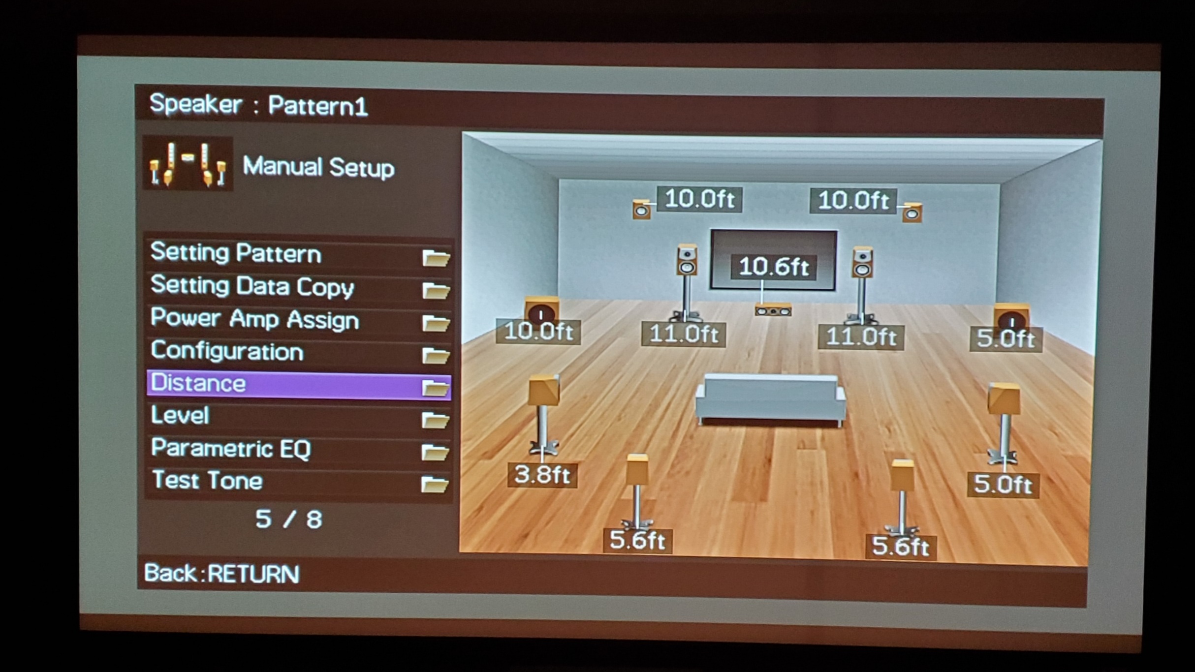

His front mains are running real hot +5 and +7 on the center there’s no way that can be accurate. He’ll see big changes when he gets his mic and does a full blown calibration ypao does two things really well that’s distance ( delays) and levels. He’ll have a sweet room once he gets it dialed in .

I should stop skimming posts because I did miss that he didn't use a mic or run setup...
Still tho, I think comparing a surround mode to an all channel mode is a flawed method. All channel would definitely come across as much louder. Enough of a difference I could see "muffled" being tossed in there to describe the difference. You could be listening to the same sound on 1 speaker vs 9 speakers.

Agreed all channel stereo on any avr would or should sound louder for sure especially running his mains that hot and indeed I can imagine his surrounds sound muffled with them not level matched .
Now with that being said there are settings in Yamaha’s 9 channel that you can set to make it sound Farley good with all channel you can shift the image front to back , raise the height on the center there basically delays there’s two different menus you’ve got to dig threw and then try to understand what Yamaha is saying .
Now if he calabrated this and the two channel has the data he should get a pleasant mix in a surround mode but should not be localized or louder than the front stage pretty much background fill on two channel. Iam really wanting to calabrate this for him lol !

Yup! Lol. I'd love to be there to sort it out. I'm willing to bet a paycheck it's not anything defective tho. I think the whole comparison with all channel needs to be chucked out the window. Run a proper setup and focus on the surround modes.

We’ll you need a decent spl meter and the manual test tone built into the avr you measure the distance with a tape but even that will only get you a basic setup with that avr you really need to use the mic and do a full 8 position calibration with angle measurements as ypao does set things in sound fields that you just can’t calculate or really do by ear when your mic comes give me or any of these guys a yell I’ll be glad to walk you threw it it’s very simple really . With your gear and room it will sound very impressive once do right .

There really isn't a "good" level. It depends on your speaker's sensitivity and how far you sit so the levels can vary. In my room (which is large), at the distance I sit with my current speakers (14.5 feet or 4.4 m), my trim is -1.5 for my mains. When I had the Ultras it was +1.5 because they're not as sensitive. +7 or +8 seems to me (and Mark) is running them pretty hot.
If you haven't run setup at all then all bets are off. I think some units won't work at all right out of the box without running setup, and if you did it for another room before this new one it won't be right either so it's pretty hard to troubleshoot at this point. I know that Audyssey (assuming the same for YPAO) does a very good job with distances and trim levels, even if you don't like the eq'ing, which you can bypass and keep the distance settings.
