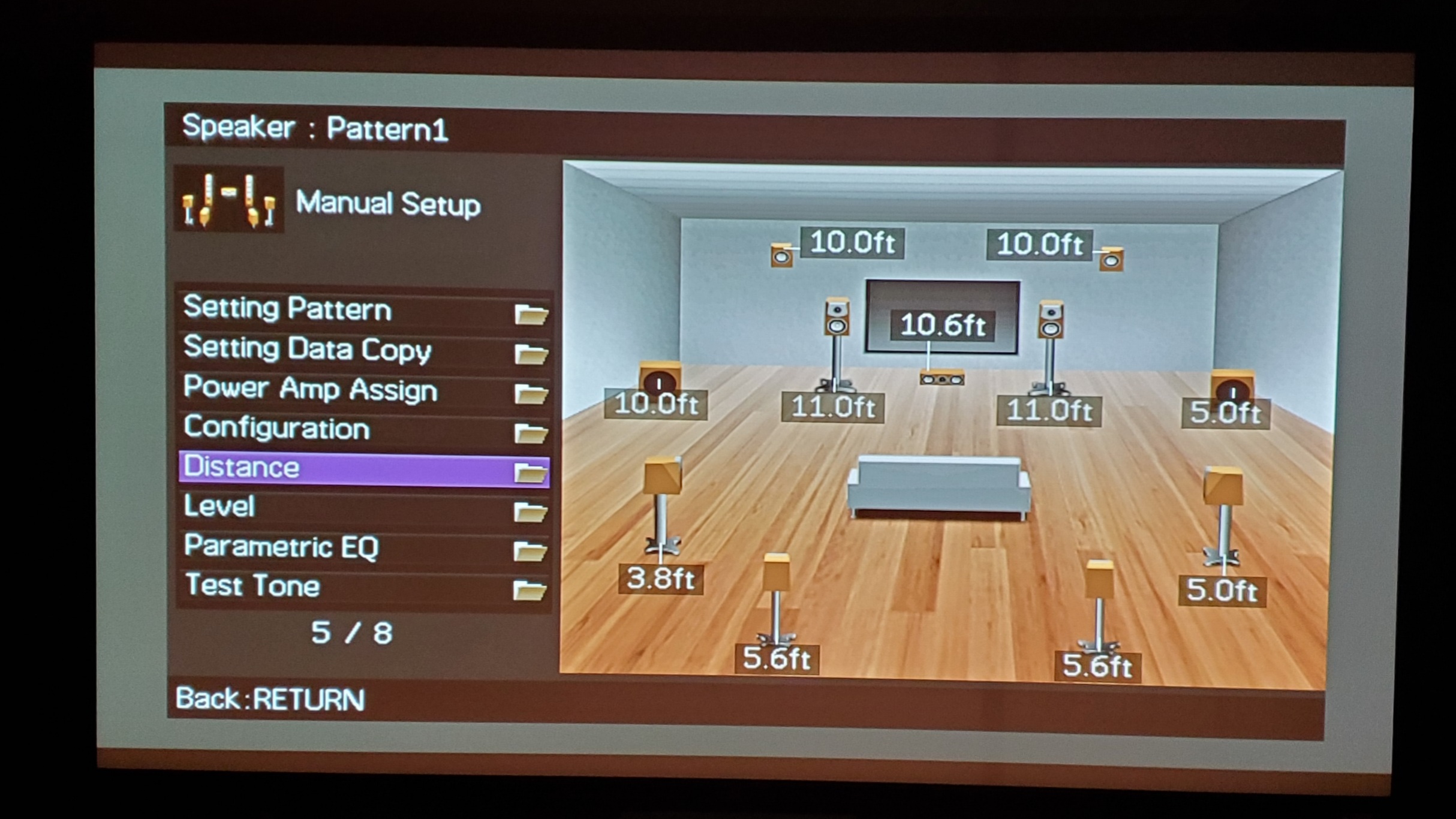

I set the distances for each speaker last night. I'll mess around with the dB levels, the amp assignment, and the EQ tonight and see what that does.

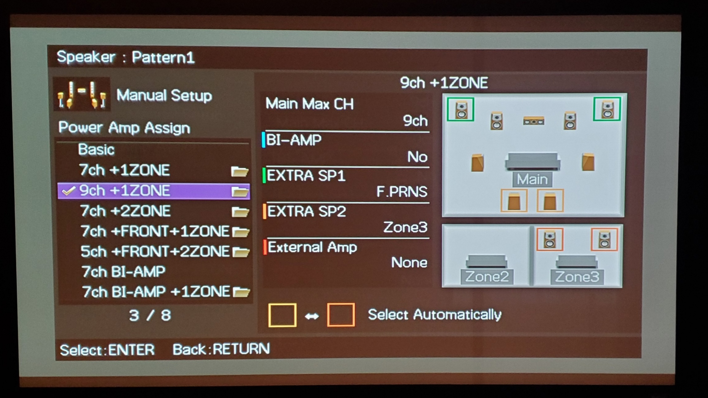

@Mark E. Long : the amp assignment was definitely one of the issues. It was set to 'Basic' (whatever that means). So I turned it to 9 channel. Boom. The rear speakers now work for stereo.

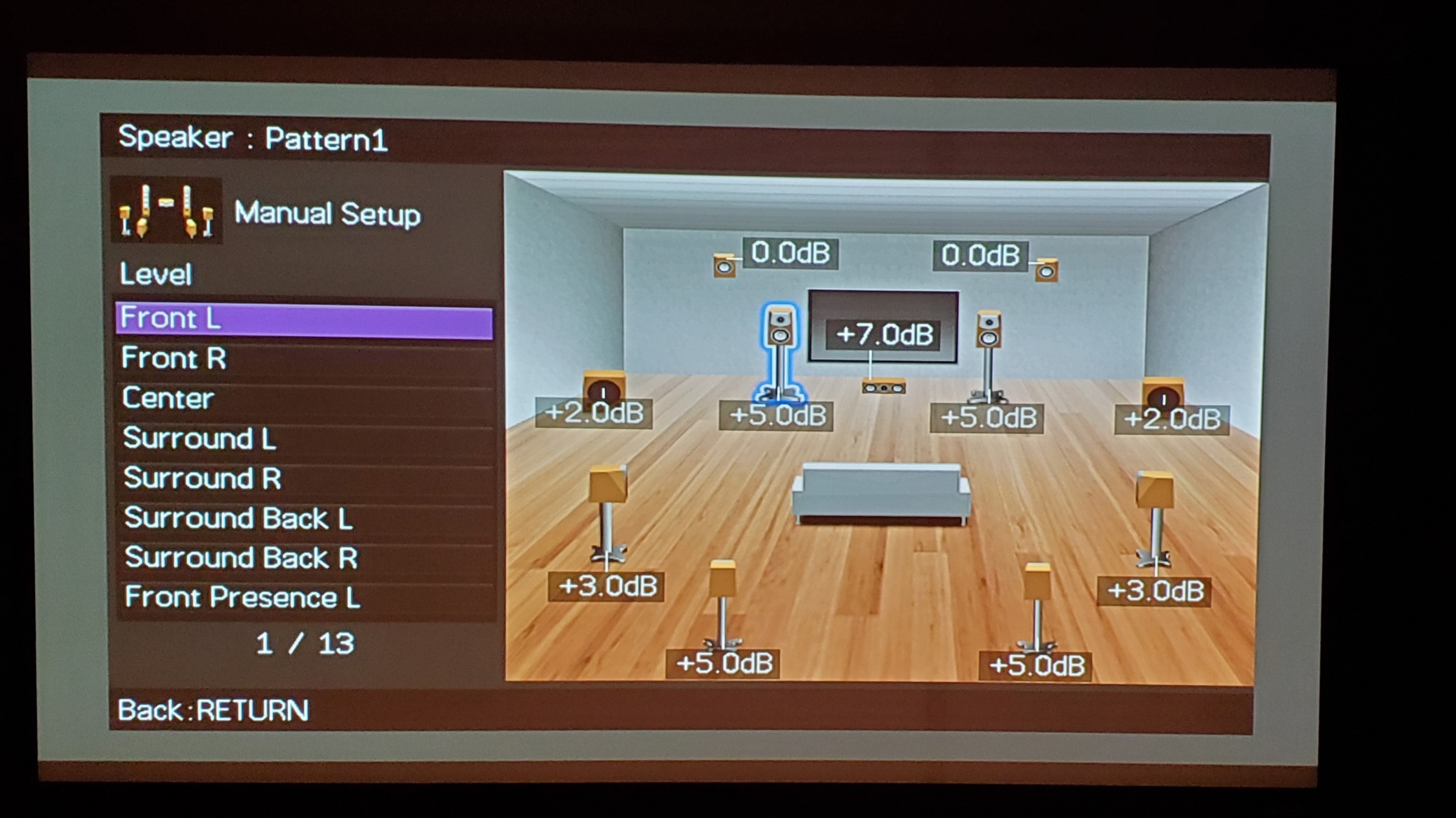

I also turned up the dB to various levels on all of the speakers. Then I turned on the Dolby sound modes. At first I thought it was 'fixed' (it definitely sounded better), then my daughter walked into the HT room and (without me even saying anything to her) asked me why it sounded so (her exact word) "muffled". So I turned it to 9 channel stereo, and she looked at me and said "way better".

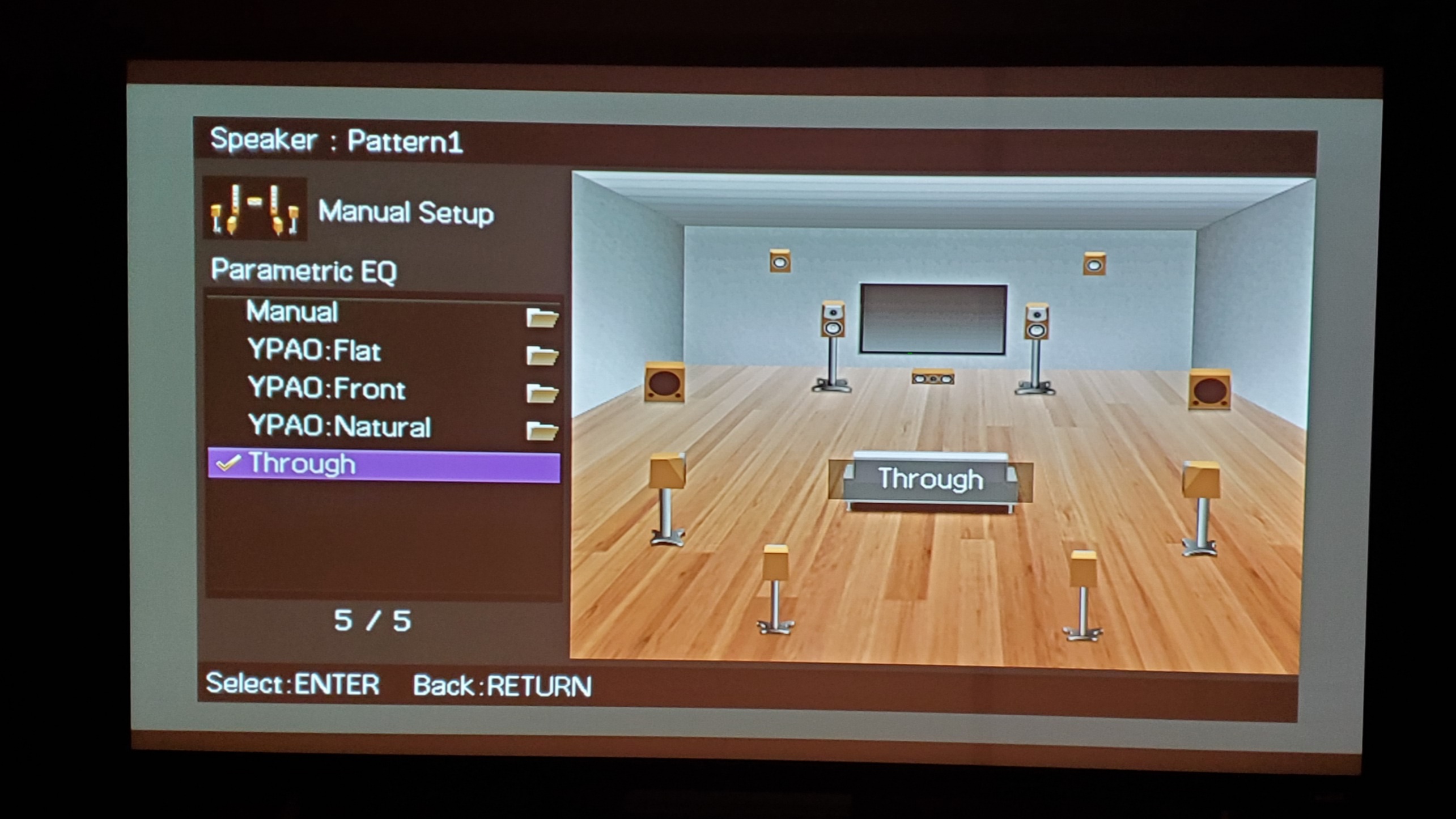

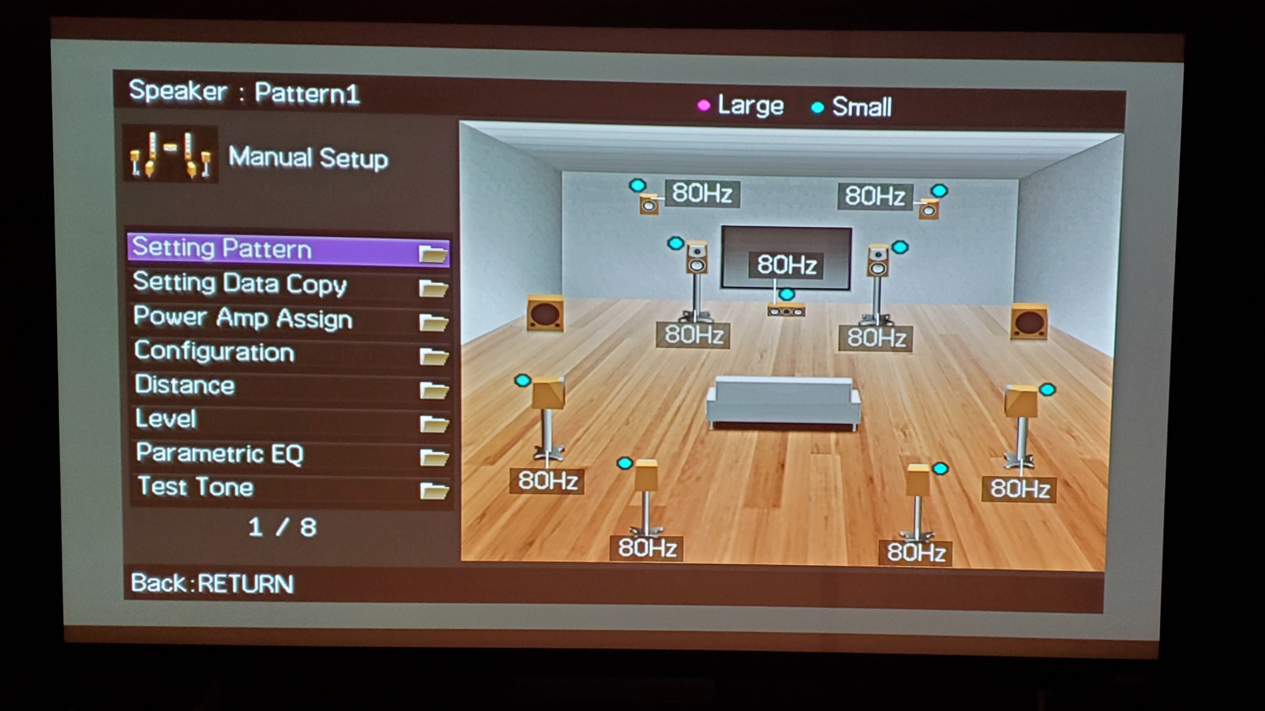

Pictures of my speaker set up on the AVR:
I haven't messed around with the EQ settings yet, nor done a factory reset on the unit.
