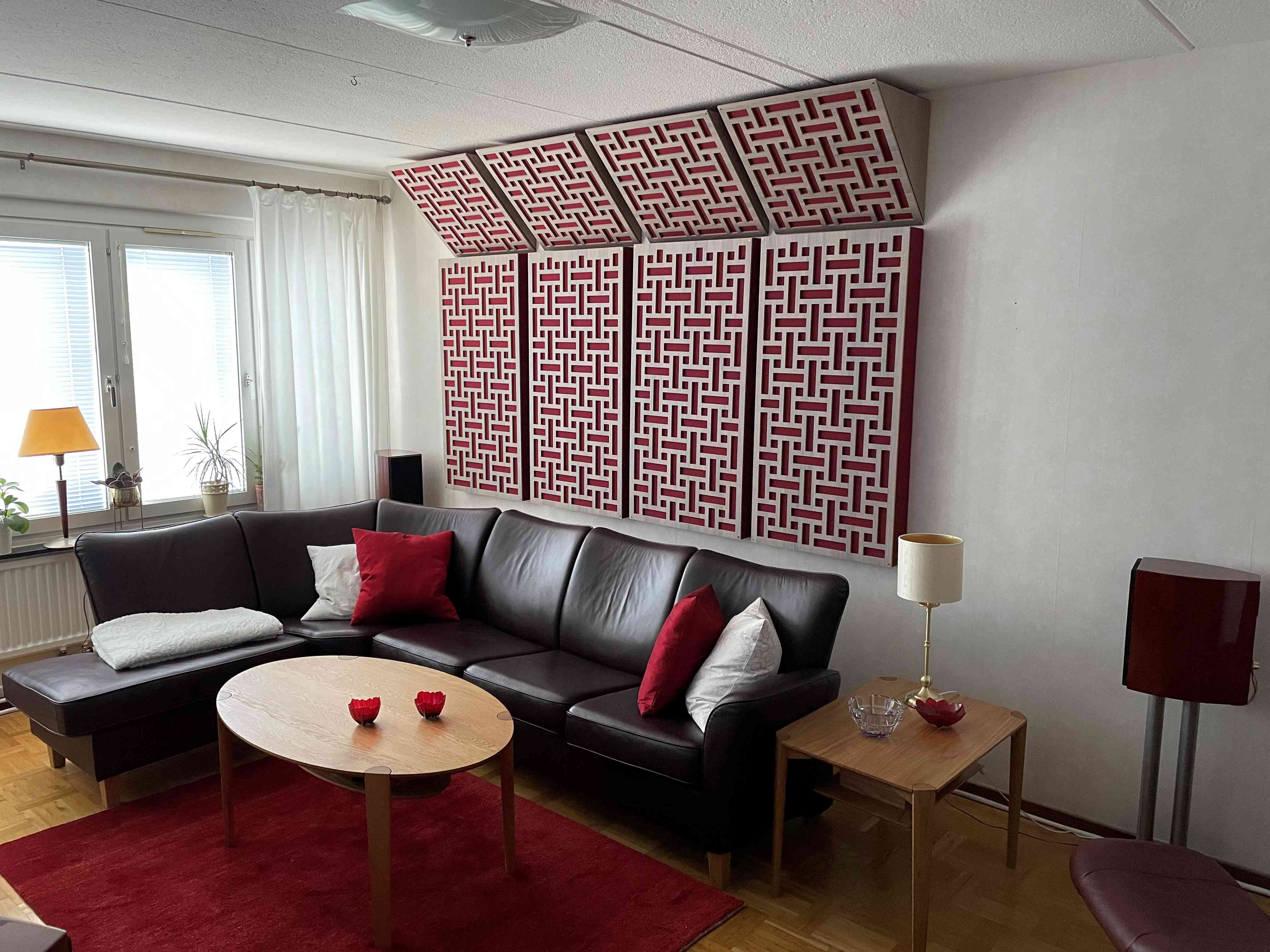

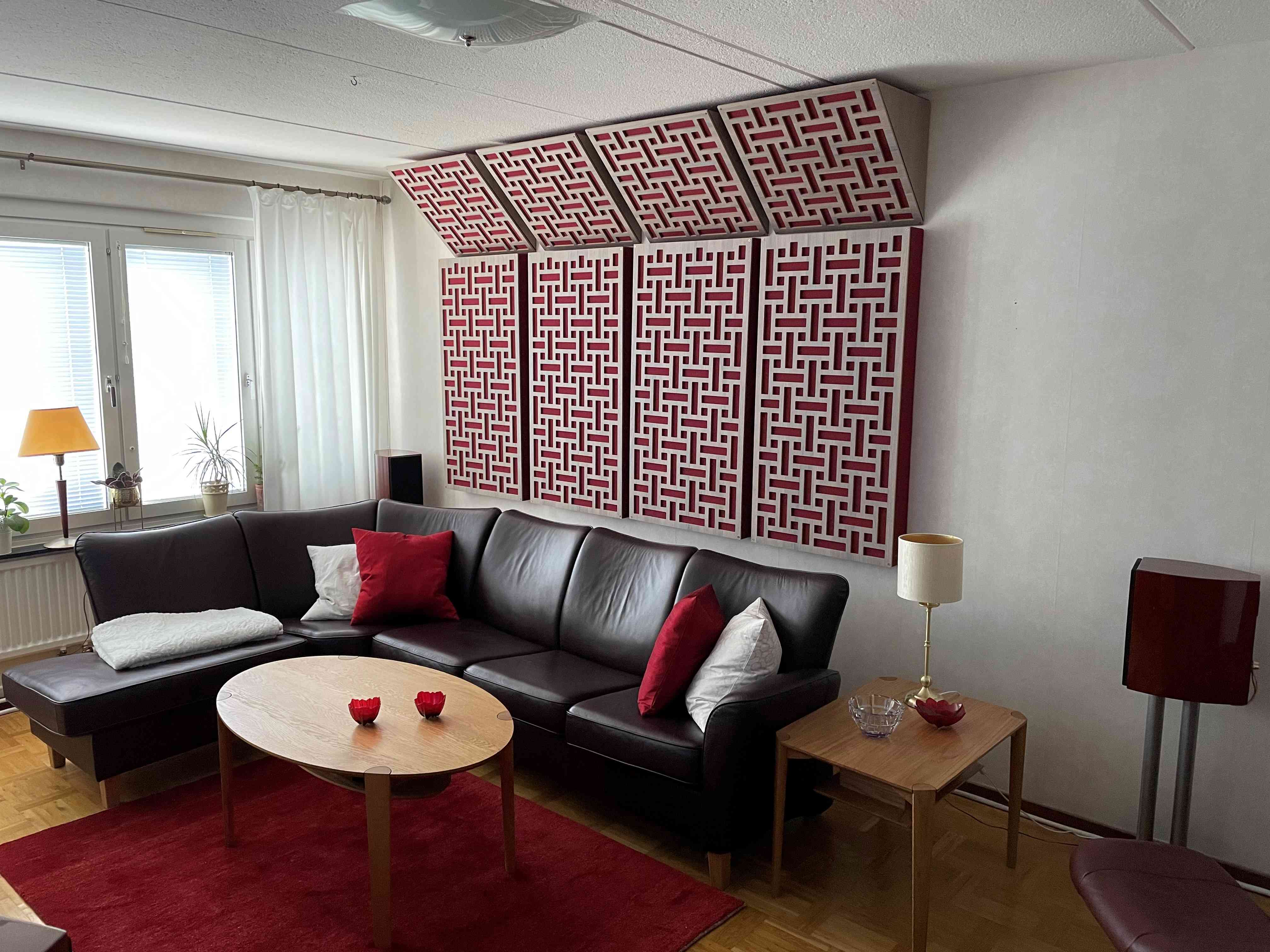

I've added room treatments made by GIK Acoustics (Europe branch) to my small living room/home theatre, and is in the process of adding more panels and bass traps.
The panels are 10 cm (4 inch) thick, except for the corner traps, and all of them have a visible scatter/diffusion plate to avoid over-dampening the upper mid and high frequencies.
Sadly, left and right side walls cannot have room treatments added, and that leaves me with front and back wall as well as the ceiling. Possibly one floor/ceiling corner on the back wall can have tri traps added, otherwise only wall/ceiling corners can be used for treatments.
My room treatments are all from GIK Acoustics (Europe branch)
Front wall room treatments: Coverage ca 26%
Back wall room treatments: Coverage ca 26%
Ceiling treatment: Coverage ca 23% when completed

I've added room treatments made by GIK Acoustics to my small living room/home theatre, and is in the process of adding more panels and bass traps.
The panels are 10 cm (4 inch) thick, except for the corner traps, and all of them have a visible scatter/diffusion plate to avoid over-dampening the high frequencies.
Currently the back wall is complete, the front wall shall have wall/ceiling tri traps added, and the ceiling is not done yet.
When the front wall tri-traps are installed I'll publish some REW measurements.
