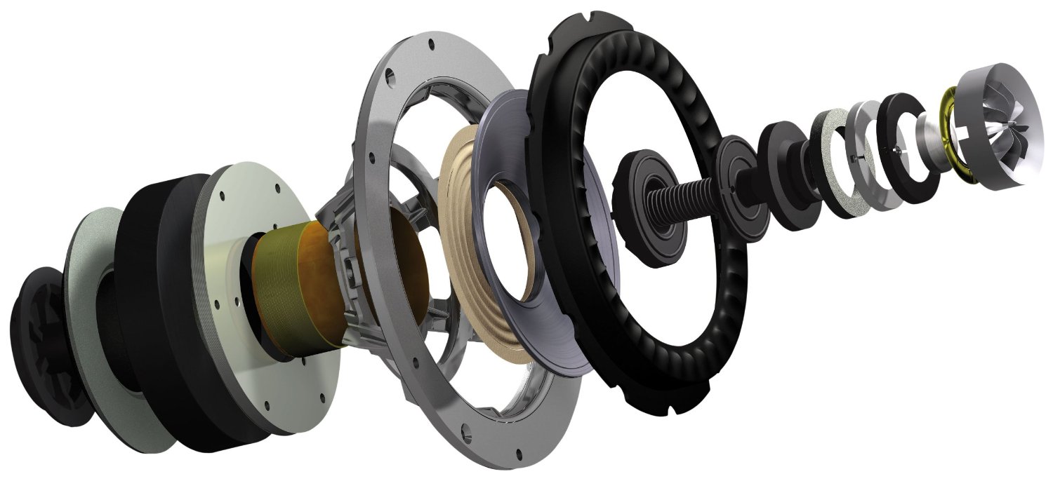

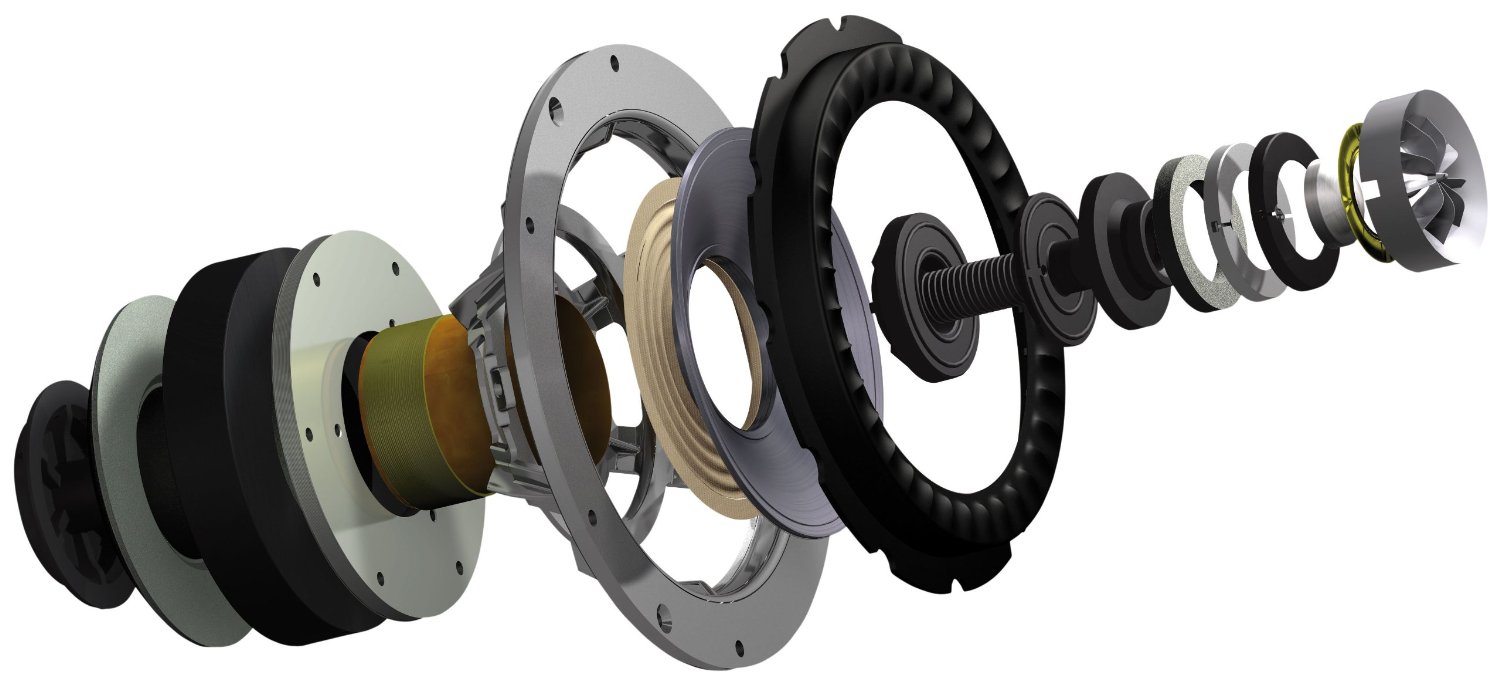

True, but there are only two drivers. The midrange and tweeter are coaxial, so there are only two driver assemblies.
Define driver assemblies? :)
The tweeter has it's own magnet, pole piece, suspension, voice coil, shorting rings (if used in the tweeter..I imagine they are..), etc. As far as I see it, there are 3 separate drivers in the 201/2--which is why I am critical of it's max SPL.
Yeah, I agree there are 3 separate drivers, just implemented differently than non-concentric drivers. And yeah, I would have liked higher sensitivity. But KEF rates the 201/2 at 110dB max SPL. And I don't really listen to THX reference level.
