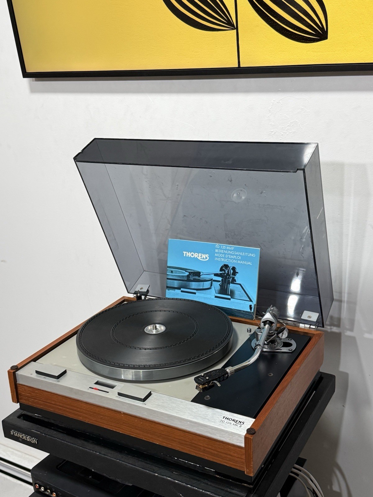

If you are in the mood for another turntable, which is a good idea, as yours is an entry level turntable, it is your lucky day.
This is on eBay now. If you are serious click Buy it now.
The Thorens TD 125, was made in Switzerland under the original ownership. This one has an SME series 2 arm fitted to it.
This would be a massive step up from your current rig, and is a better turntable than pretty much any made today,
If you are serious, jump on this as they don't come up often and especially not with an SME pick up arm.
This is the same rig that is in my Family room, but has an SME series 3 arm. I bought mine really cheap and restored, it. This one looks ready to play as soon as set up.

I just bought it Mark! Says it needs a belt. Looks like those can be had. If you have a couple minutes, please give me a call. I have a couple of questions. It said there were 38 watchers, so I couldn't dilly-dally on it. He has a very good fb profile, so I felt good about it, even if I cannot use it immediately. I hope my cart is a match because he says it needs a stylus and my stylus is brand new. I am excited about this upgrade.
Well Done!
Not sure I like the smoke dust cover. I prefer clear. Replacements are really expensive. Hopefully the scratches will come out. If not, possible cover replacement later. TLS Guy recommended I consider buying an Ortofon Black. Might be doing that hopefully soon. I'd do that before another cover.

What do you mean sort of? The belt decouples all motor vibration from the turntable. The Thorens TD 125 has a superb servo controlled motor with unmatched speed accuracy. It is widely recognized as one of the finest turntables ever produced. Many, if not most were produced without PU arms, and the owner fitted an arm of his choice, which is the case with the OPs purchase and has been fitted with an SME series II arm.
He has purchased a renowned and widely admired classic turntable that will deliver superb performance.
A really good turntable should ideally have cartridge and PU cartridge designed as a unit. In the case of my TD 125 this condition was met.
For optimum results the arm and cartridge should be designed as a functioning unit and designed to work together. It is especially important to match arm resonance to the cartridge compliance.
In the turntable below, SME designed there series 3 arms in cooperation with Shure to match arm resonance and moving arm mass and also provide a silicone fluid damper.
That rig is at the pinnacle of LP reproduction.
