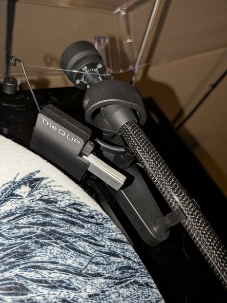

Sometimes, my tonearm lifter or cue, whatever it's called, does not go all the way down when I pull the lever to start an LP. Not referring to the Q-Up lifter. That thing works swimmingly (and only lifts anyway), btw. When that happens, I move the tonearm outside of the record and carefully push it down then when I try again it works fine. Think I should apply some silicone spray with a dropper or a q-tip to that mechanism? The turntable is a Pro-Ject Debut Carbon Evo.

i would not use silicone. I would try and introduce a little light machine oil.

why ? silicone is far more benign, especially if plastics are involved, correct ?
How about WD40? I have some 3 in 1 oil, WD40 and silicone. Haven't lubed it with anything yet.

Silicone is far more benign than WD40 ! WD40 will absolutely eat certain plastics, I know and yes I found out the hard way !

The trouble with silicone is it returns to silica over time and leaves a sticky dust. Two of my least favorite lubricants are silicone and WD 40.
What I do in these cases is to put a little light cycle oil on a thin feeler gauge and getley pass it either side, and I get good results
Todd I do have some oil specially for turntable lubrication, but in your case I thick light oil will do the trick without any long term bad effects.
I'd ask ProJect for their recommendation (especially if under warranty). FWIW I use a synthetic bearing oil on my Technics (Anderol 465) but never applied to cueing mechanism.

I have 3 in 1, which, I think is pretty light duty stuff. Even better I have one of those tiny bottles of oil you get with a beard trimmer. There is a spot to lube the mechanism, but it's real tiny. No room to touch a feeler gauge to it, let alone a q-tip. I think the tip of the beard trimmer oil bottle will get in there where I can add a drop or even less. If not I suppose I could try to get the point of a toothpick wet enough and dab it in there.

The ultra-light beard trimmer lube did the trick. Thx!

The tiny bit of oil I applied last weekend worked itself in to the point that now I have to control the lever or it goes down too fast. Here I thought I had a dampened cue. It never was dampened, it was just sticking. This is far better so that the tonearm isn't resting on the lifter whilst a record is playing.

Might need to rebuild the cuing hydraulic piston?

Cuiing arms were a fairly regular repair in the '70s and '80s- they were assembled, so they can be disassembled and cleaned. The problem- did it use damping fluid, or just light friction?
Why replace the whole turntable if the cuiing is aftermarket? Have you contacted Q-UP? If they can't help and you want to try another brand, many are available and they don't need to be expensive.
