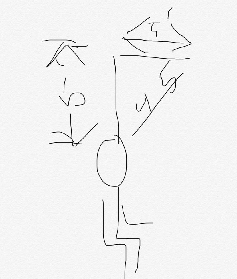

Your drawing makes sense. You mentioned top front would be not recommended, would moving it closer to sitting position. It would be 6’ apart from overhead speaker and 2’ away from LCR.

Just for clarity. I would recommend TOP front, but not front height(on the wall). Unless using rear height as well. At least that way, you will get some front to rear panning, and some overhead sounds.
FWIW, I don’t trust a lot of “stereo shops” anymore. Many of them seem to be stuck in the pre atmos days.
I’m only slightly familiar with home theater gurus per AVS and some threads there. From memory, they have pointed out that the lines shown overhead are NOT indicating to place overhead speakers in line with the mains. I agree with that as the whole point of overhead speakers in an Atmos configuration is based on angles. IF they line up, then great. But many won’t. I also seem to recall they use angles that start from different points than Dolby. And that makes it confusing.
