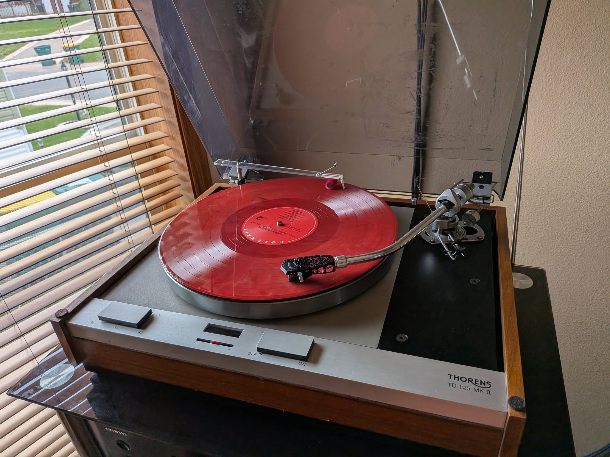

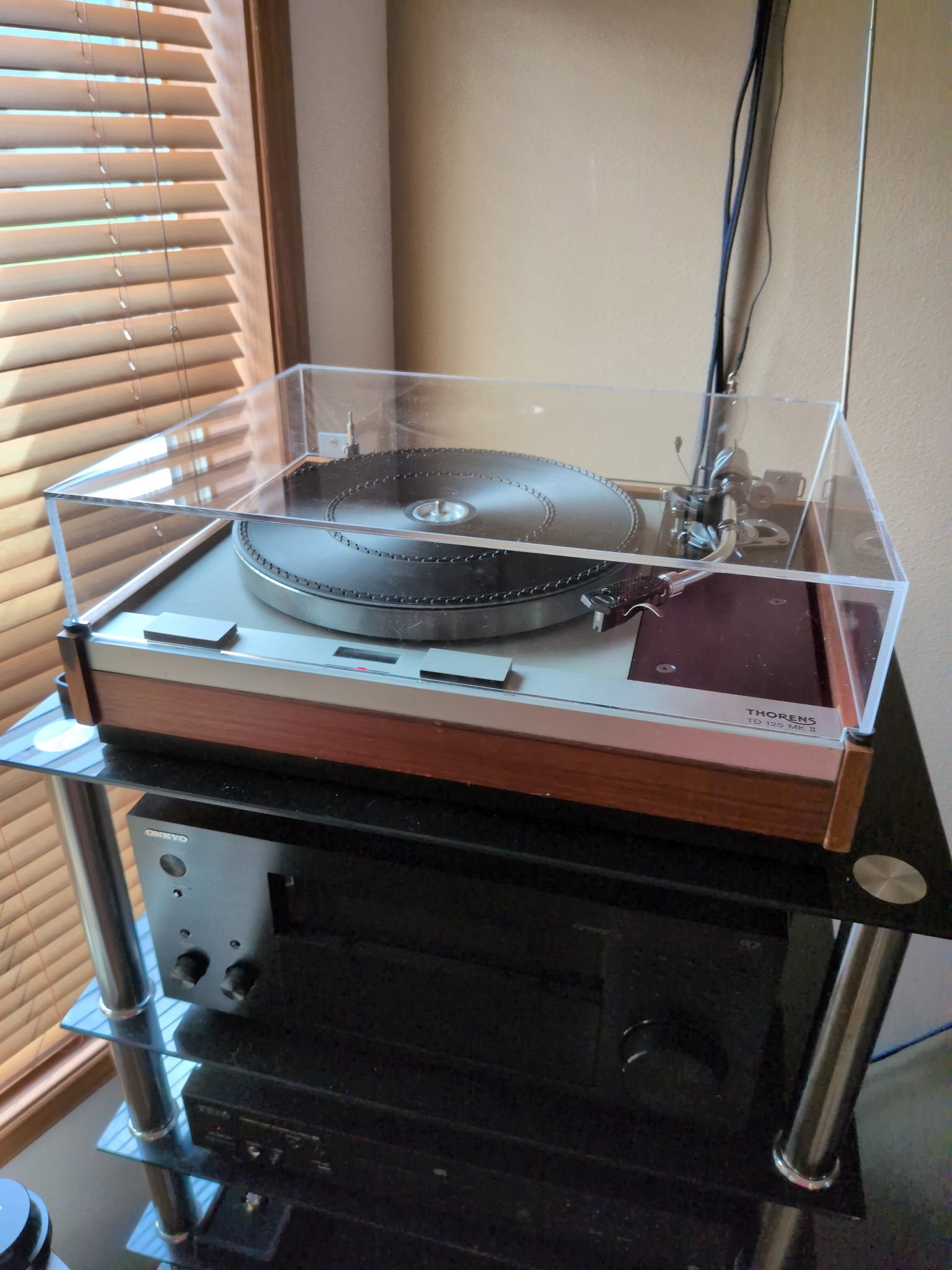

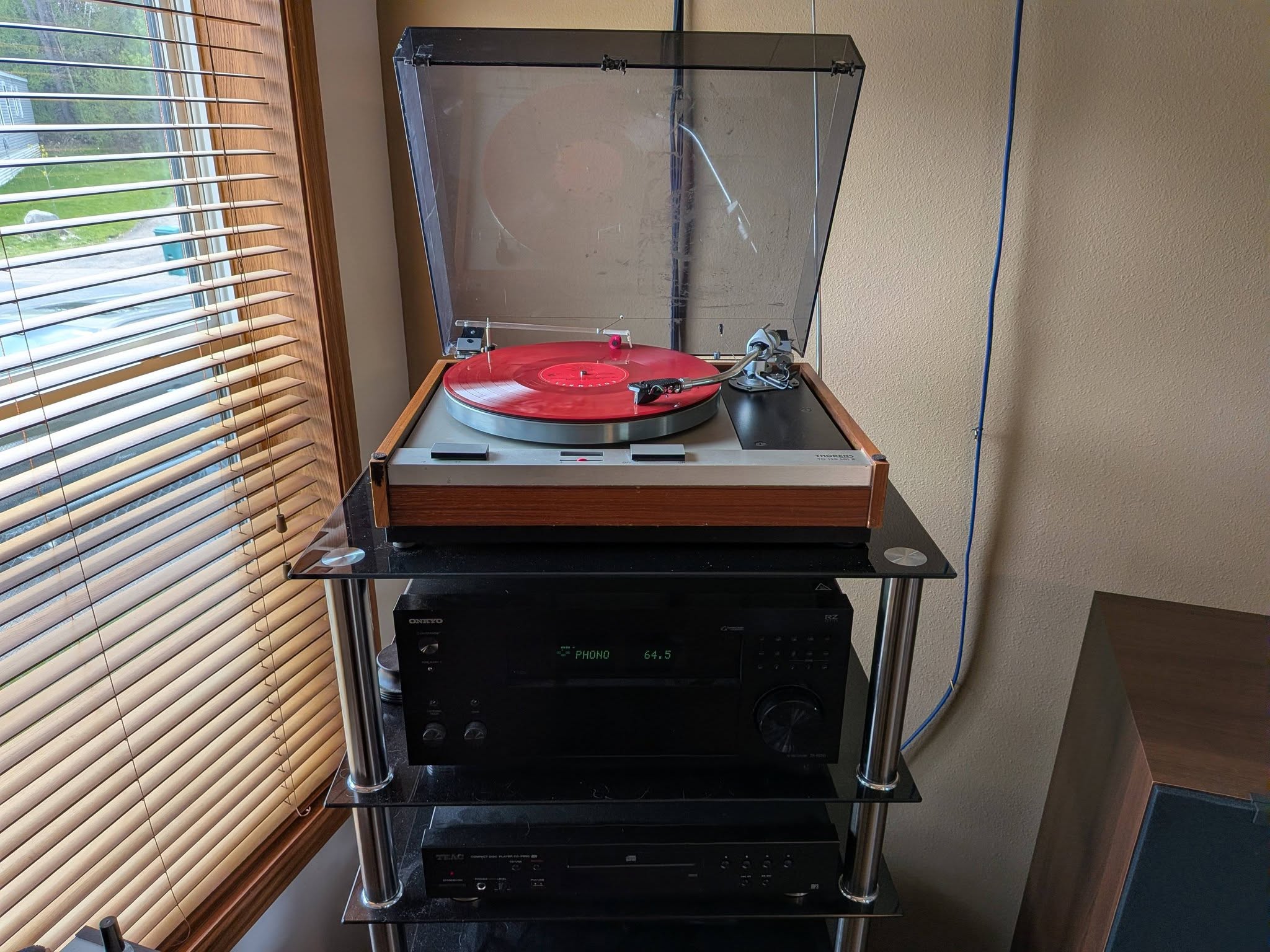

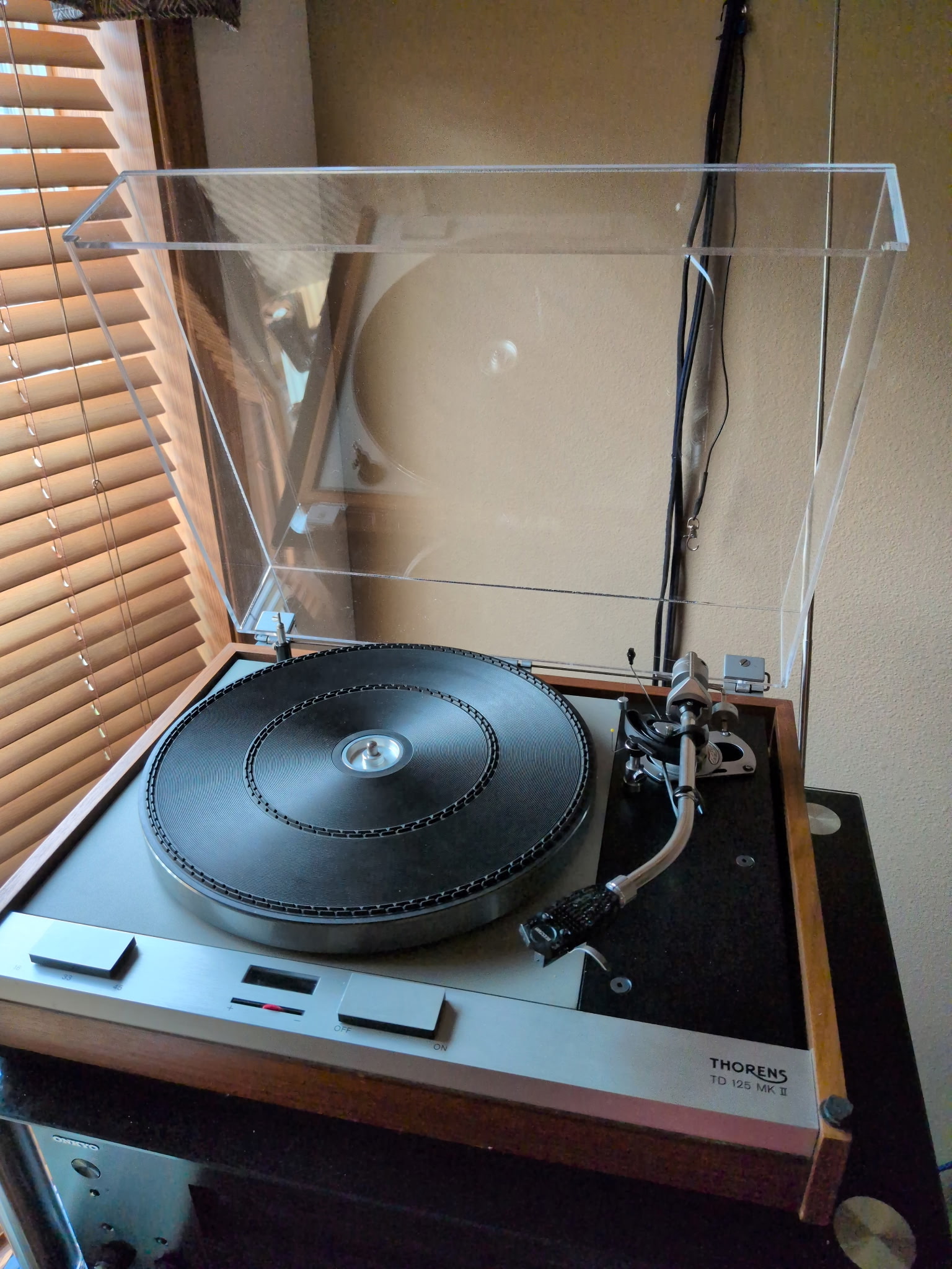

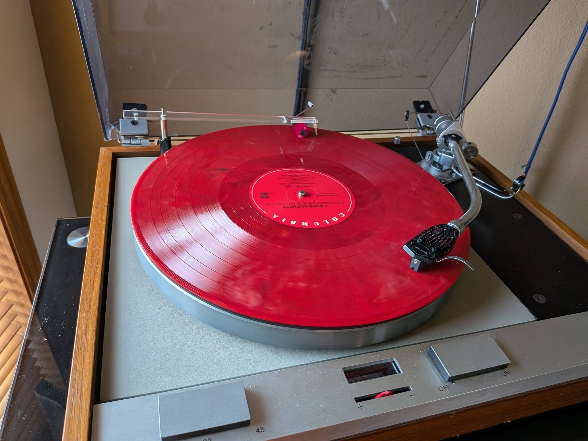

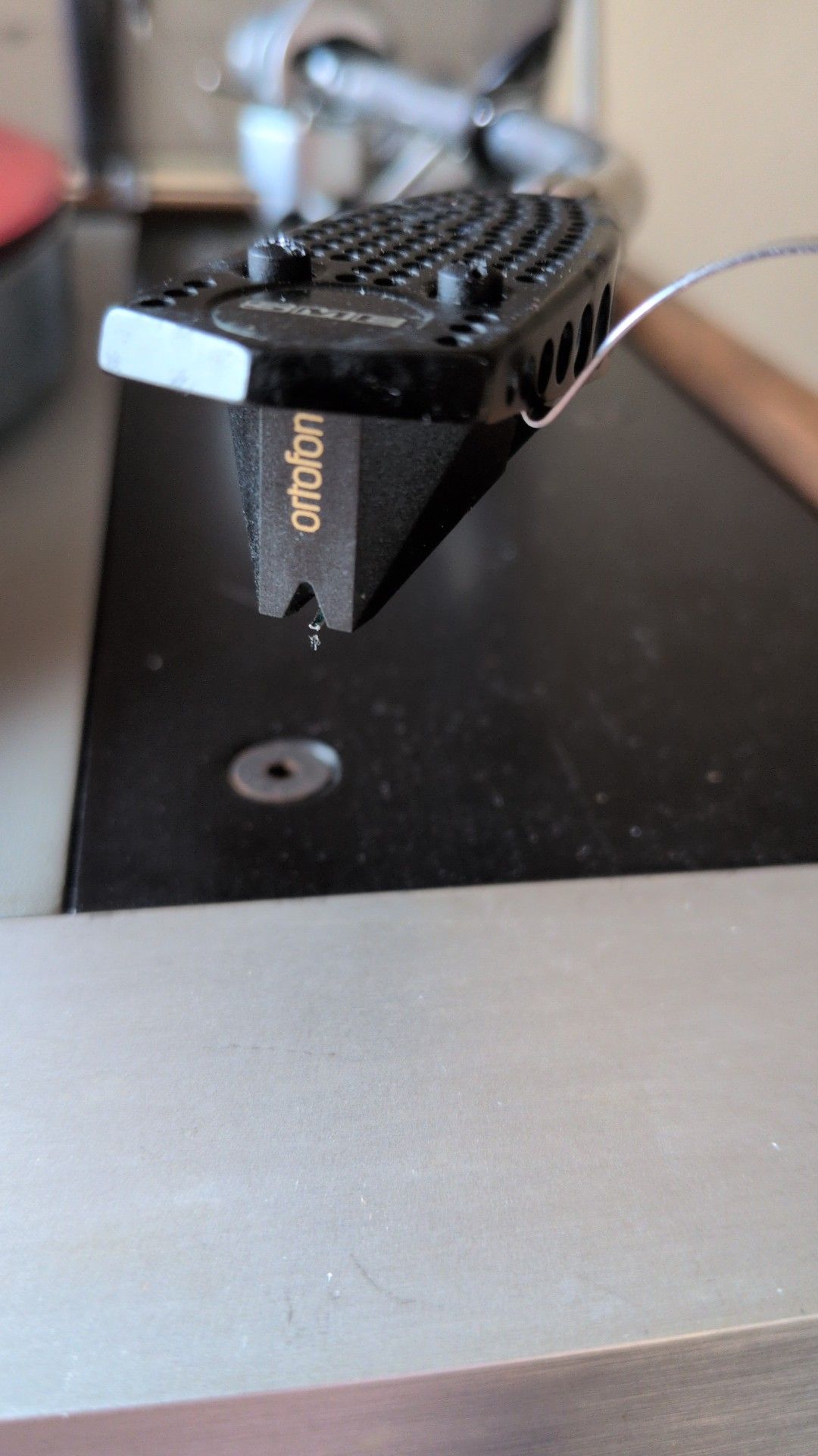

Here's some shots of my new vintage turntable set up at home and I couldn't be happier. It was at @TLS Guy 's place so he could get it up to snuff for me. It needed a new RCA plug and new foot pads. He also put on a brand new Ortofon Black cart onto the SME 3009 Series II tonearm. Mark says the tonearm is in like new condition. Not too shabby. Before I brought it home, we listened to it a bit on his fabulous system. I brought a T-Bone Burnett record over and one track has what I thought was a cello. Well, his speakers are so crystal clear that you could tell it was a stand-up bass played with a bow. It just throws you for a loop what it sounds like in his studio/theater. Bass goes down 20 Hz. and probably lower. And the midrange is so powerful, it just slays you. The instrument separation is quite a thing to hear too. It was quite a treat to hear my turntable on his system. He played it in pure 2 channel obviously.
Much appreciation for TLS Guy for finding this gem and recommending I buy it and then for setting it up!
@Eppie , The suspension is not an issue. I was hoping I didn't have to do what Heisenberg recommended on Breaking Bad to "tread carefully" walking around near the turntable. It's good.

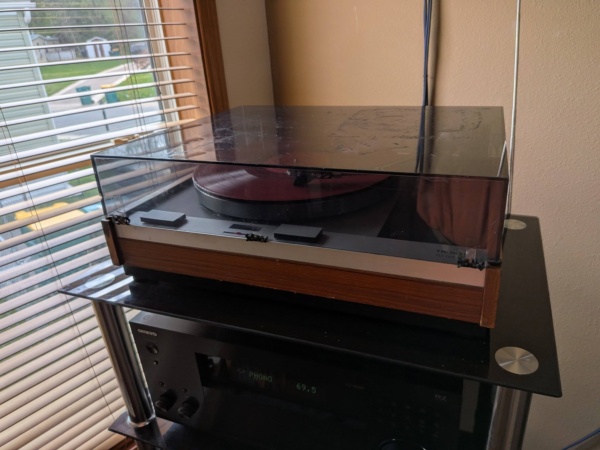

As I mentioned, the cover was a mess, but it was very square. Severely cracked in back at the hinge mounts. I reinforced those areas with plastic and Gorilla glue. Then I drilled in extra holes through the back and the newly added plastic and ran tiny screws with nuts in case the Gorilla glue ever failed. I was happy with how it turned out as the purpose was to tide me over until I felt like plunking down almost $200 for a new one. So I texted photos of it to @TLS Guy. I'd quote him exactly, but suffice it to say, I am forever wounded by his critique! I did get him to admit that it would tide me over effectively. So long story short, I got top dollar selling my Pro-Ject tt, so I used some of that do-re-mi to buy this new cover. I gotta admit that if it wasn't for Mark's critique, I would certainly have lived with that cover for a while, or longer than a while. The new one is fantastic. Heavier gauge plastic too. Scroll down for a couple shots of my "repair".

I am glad to say all ends well. The turntable was not exactly as described. It was not functional on either channel as one side had a lifted ground and the other a short circuit. This was easily corrected. However the main turntable supports were broken and one completely detached. So I had to send for Squish, as that was a four handed job.
Both the turntable and the SME arm are now operating and look in as new condition. The cartridge is the Ortofon black. The damping system and the arm is optimally adjusted for the Ortofon Black. I think the Ortofon Black is now the best cartridge available. There are more expensive ones, but I doubt a better one. The moving coil craze never seems to abate. They have poorer compliance and therefore don't track the heavily modulated passages as well, and also require higher mass arms, which means increased inertia. But of course you can't convince the loony tunes.
So, in my estimation that turntable can play an LP with the greatest fidelity compared to anything available on the market today.
