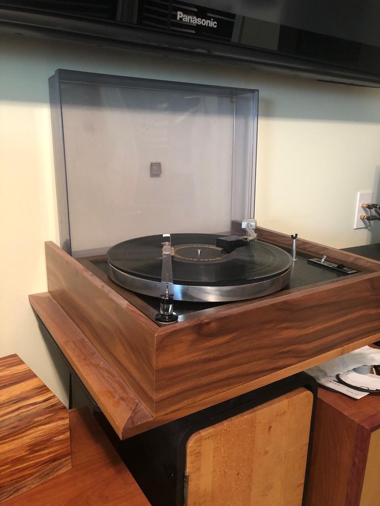

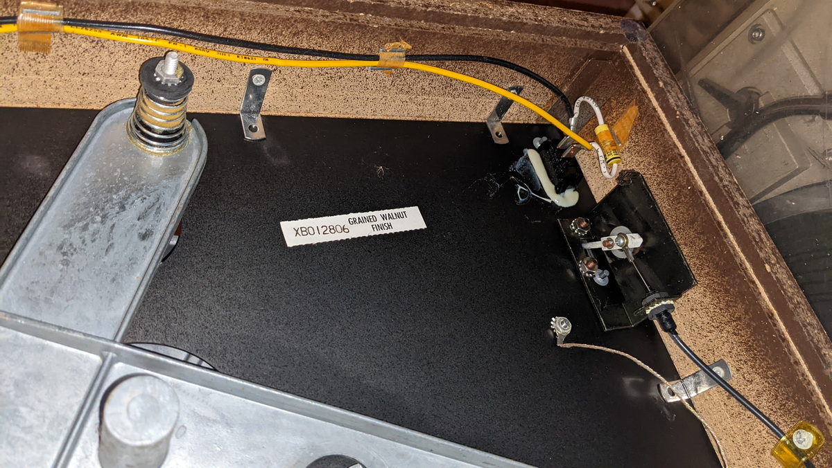

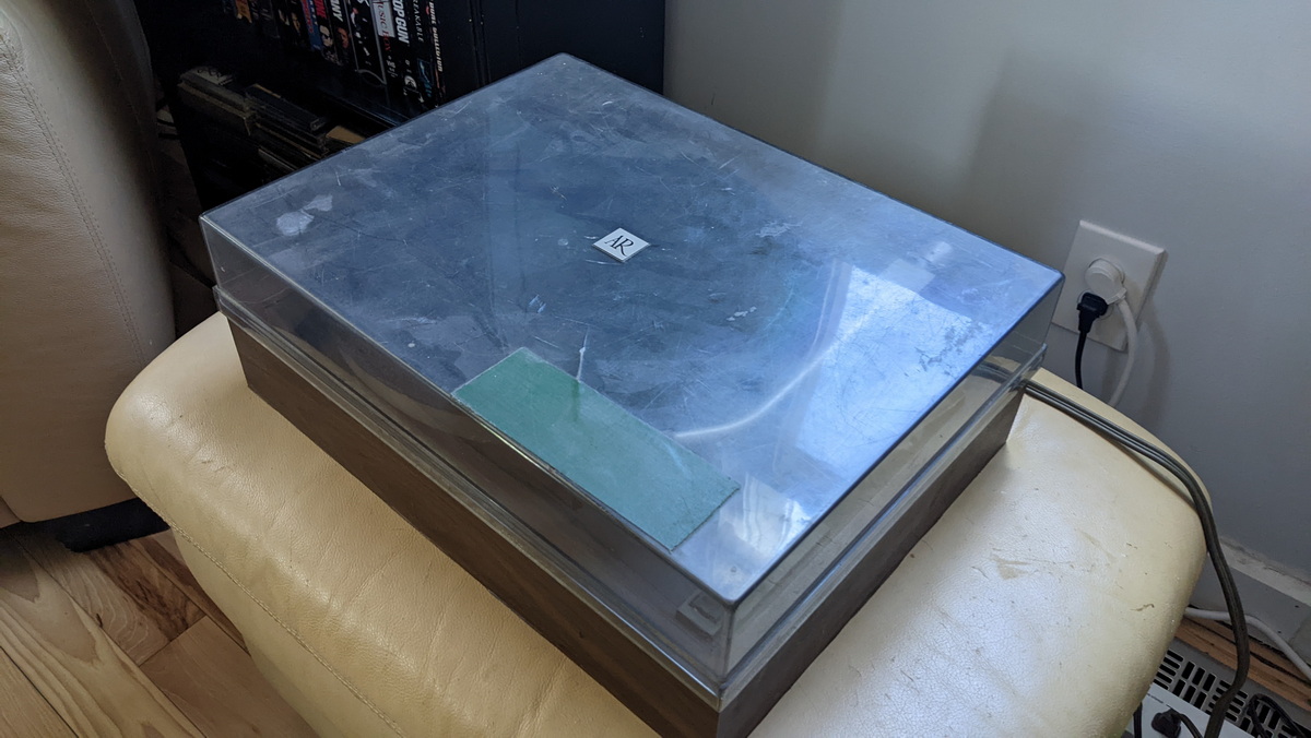

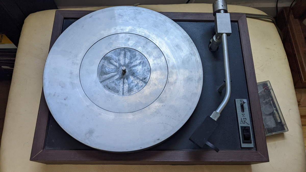

This 1972 vintage Acoustic Research XB turntable has taken up much of my free time for the past few days. It was given to me a few weeks back by a boss who had retired. He said he felt I was the right guy to gift it to. I'm flattered.
The AR XA & XB turntables are regarded as one of the best turntables at any cost, though they were just barely mid-priced at $130 in ''72. My son made a new base of solid poplar with true ebony wood veneer, to replace the low-density plastic-laminated particleboard one. I stripped and repainted the steel top from dingy black crinkle finish to satin "Heritage White" from Krylon. It's striking next to the ebony finish of the new base
I made a new plate of solid aluminum for the on-off switch & cueing lever, with the help of a coworker who got the graphics converted from a photo into Solidworks. I also made a new tip for the cueing lever, a plate for RCA plug connectors so I could get away from the crispy 50yr old integral cable, same by adding an IEC power socket so I can use separate differing length power cords instead of the integral one.
The stock tonearm uses a proprietary plastic headshell which can only accommodate limited cartridge types. I bought a pack of 4 S-shaped arm tubes off eBay, from old Technics turntables. Those use a much more common "SME style" headshell so I can use the same microline and monaural cartridges I've been using with my old Kenwood KD4100 turntable. I had a fellow enthusiast in New Jersey do the arm tube swap for a heavily discounted fee in exchange for the 3 I don't need.
I replaced the smoked dust cover with taped- up cracks and 40yr old green tape for a used but like-new aftermarket one. The new one has the AR logo deep-etched into the inside of the dust cover. Looks nice.
This was definitely worth doing, as it's not only a really good turntable (which holds its own against the $2800 European Audio Team "C-Major" next to it), but it's a piece of home audio history. These are legendary for the value they bring, given that original $130 cost.

Well, thank you! I think we might have to consider this one to be a "resto-mod", like those '60's Chevys that now have coil-over shock suspension and 4-wheel disk brakes. To a degree...it's heritage is still there and VERY recognizable by the suspension action.

Where'd you get the cover?
Got to thank the guy in NJ who worked on the tonearm, he sent me a link to an eBay seller. I think it was a "second" or a return from someone as it was said to be used but appeared to be brand new and the seller seems to be the maker.
