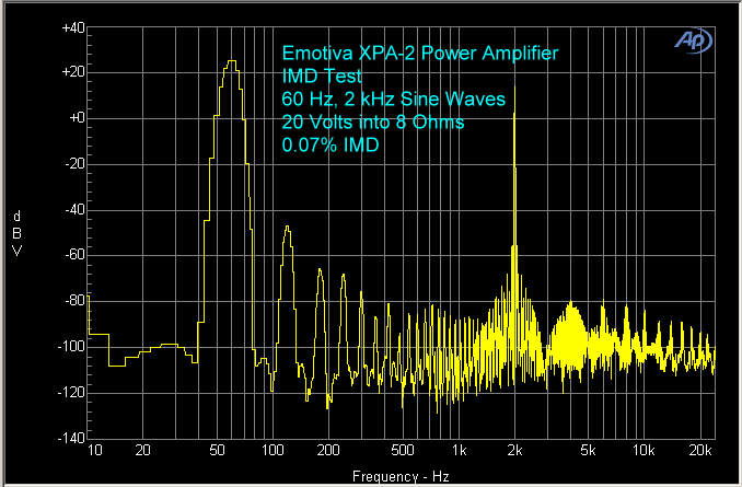

Check out any review on Stereophile, I am not sure what there parameters for their simulated speaker, but almost all show variation; many show +/-.2 dB. That would not be a problem except that is probably not the worst case.
There are also amplifiers that should significant degradation with 2 tones. Is it worse with real music. Most likely, it's not going to be better.

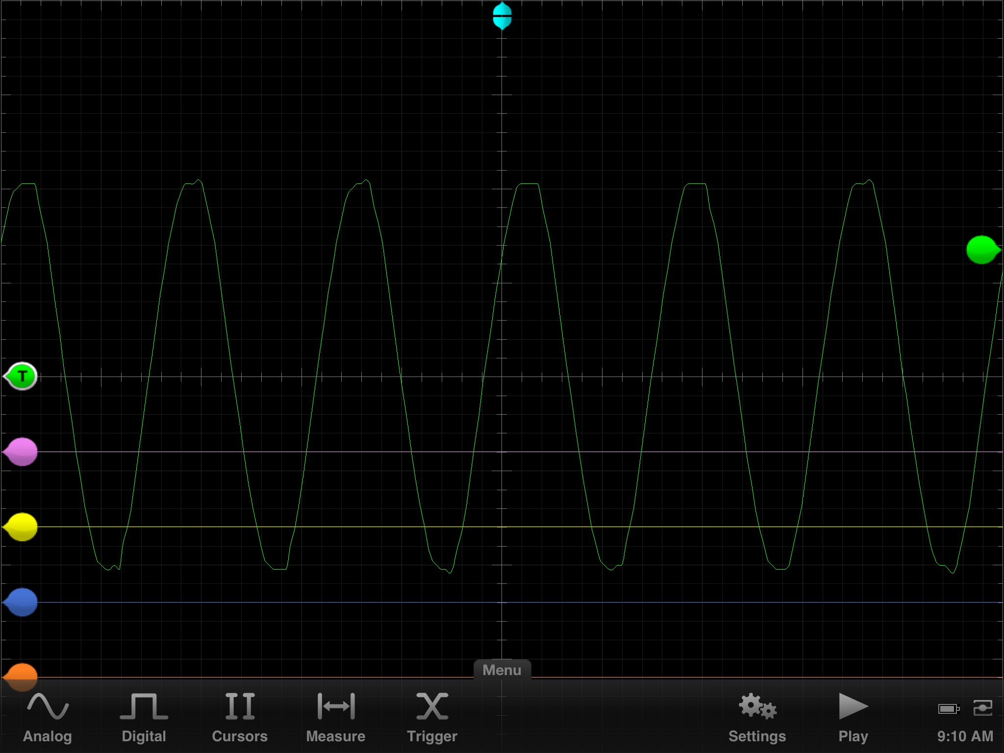

Then there are real-world problem like power. {Perhaps it does not matter. Here is a oscilloscope measurement taken at my HT.
Some AVRs and amps have current limiting and other protection circuitry in the output path. Anything that limits current results in non-linearity.
Has anyone seen these measurements on a AVR?
This is an oscilloscope measurement of the power at my main system. It’s not perfect. This is the stuff found in the wild.
