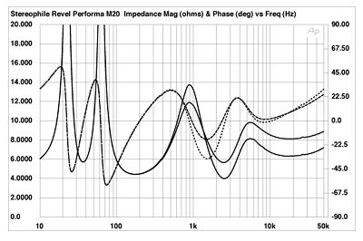

I don't know what speakers you were driving, but could this reasonably account for the difference you heard?
Yes, it could very well be the A820's amp section and I have been careful to point out that this is not an indictment of all AVRs. The Revel M20 bookshelf are not particularly efficient nor easy to drive:
My comparissons were at relatively low voltage which should not have exceeded a couple of watts driving the M20's.

Nothing in the specs indicate that there should be any problem driving the M20s at low to moderate listening levels. I suspect nothing in the A860 specs indicated that AH would measure poor performance.
