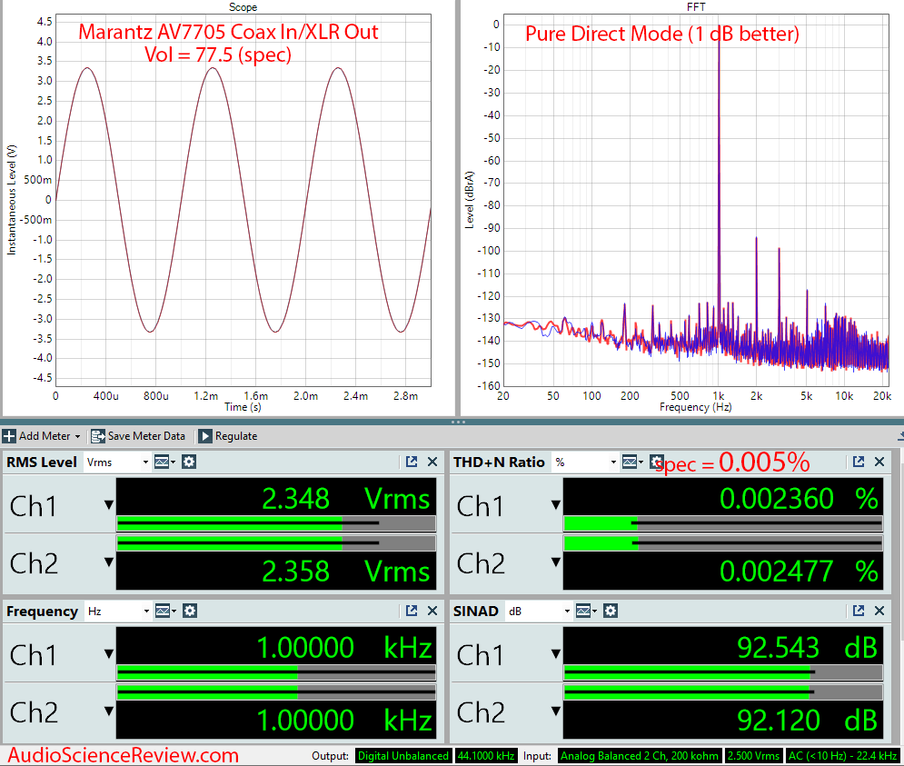

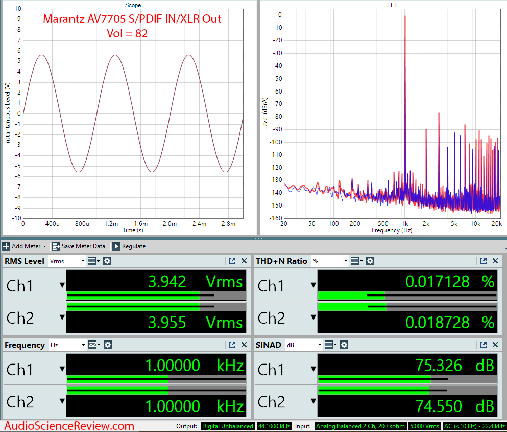

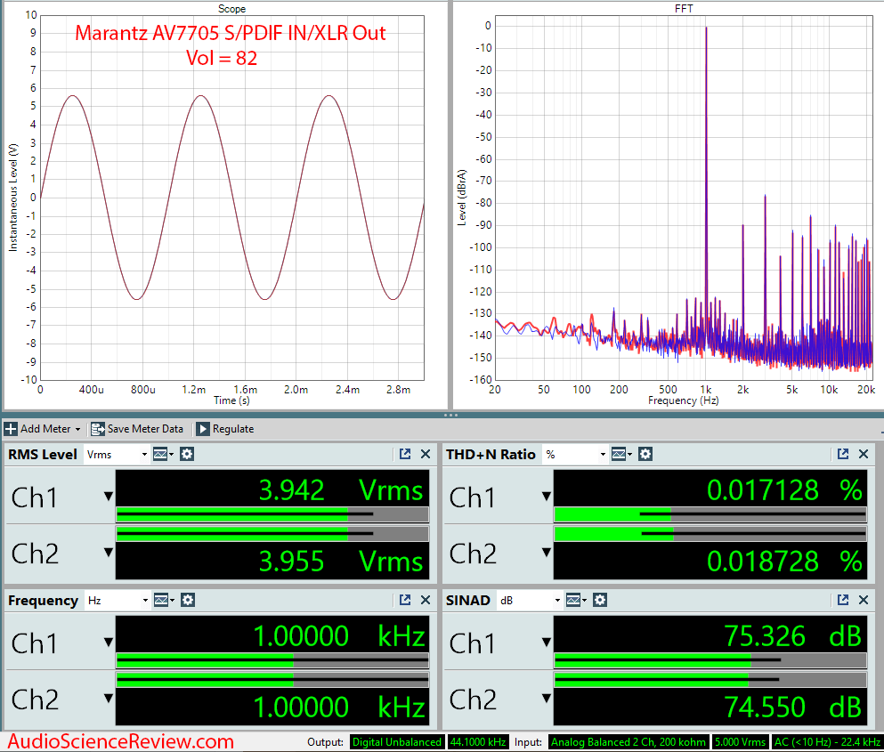

AV7705 pre-out at 4 V, that means 2 V if RCA unbalanced were used:

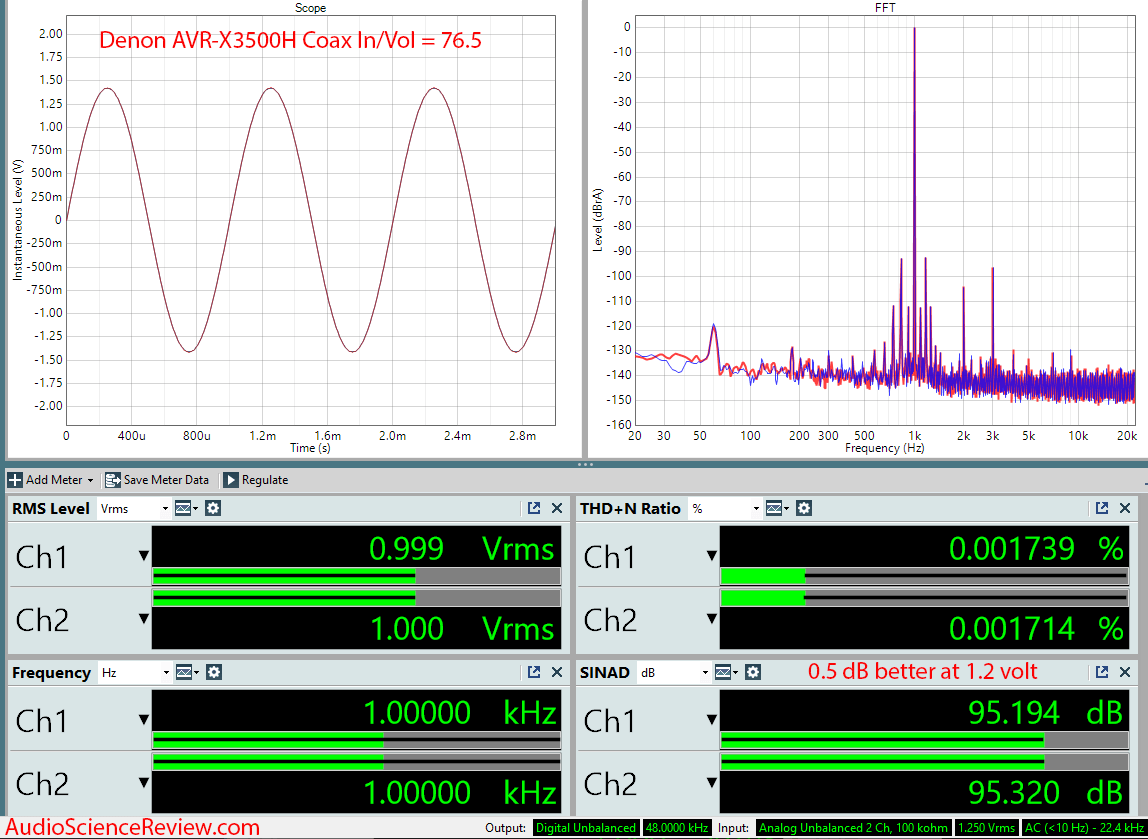

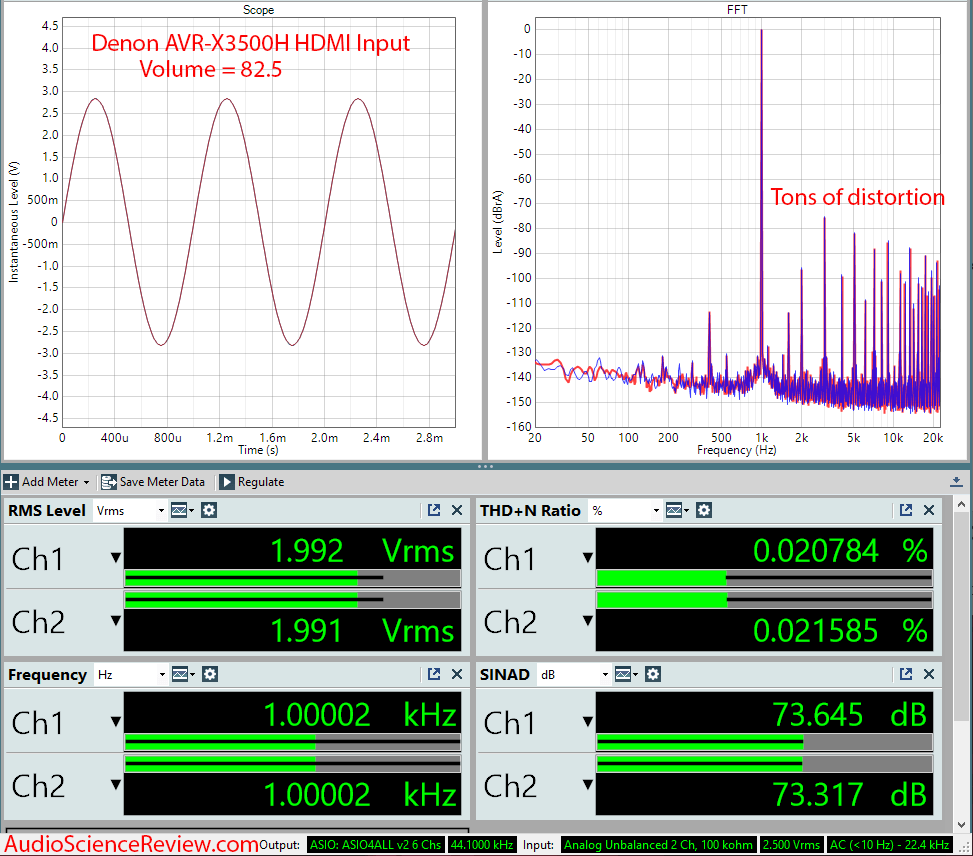

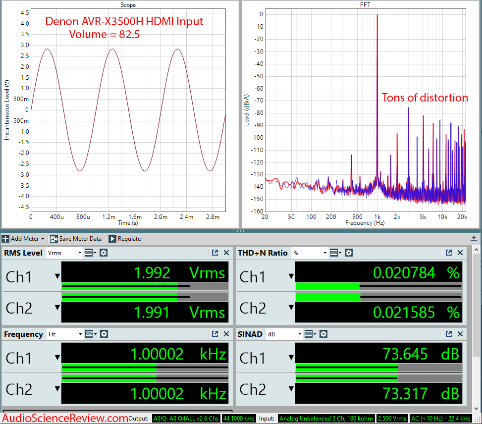

Compared that to the AVR-X3500H:
Again, it was at 2 V unbalanced so it should be compared to the AV7705's 4V balanced/XLR:

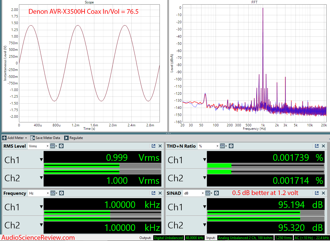

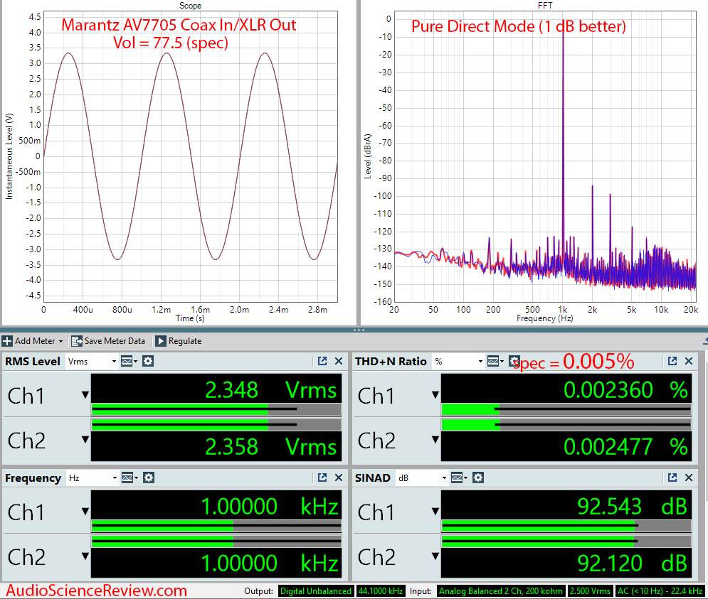

At the rated 1.2 V, things improved for both the AV7705 and AVR-X3500H:
Amir only showed the results for 1 V but he commented that it was the same at 1.2 V
So you can see that at the lower voltage, the AVR-X3500H actually did better than the AV7705.

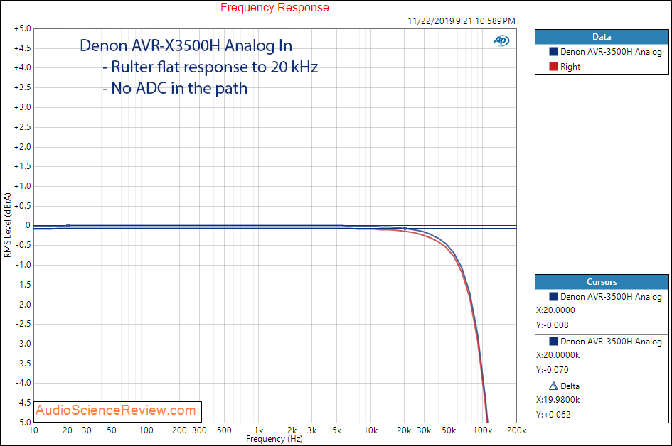

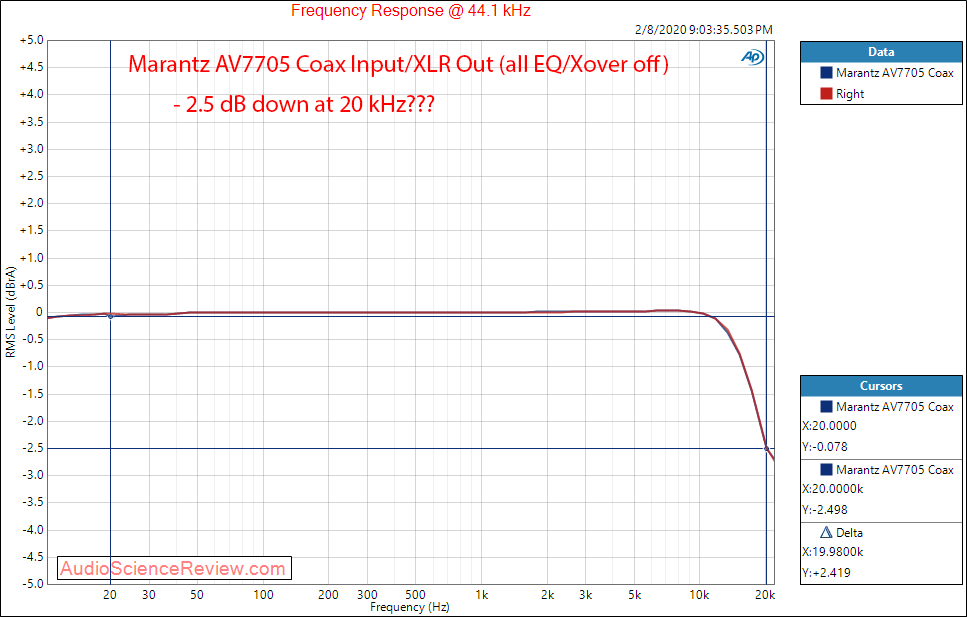

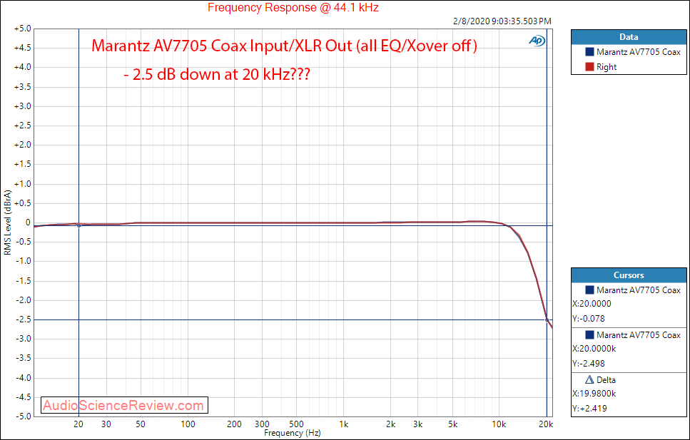

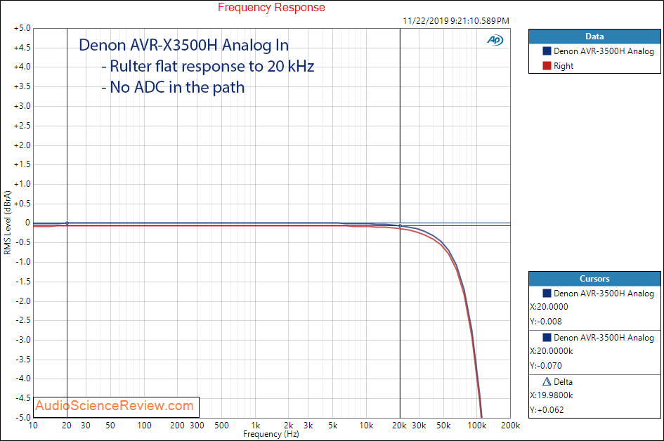

Now, frequency response:
