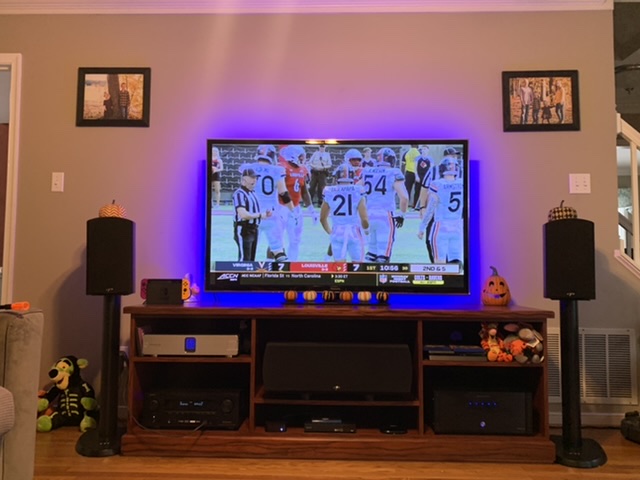

We're just offering some friendly advice to help you get the most out of your investment. That's some serious gear you picked up and great speakers. Your center speaker will match your main speakers better, though, if you can get the tweeters closer to the same height. Ideally you would want the center directly above or below the TV, but if you can't or don't want to wall mount the TV, I would at least move the center up one shelf and if possible angle it upwards to your seating position. The way it is in the photo, as dialogue moves from L to C to R it will likely change in tone because the center's tweeter is aimed at your legs while the mains are at ear level. You might be pleasantly surprised by the difference.
I appreciate your suggestions but unfortunately the BDI media station we have cannot hold a heavy speaker in the middle shelve. I can, however, use a wedge to force the speaker to be a little more angled up. Wife doesn’t want a different media piece either
If those are floating glass shelves I can see that being an issue, especially with the brass clocks on the shelf. We often have to make compromises with our setups. I can't fit large towers in my theatre room because the media centre only leaves about 14" of space on either side. It's Menonite crafted solid maple and my wife wouldn't been keen on a different piece either. :)
Try switching between phantom mode and your center channel. I'll bet phantom is an improvement. I know it's not always possible, but ideally your tweets should all be roughly ear height and all on the same plane. If your only choice is to hamstring a speaker with rough placement like that you could be better off just not having one. If you can't, or are unwilling to optimize speaker placement then phantom mode might actually be the better choice for better sound quality in this instance.

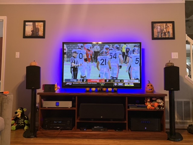

Best we could do moved shelf
That is totally an improvement...now just try and aim the speaker at ear level by tilting the front of the speaker up. ENJOY!
It's still an improvement. :) Hope you're enjoying the new system.
What is the possibility of wall mounting the TV? If you put the TV a bit higher and wall mount, you could put the speaker on top. You might even be able to fit your Anthem stuff in the shelves and give you more room to move your speakers further apart. (not sure about window)
The Anthem gear will be HEAVY and likely not work on a glass shelf.
I think I mentioned wall mounting the TV earlier but got the impression that this was not something the op was considering. He mentioned that replacing the glass shelves was not an option, so this may be the best compromise.
