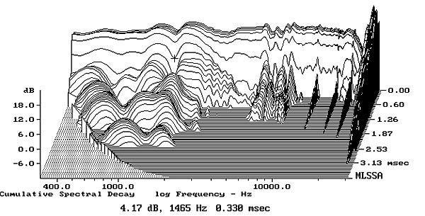

I also find it hard to believe that this speaker for example,
wouldn't be improved by a cheap LCR filter on the 8" aluminum cone. But if that's what that company's testing shows.. maybe some "human" decision making isn't a bad idea. Is the extra cost really that harmful? Maybe you agree with the KEF side of things with your experiences, or maybe you don't based onyour knowledge... all I know is that a (maybe naive) human being's reaction to that graph will differ from an accountant-with-research.
