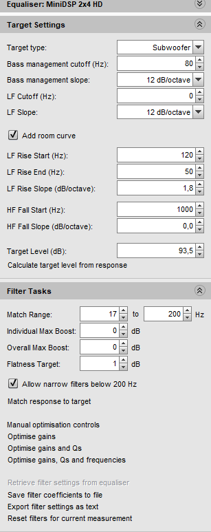

I'm trying to see the result that would have been using minidsp, I got + - at this point, of course I don't know if I set the right parameters for sb 3000.

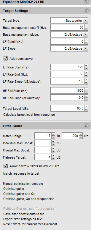

I do not have. But it is possible to simulate with rew an eq from a measurement.
As I am not xpert so I asked if this result would be worth only.

Please could you just give me one more hint as to what values I should put in these parameters ?
80hz Book Crossover, LFE 120hz Channel, SB 3000 x2 Sealed Subwoofer
I'm not even sure why you're using this part of REW let alone tell you what to input to it.
Need to use this part of REW for create a EQ from a Average Responde of your seats and import to minidsp.

Dont have, but want learn for more later buy one.

Are they at least measurements you've taken with a measurement mic?
Here’s a good read for you. Basically gives instructions on importing rew calculated filters into minidsp.
