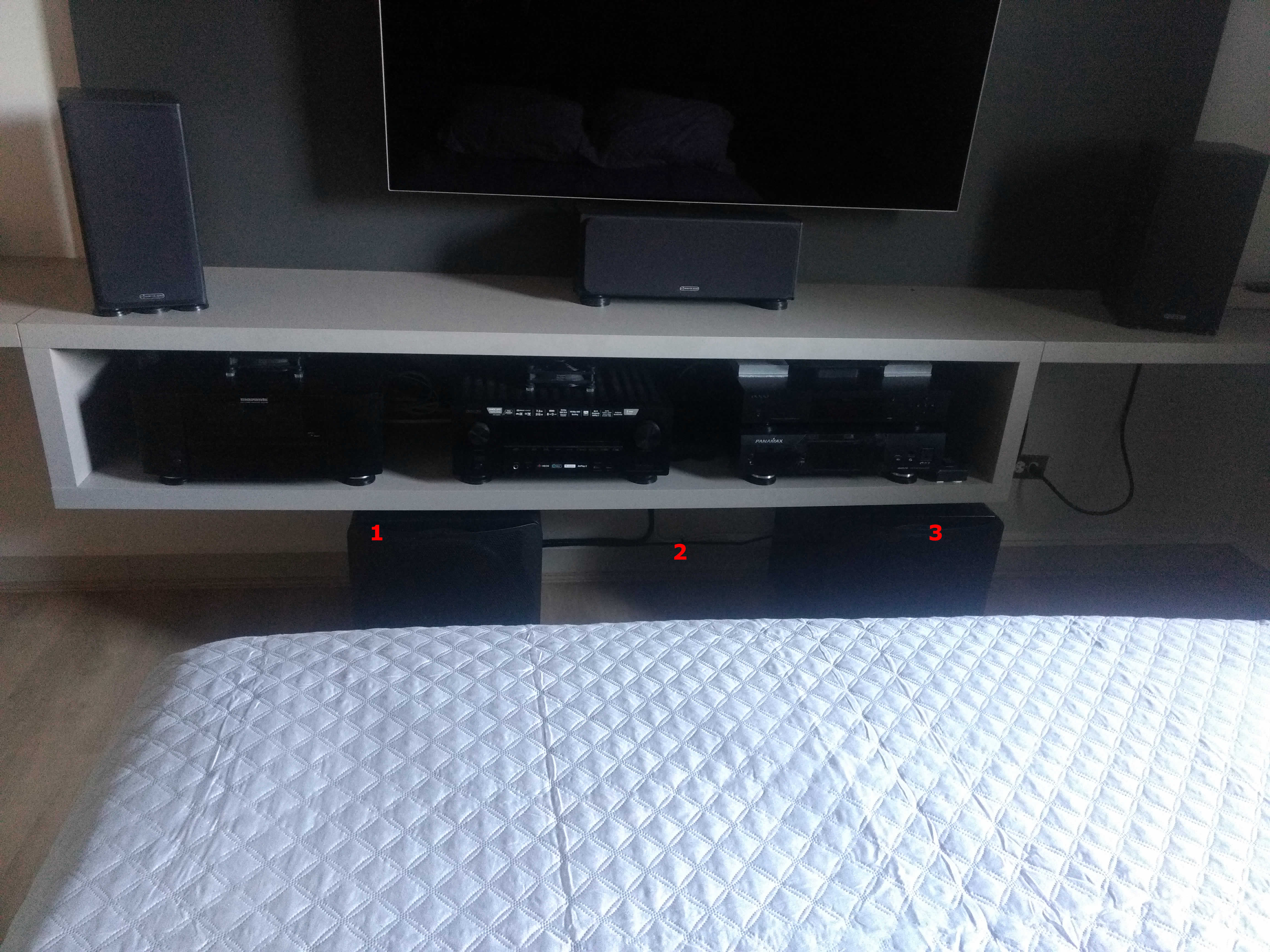

My bedroom have arround 1000 cubic feet, and I am an enthusiast.
I felt a lot more dynamic, more "power" seems to me that the low frequencies have an upgrade, so I'm thinking of maybe putting one more sub in this position:
Of course it is not the ideal position, my room is small, my options are only at the front, so I ask you, will I have more benefits like what I had going from 1 to 2?
I Will have cancelations because they are Very close ?

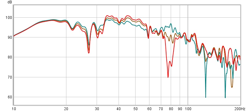

Approximate measurements ( I didn't get to measure the maximum power where the compression starts, I put a random volume ) at 3 places of listening position (My bed) with 2 SB 3000
Crossover 80hz and lfe 120
Something not right there, even with no smoothing, it should be much flatter with XO 80 Hz unless you have a really challenging room.
I have one seat hard to flat ( red ) more leaning against the wall and window, becausbeit is a room with a bed against the wall, wardrobe ...
The others 2 positions are more flat than this.

Anyway, what do you think of the idea of a third sub in the middle in my case?

For 1000 cu ft even one SB3000 should be plenty!!
If those curves are for the subwoofer only, they don't look too bad. If they are with the L+R, then I expect much better response >100 Hz. You likely can improve much more simply by "crawling" the subs, try moving the one facing the bed to the left of the other sub first and see what happens.
I've tried to move them, tried different ways but the best I had was in this current position. Perhaps the biggest problem is that I am only limited to spread out front.
Yes was measured with L + R bookshelf.
The impact I had from 1 to 2 was huge z my idea is that with 3 even is practically together would be equally beneficial or i will have cancelations?

That's a pretty small room so I can appreciate you have limited sub placement options....never tried three across the front myself. In a similarly sized bedroom I find two up front work well enough for me (and would have to go under the bed/headboard for a third which someday I may do when I get a bit more enthusiastic :) ). One way to find out if another helps :)
