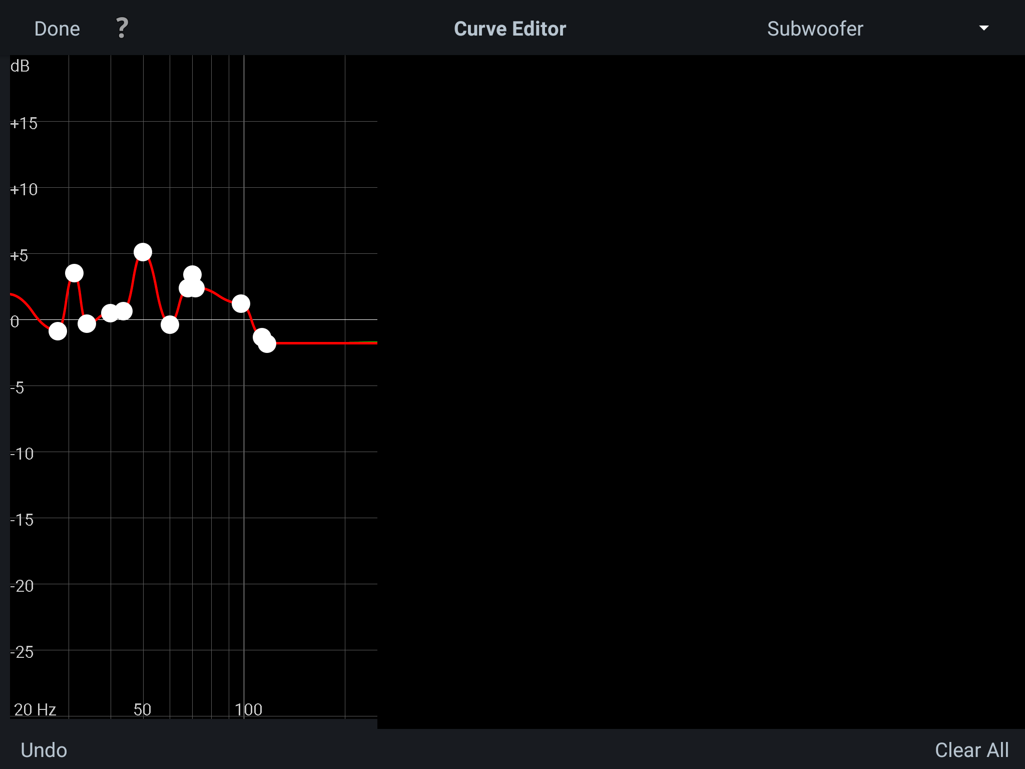

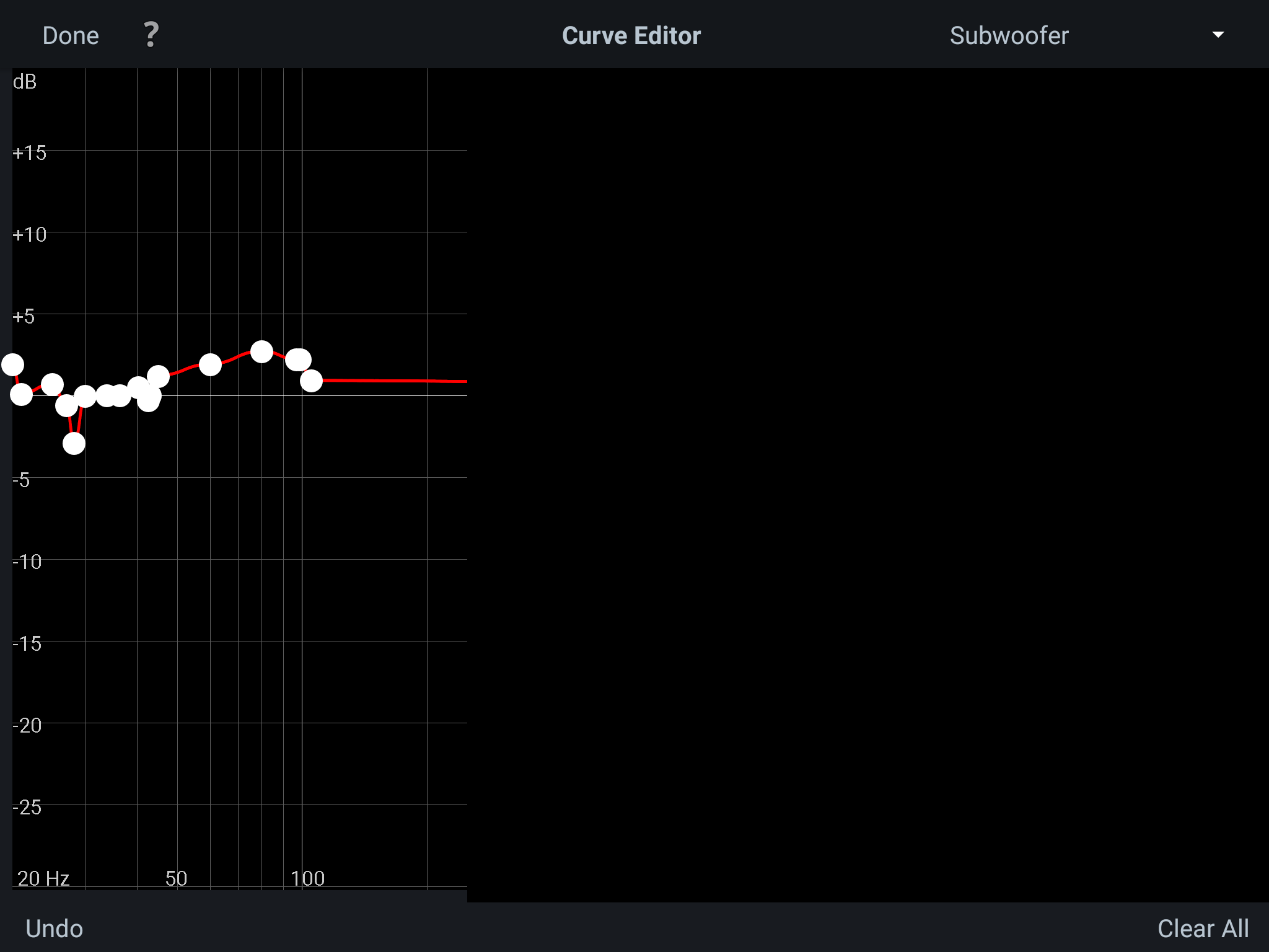

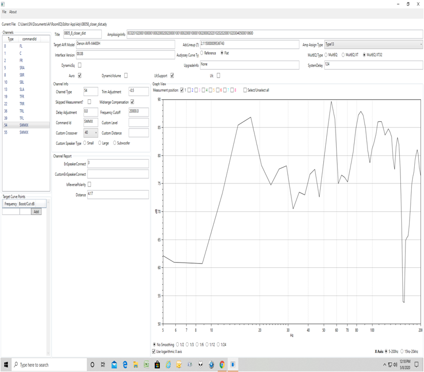

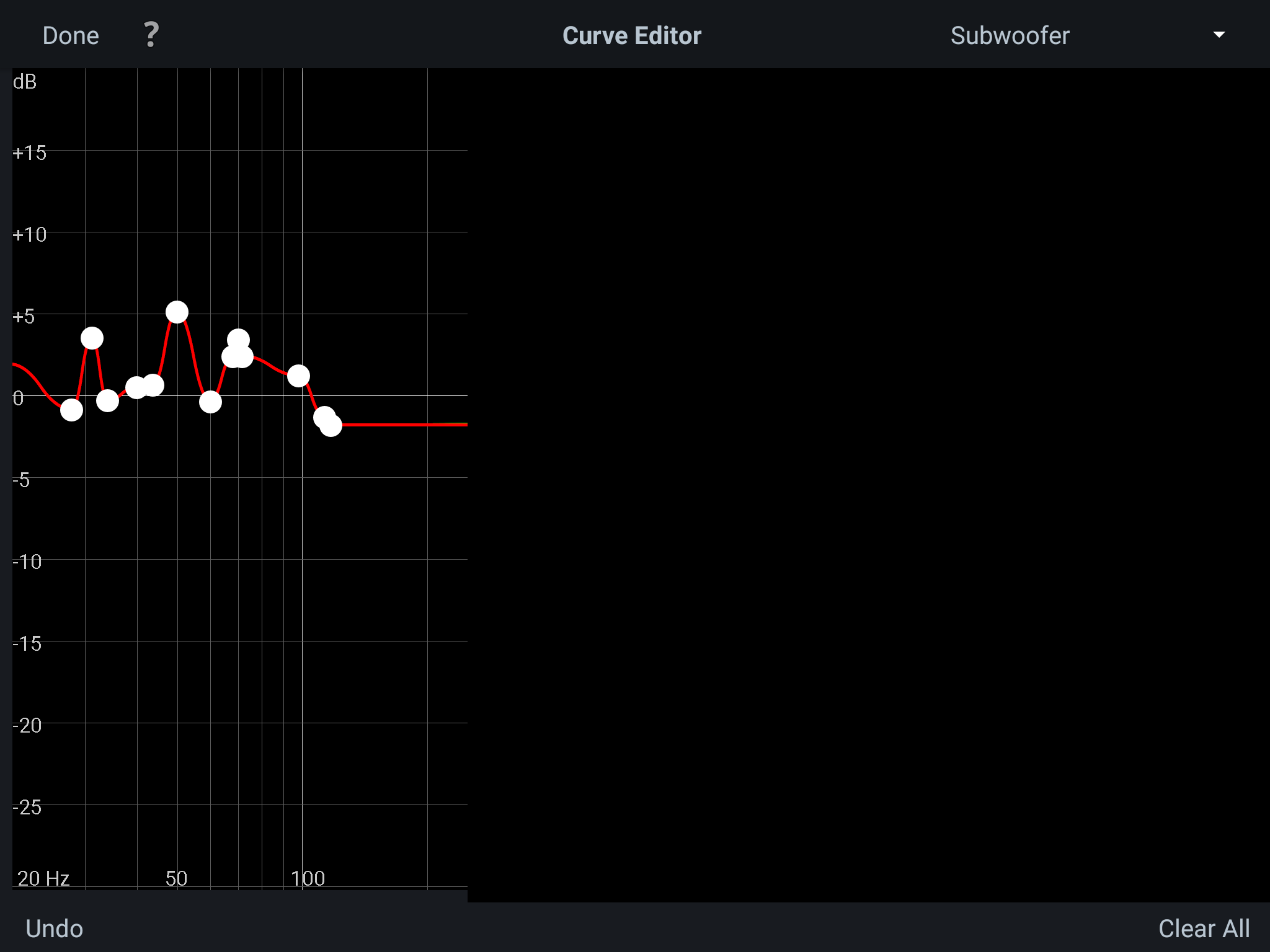

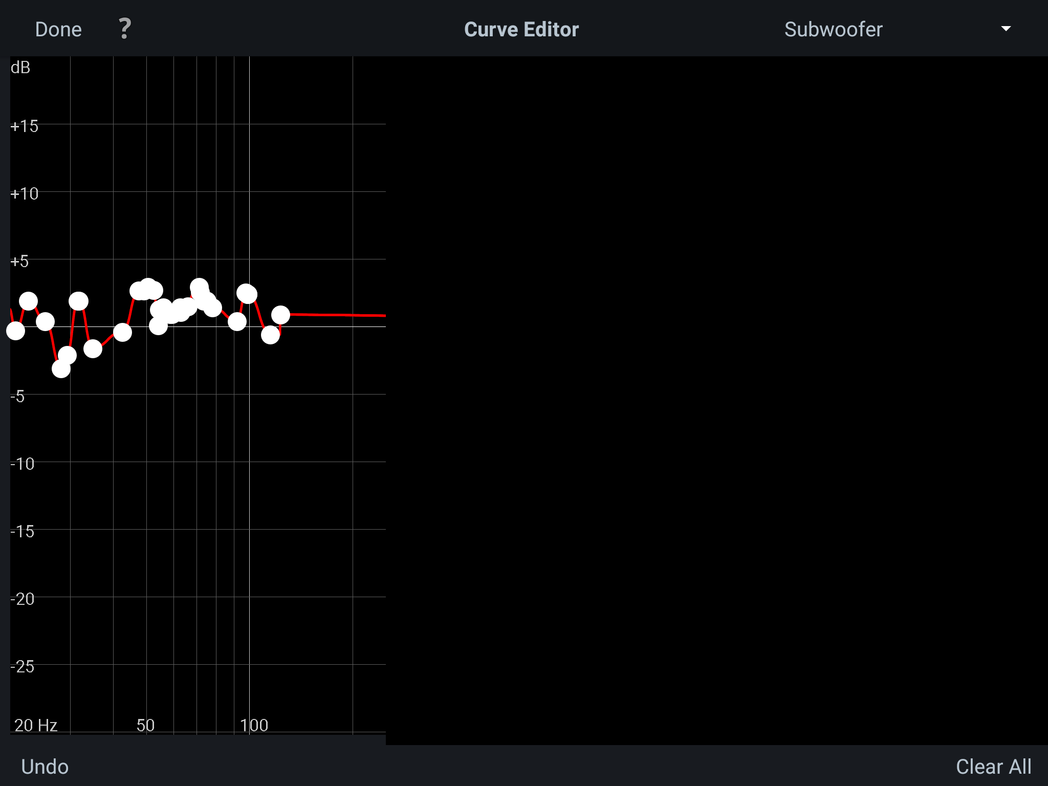

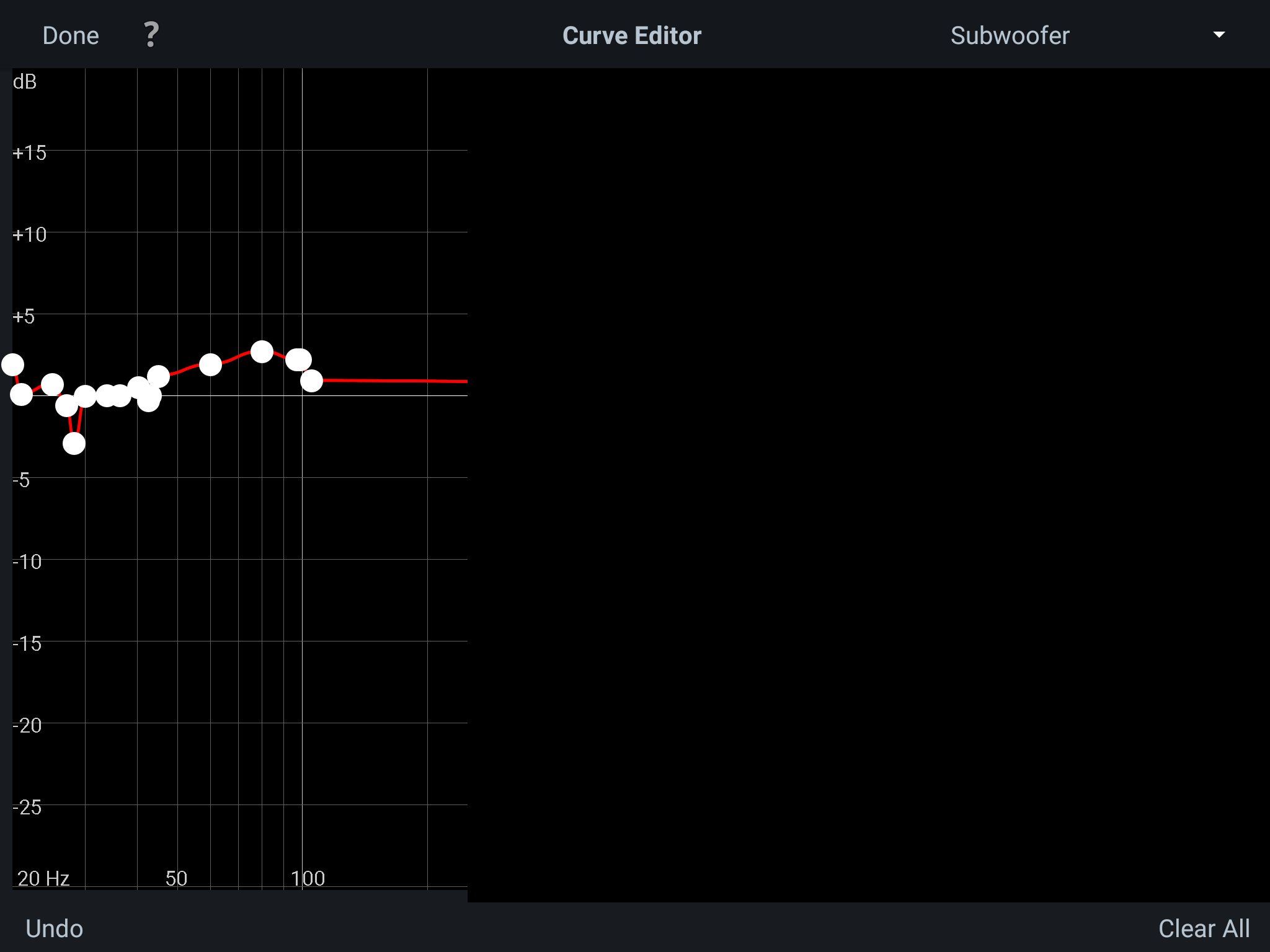

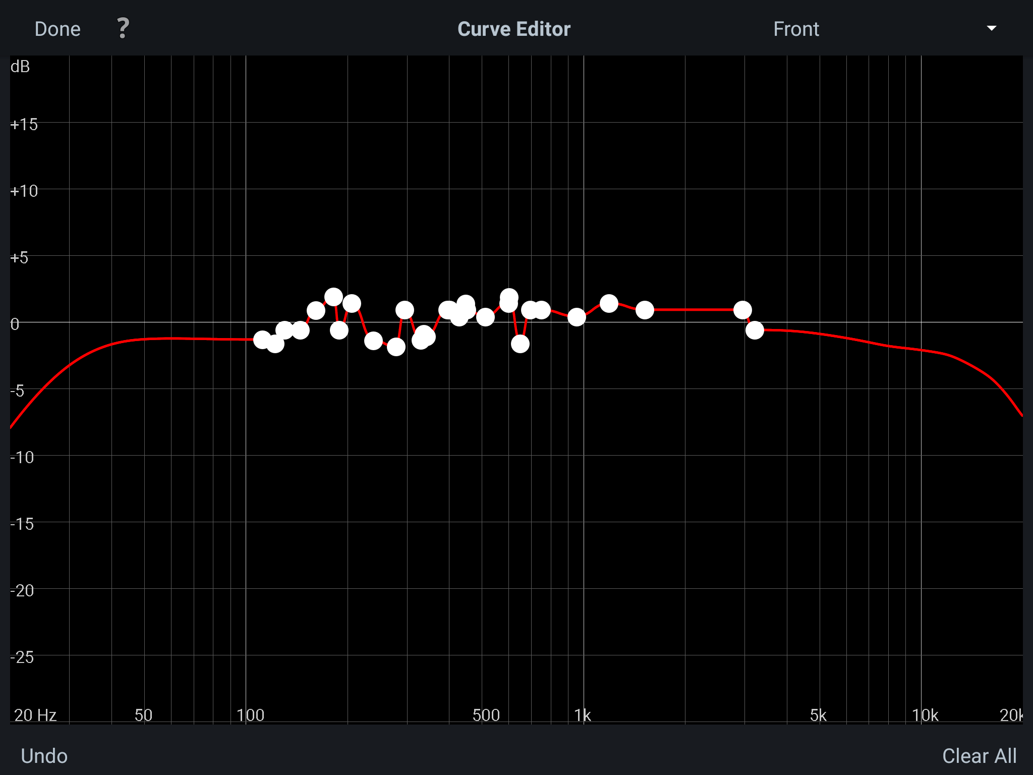

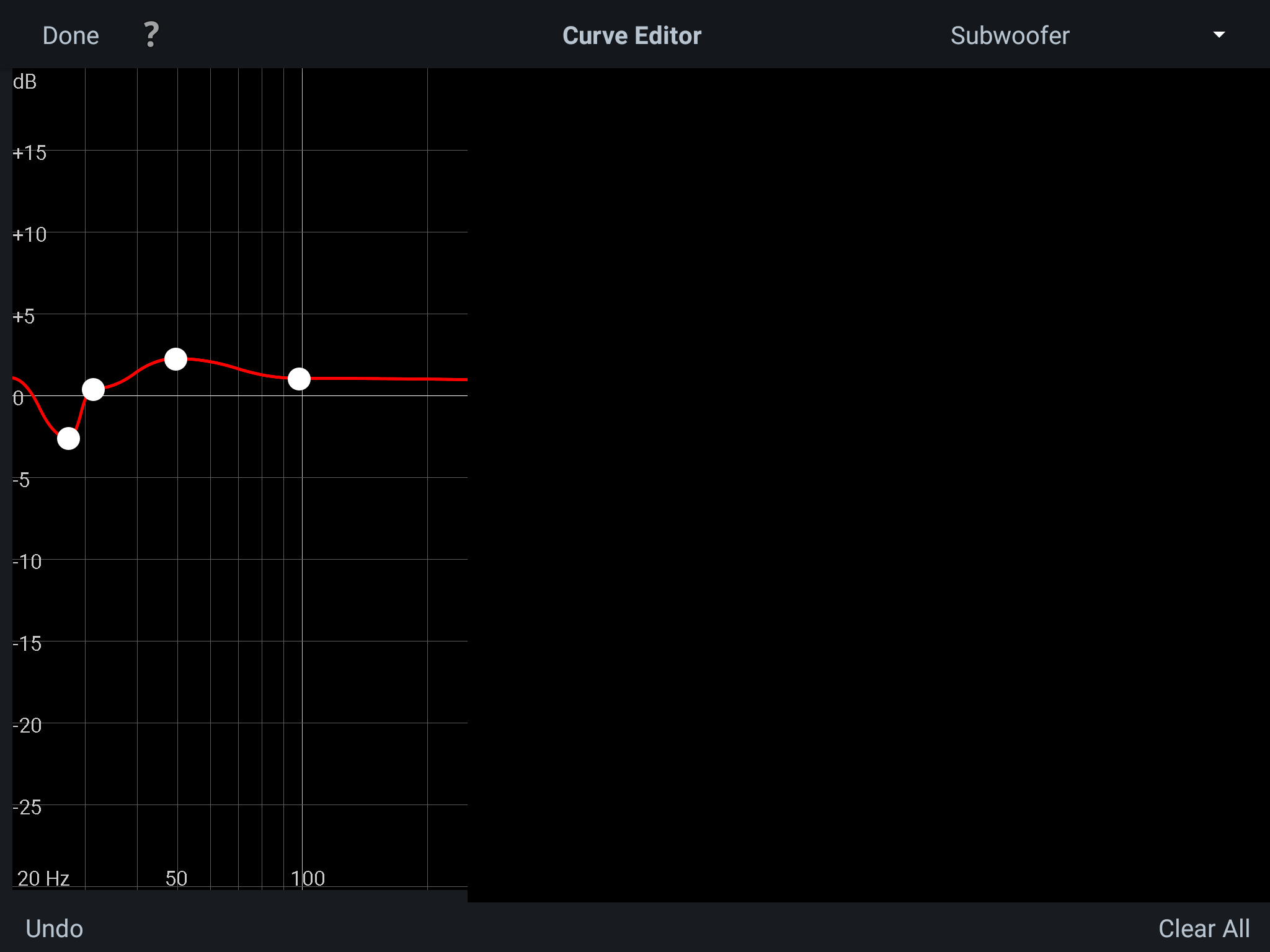

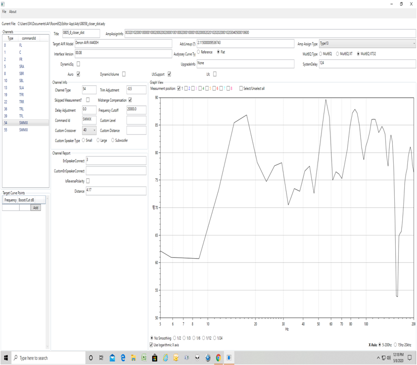

I spent a full day yesterday to play with the Editor App and REW, the best curves obtained within a bubble of 8 to 12 inches at the MMP, left, right, above and below were surprisingly good. I know it is academic, whether the FR from 15 to 200 Hz is within +/- 1.5 dB or +/- 3.5 dB with 1/12 smoothing is not audibly different to me. It just shows the App does work well if you take the time, and use the Ratbuddyssey UI.
@Pogre , having seen your graphs, I am quite sure you can do the same or better than me without the miniDSP. If you can spend one to two days on it, you will end up having the mini for sale and spend the money on stead and beer.
Will post some screen shots of the target curves later, time permitting.
