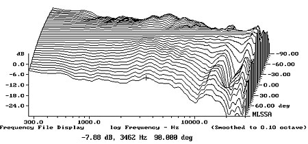

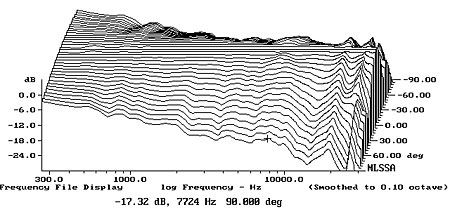

A point source should have smoothly and progressively declining frequency response as one moves off-axis. (A line source should have the same, in the direction normal to the line.)
"Midrange mushroom cloud" is my term for an excess of midrange energy thrown out into the room by the loudspeaker, due to incompetent loudspeaker design and/or parts selection.
A a competently-designed speaker does not exhibit the midrange mushroom cloud:
KEF Ref 201/2
But an incompetently-designed one does.
Usher Tiny Dancer
(Both from Stereophile)
(Incidentally, I picked the Tiny Dancer for this illustration because of what I heard during a blind test that had these in with some competently-designed speakers.
