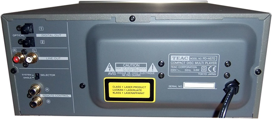

I've found a PD-H570 - seller says Err shows and thinks CD is stuck inside
Two questions for the gurus here:
Does this item have the same PSU?
I would like to have the multi CD capacity - is this broken unit likely to be an economical fix?

You might get lucky and find out there's just a jam from improper use with the carrier, but other than that, not economical. They do not appear same PSU based on wattage. The PD-H570 has slightly higher power consumption. I had to scour google images and could only find Japanese models for the example. This does not necessarily mean the PSU is not the same, in fact it's highly possible they are the same, just so happens when they tested the units the PD-H570 had a slightly higher power consumption, probably due to the tray carrier mechanism.
PD-H500
PD-H570
