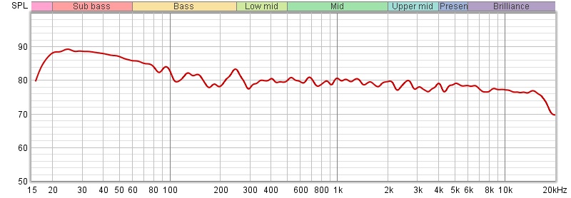

I'll have to check that out. I thought about getting a MiniDSP 2x4 HD a while back but, I was able to get my response pretty flat so I kyboshed the idea to put the funds elsewhere. Here is my response a while back. I still have work to do in the higher bass but, from 20-100hz I don't think I could get it much better. This is in an absolutely horrible room acoustically too and I will be buying a new house soon with a better room to work with...

Your frequency response is very good, and it is impressive that you are able to do that with just two subs. I really liked the Defiance X12s, they were great mid-bass performers with some good output below 30 Hz. They were a lot more comfortable above 25Hz. You ought to be looking at subs with strong performance in the 16-32Hz range for a real difference in your next sub upgrade.

Yeah, I am pretty happy with them I will just need more jam when I get my new place with a larger room and a lot more power below 25hz and above too. Here is the best I could do a while back(1/6th smoothing) but, I have added a bunch of treatment and am doing a full ground up calibration again once I install the new heights...
