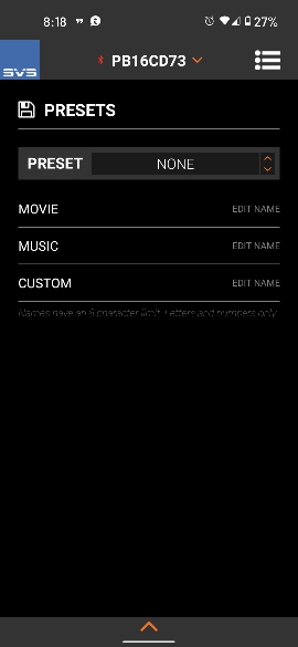

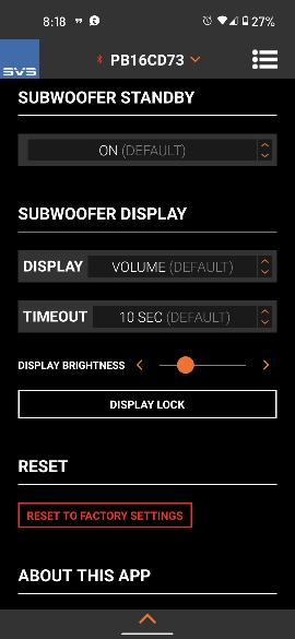

Bought new from their outlet. I can share all the screen settings from the app if that would be helpful to find the issue.
Sent from my Pixel 4a (5G) using Tapatalk
Here are the app settings of that helps
