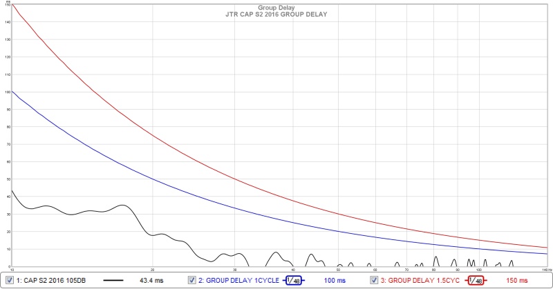

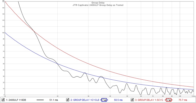

Here is a group delay measurement of the JTR Cap S2:

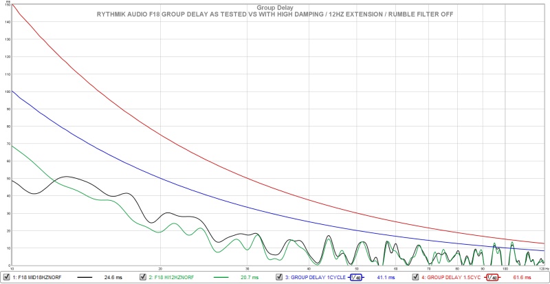

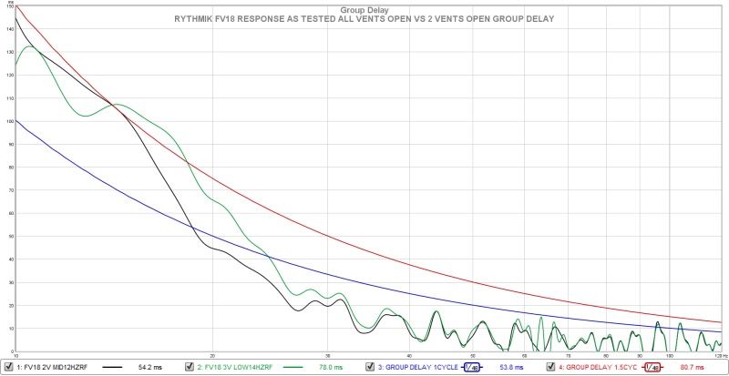

And here is a group delay measurement of the Rythmik F18:
The Rythmik sub has about double the level of stored energy throughout most of the subwoofer range. Don't fall for marketing hype.
What is more, the new JTR driver is supposedly a higher-fidelity one than what is used for that above measurement.

If Rythmiks had less ringing, it would be evident in group delay graphs, but they just don't have any advantage:
vs.
Those are the group delay graphs of the subs under discussion, and they are basically the same.
Contrary to your claims, the data says that the FV18 just isn't quite on the same level as the Captivator 2400ULF, in pretty much every metric. Nor should it expected to be, since it costs $1k less.
